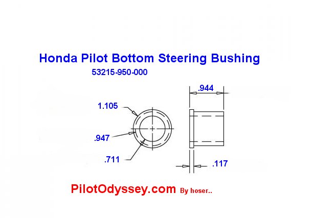

I think stock for the fl350 is 22mm long 18mm id 24mm od with a 27mm od x 3mm flange
McMaster Carr has one close but the flange od is 30mm instead of 27mm
6659K39 Metric SAE 841 Bronze Flanged Sleeve Bearing for 18 mm Shaft Diameter, 24 mm OD, 22 mm Length
http://www.mcmaster.com/#catalog/118/1128/=h7dcsc" .".." ."..
here is my print for the fl350
is the fl400 the same ?

I have a new OEM Pilot bushing in my spare parts box I will measure it up and post later.
Fl400 & Fl350 steering bushing Print 53215-950-000 viewtopic.php?f=35&t=9975&start=0

http://www.pilotodyssey.com/steeringbushing.htm
