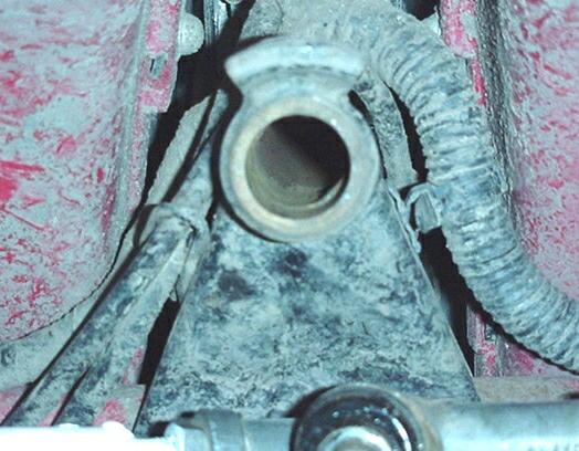

When I was cleaning and greasing my A-arm bushings I also noticed that the bushing at the bottom of the steering stem was loose and worn after removing steering yoke and tie rods a gentle tap of a rubber mallet was all that was needed to remove the shaft. Ubove you can see the bushing after the steering stem has been removed To remove the bushing I used a 1/2" rod 30" long and a hammer to remove the old bushing from the top. After the steering stem was removed you could see the dirt and rust on the shaft

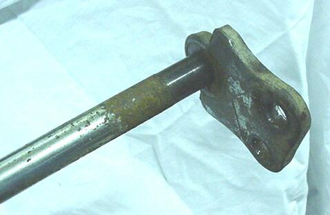

A 3M pad made quick work of cleaning up the shaft.After the shaft was cleaned I

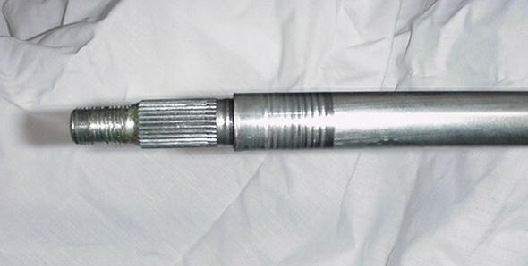

measured for wear the shaft was .010 undersize where the bushing rides on

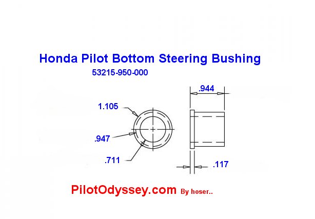

the shaft any more than that I would be making a custom bushing that would be 1"
taller so it would ride on a part of the shaft that was not worn.See where the shaft is
worn you can easily make a new bushing that is longer than stock and will ride higher
on the shaft where it is not worn the only problem in Honda welds a support to the
tubing that the bushing presses into you have to reduce the OD of the bushing where
the welds are for clearance.

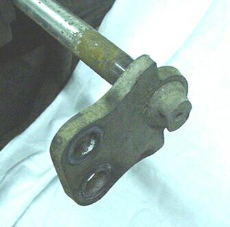

Below you can see the upper end of the steering shaft, it even has a plastic bushing that also was in need of some grease Everything was cleaned, inspected, greased and then assembled. I was going to drill a small hole in the steering stem so the bushing could be oiled every once and a wile but decided not to after taking it apart. Everything is so easy to take apart I am just going to add this to my yearly maintenance list and take it apart clean, inspect and grease. The whole process to do this maintenance only took about 1-1/2 hours, I highly recommend you doing this inspection these machines are 10 years old now and you need to start looking into these items that you normally take for granted
