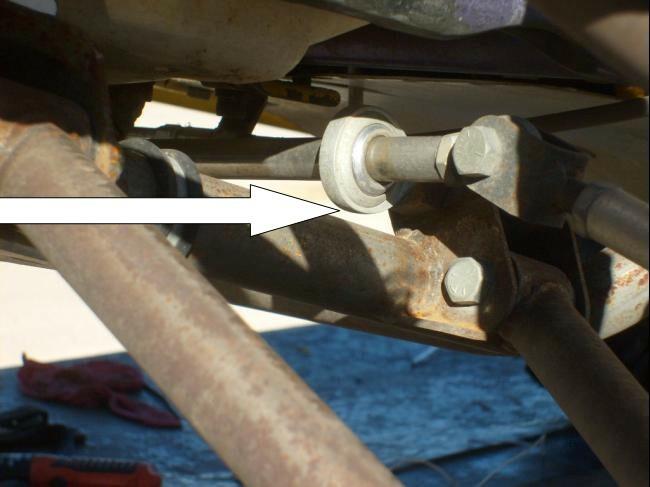

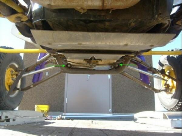

If you look at the 902 903 904 pic's you will see how the hiem the lawyer links pass thru are not evenly placed. the right side is mounted higher. I used a black ziptie to show this in first pics but the zip tie is hard to see...

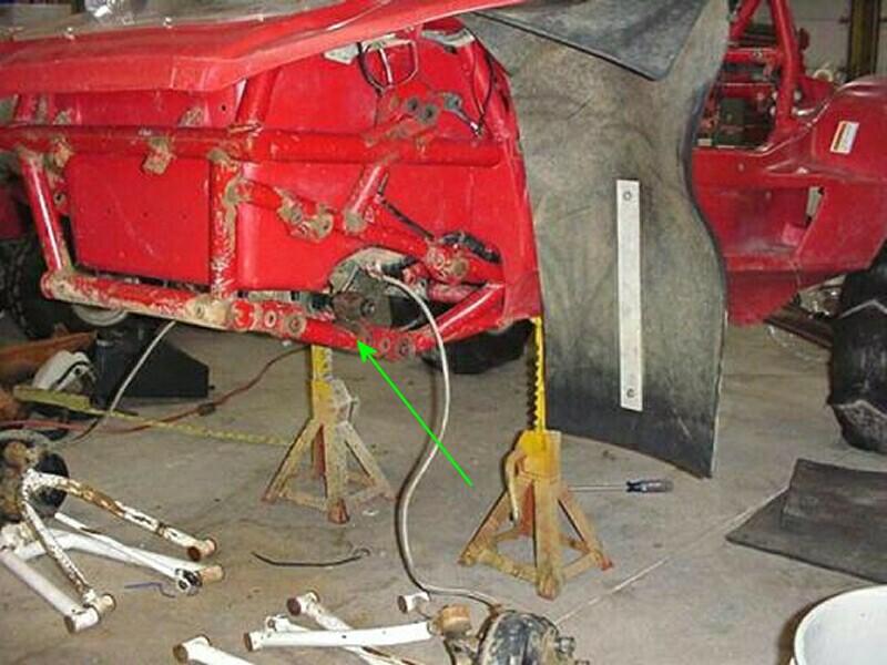

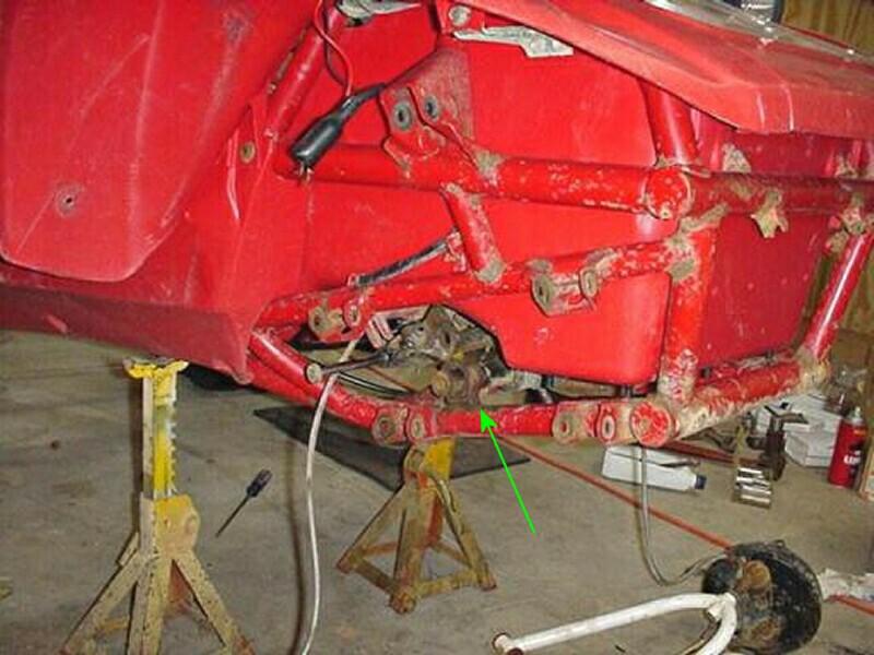

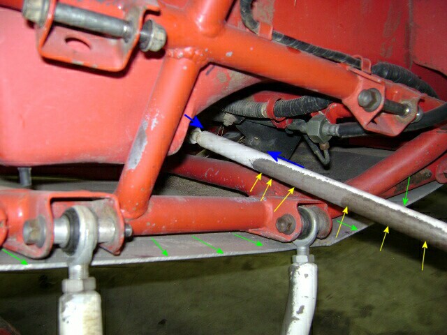

So your talking about the patent pending linear hiem joint mounting points?
I put 2 green arrows in your picture for reference.
Hard telling why they are not the same, perhaps dipstick was trying to keep the same plane as where the lawyer links attach to the steering stem so they don't lock up the steering as much?

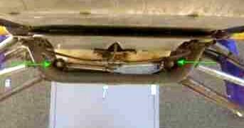

I am refering to the difference in the gap between the sub-frame and this hiem contraption... I placed arrows in the spots I am refering to...
PostPosted: Tue Dec 25, 2007 11:15 pm

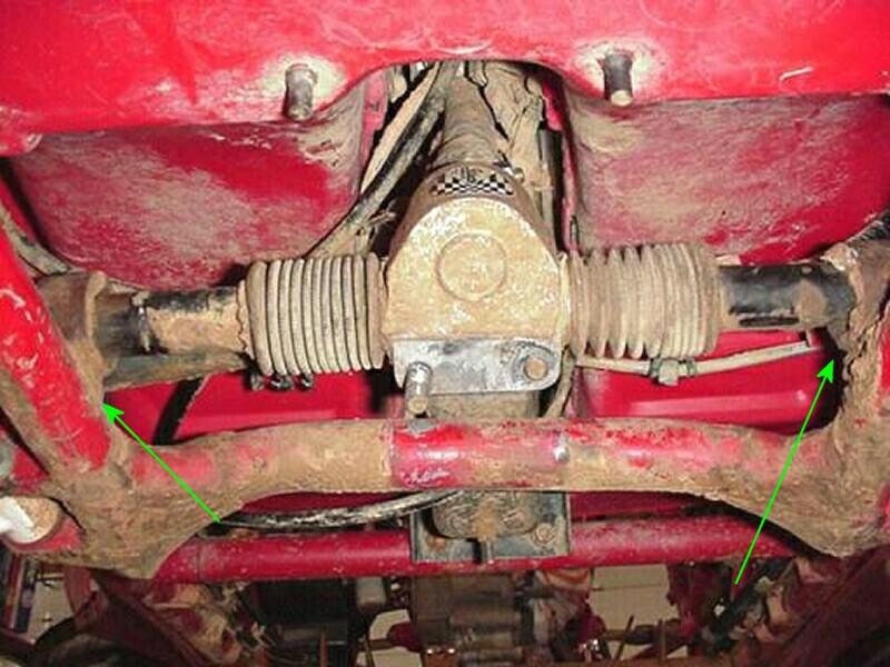

HERE ARE YOUR GREEN ARROWS UP CLOSE... iF YOU USE THE DOOR AS A REFERENCE POINT YOU CAN SQUARE UP THE SUBFRAME AND SEE THAT THE RITE (opps) side is higher than the left/drivers side???

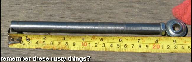

Remember these??? Funny Hoser mentioned 50,000 miles on the back of my trailer. These were the original lawyer links that were supposed to be STAINLESS STEEL!!! These had about 20 minutes of ride time in my front yard, then were loaded up on my trailer for the 2500 mile trip to Oregon. I was told by dseveral of the henchmen/Michigan Mafia that these were Stainless and that the rust was just "surface rust"... I didn't measure when I installed at the house because I had no idea chucklenuts at aftershot motorspurts would treat me the way he did!!! Funny thing was when I got home there was a package on my doorstep that had new LAWYER LINKS!!! No explaination or apology included???
File comment: $2800.00 and counting to work on this thing in a truckstop!!! yea that's why I bought it!!!

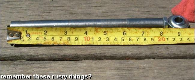

We had talked about problem with the tie rod sliding through the hiem, here is a picture of my tie rod on my Pilot you can see where the paint has been chipped and worn away (yellow arrows) by flying debris even though I have a skid plate that extends wider than the frame rails (green arrows) look at the distance from the steering colum (blue arrows) well into the area where mutts hiem joint mounts, 95% of the riding I have done since I last painted my tie rods has been sand, hopefully next trip I will be able to log a few hundred desert miles to see what kind of rock damage I get.
That being said what does common sence tell you, that is if you have any :-)
