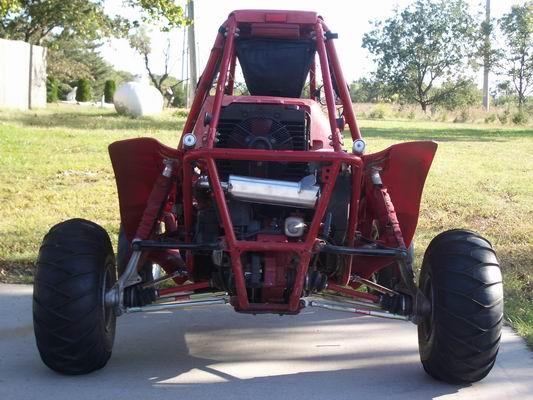

I,am wating for new front and rear shocks to get here ,already ordered. The rears are done and the front are being put together today. I presently use work triple rate in rear and dual rate in front with cans. The new ones will provide 14" in rear and 13.5 in front. I built two differeent type of shock relocate in rear to accomadate stock/work and new lt shocks. The new shock will bolt up to stock mounts so no upper lt brackets required. I also having the new built with low/high speed compression and rebound adjustable with cans. If you go with the atvr type you can not get rebound due to the long shock shaft hollowing it out for rebound make it to week for its lenght. This is why I changed the lever ratio changing the shock angle so I could get rebound adjust. They will big body and sprung( 3.125 in dia. ) I will post up data and setting when they get here and are set up. I opted for low and high speed so I can control body roll and maintain a soft high speed to take advantage of all the shock travle. They will dual rate front and rear. I also wanted to make a set up that could be changed for serveal application and conditions with out cutting and welding frame.
I have some front wheel lock pics and the rear race set up.

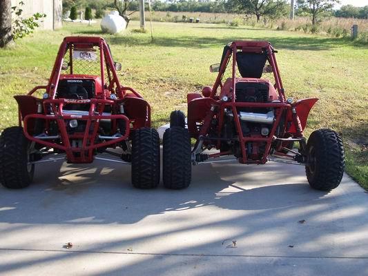

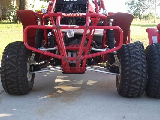

Wide body Dune 67 inches wide can run it 65 inches wide.jpg [ 87.98 KiB | Viewed 4934 times ]

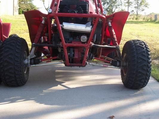

PostPosted: Thu Oct 09, 2008 7:10 pm
I measured up the lt and stock.
Stock: width - F=54", R= 59" and Hub center to center 62"
Wide body dune and trx: width - F=61, R=67/65 and Hub center to center 62"
I oped to maintain the hub to hub so the turning radius could be maintained. Longer and forward arm can just be bolted up to change set up.

PostPosted: Thu Oct 09, 2008 7:15 pm
few more lt and stock for comparison

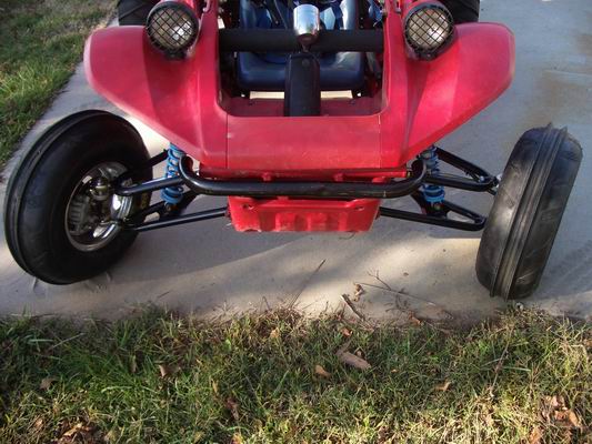

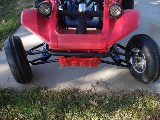

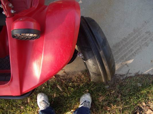

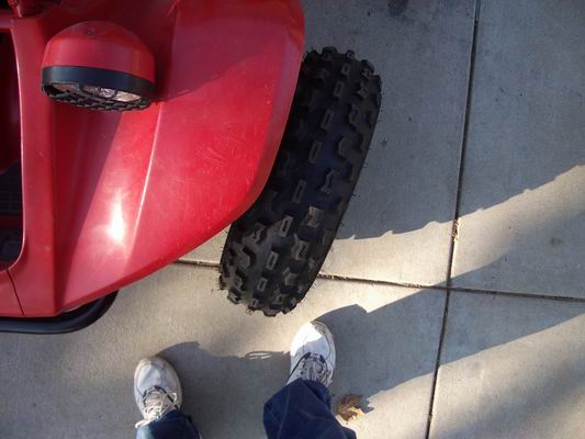

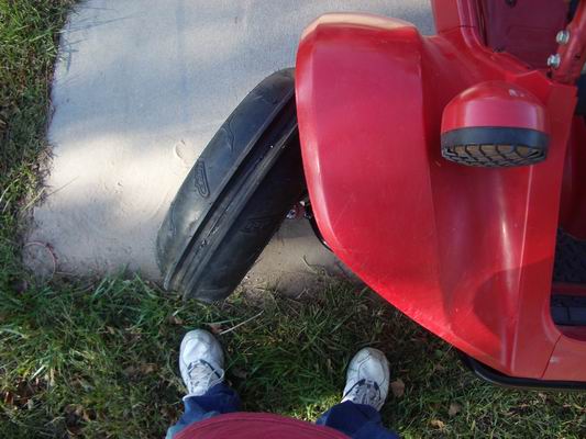

PostPosted: Thu Oct 09, 2008 7:20 pm
One thing I think I should mention about the new bump kit is now that toe issue and wheel lock is resolved the negitive effect is the radius thru travle as the tires scrub. Before the toe offset the radius thu scrub and now it effect radius at wheel lock as it scub thu travle. So there may be one more change before done once I see what feed back is created thru wheel at lock and travle. Before there was zero feed back on off camber wheel lock hits. No kick.

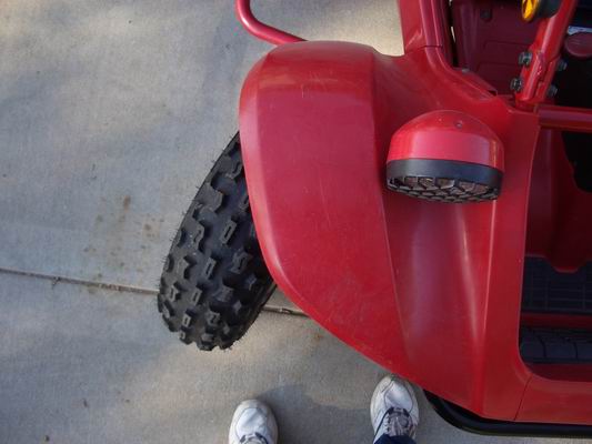

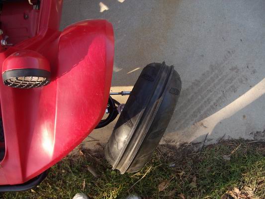

Something looks really wrong here with the angle of the outside tires
PostPosted: Fri Oct 10, 2008 3:56 pm
Posts: 533
Looks like one tire moves further out than the other. Do the arms hit the wheel? Cant tell
PostPosted: Sat Oct 11, 2008 11:24 am
No, they do not hit the wheel. They have 2" clearence from wheel to arm. I had a issue wiith it when I changed the toe thru rake and changed the ratio to fix. As the tires scub the clearence does change this is why I changed the ratio. The pic is particaly a optical illussion that is why I should pics looking strartight down.If anybody feels its a issue I,am listening. Rember its not a pilot front end its a trx

It turns tight, thighter then stock. with the rear width it like to come around instead of bycicle. Changeing caster will dial the front end in ( slowing the steering).

What are you running for your camber in the front. I believe it looks like your getting bad positive camber as you turn the wheel. do you have straight on pics turned left and right to see the camber center and right to left?
PostPosted: Sun Oct 12, 2008 5:22 pm
Camber is at zero and caster is at zero toe at 1/4" in at sag I will double check before test. Been none to get in hurry and loose track of setting as I change set up . I will get turning camber #'s when I get back out to garage.
PostPosted: Sun Oct 12, 2008 5:51 pm
The trx uses positive camber when wheel is turned and set at zero. If I get to much I could, try to offset by adding some negitive at sag set up. I wll get numbers to use as a guide. For those reading post trying to follow, negtive camber is were the top of wheel leans in and positive camber is the top of tire leaning out. In this case I set it at zero and may be getting to much positive beacus I increased the turning radius of the hub. This may account for the excessive positive #. By backing out some radius via ratio on bump kit may resolve issue, if it is a issue the gauge will tell the story.

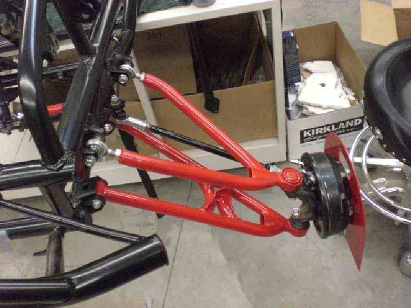

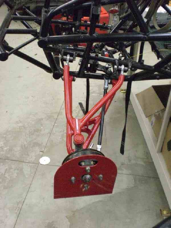

can you show pic's of new set up? shoubadabadabado (sp?) you got better bigger pictures of yours???
PostPosted: Fri May 01, 2009 8:40 pm

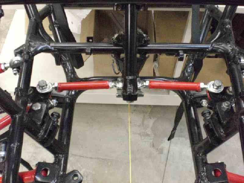

Why of course I can. I thought I already posted some where But will share again. You looking to do so hacking. I will share a nice set that afast car did based on ATVR set up. It a class act. His post is some ware on here but I have a pic.
PostPosted: Fri May 01, 2009 8:57 pm
I like your bolt on setup better than the ATVR I cant wait to see yours up close, if it works like I think it does I might have to get me one so I can add another 2" travel on the front of my Pilot, the idea of using the Honda tie rod ends is all me lol
