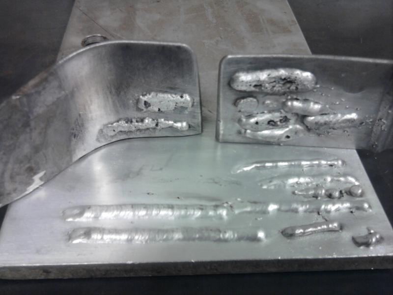

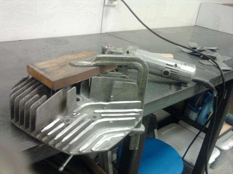

I am trying to make a water cooled head out of my air cooled.
The problem is that the head seems to made out of pig iron of some sort.
I have a brand new miller welder and spool gun for running aluminum wire.
I am running .030 wire 4043 aluminum with 100% argon at 40gph.
When I tried welding on one of the fins I cut off as a test, the weld was full of porosity.
When I welded on a piece of good aluminum plate the welds were great.
Everything was cleaned with a new stainless brush and acetone.
(yes I did try it on one of the cyl fins before I cut the fins off the head and it worked, but
I confess I only made a very small tack weld on the cyl fin).
Anybody got any suggestions?? Has anyone here tried it??
Thanks in advance for any suggestions or info.

Welding cast aluminum is a pain in the arse
All I can say is it must be clean clean clean
Sand blast the head till it's nice an clean with new clean glass beads if ya can
Use a SS brush to clean it afterwards use some acetone or carb cleanerfor the final clean not brake cleaner
Tig welding is what you will need
Mig welding alumium doesn't work at all I've tried plenty of times with cast that's why I got a tig welder
Pre heating cast aluminum works best
With a torch or a oven (oven works best) forget what you preheat it to I'll have to look it up

Damn. I have a tig torch but not the high frequency welding unit to go with it.
I have many welders: 160amp ac/dc, flux core wire feed, brand new mig wire/gas, and a brand
new millermatic 180 with a spool gun for aluminum.
I guess you seem to be saying it's not clean enough so I will try to bead blast it. (Don't have one yet).
I cut the fins off with a zip cut wheel and a hammer (i'm a bit of a cave man sometimes LOL It's the
sawmill millwright in me).

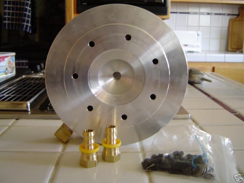

I sent hillside an email and here is their reply:
Hello,
Yes I am the manufacturer of the Hillside Honda Water-cooled heads for the FL350. I am out of stock at the moment with no plans for more; unless I can get an order of 4+ going. The Cost/Time of building them is pretty high with not much room for profit. Seeing as how another company makes one for around $350 (a much less detail oriented model), my CNC Billet Head has to be around $400-$425 to make any profit. I love the project as we have one of the greatest historical ties to the Odyssey world, and am glad to get an order going if you can generate some interest.
Thanks for your time and feel free to ask any more questions!
Trevor
Hillside Honda
Brown's R&D
Here he mentions another company makes one. Does anyone know who??

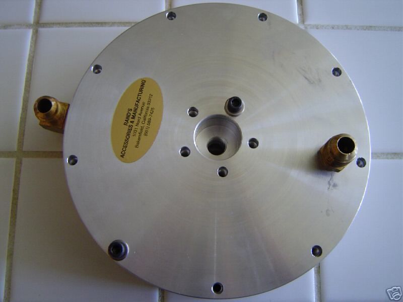

No its not chucklenuts!
Its Rand Manufacturing out of Bakersfield Ca. And no I'm not the Rand of Rand Manufacturing.
Here is the ebay posting for the last one they sold. Email them and see if they can make one for you! You see them quite often on ebay.
http://www.ebay.com/itm/HONDA-ODYSSEY-F ... 83?vxp=mtr
PostPosted: Wed Oct 30, 2013 12:47 am
http://www.ebay.com/itm/HONDA-ODYSSEY-F ... 83?vxp=mtr" ."..
That seller is not the manufacturer of that head i don't believe. He is a guy that just had a large horde of pilot and odyssey parts.
