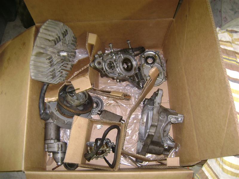

Bubba66 stopped by and dropped off his 350 basket case Engine, he can give the details on this basket case project I don't know all the little details.
The Engine looks to be in pretty good shape.
So far other than the missing head nuts everything seems to be here to build up a complete Engine I will find out for sure as I assemble.

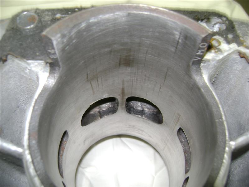

The cylinder looks good some minor scuffing from dirt but its not bad the as found piston to cylinder clearance was .004 just a little on the tight side for a 350 Odyssey Engine.

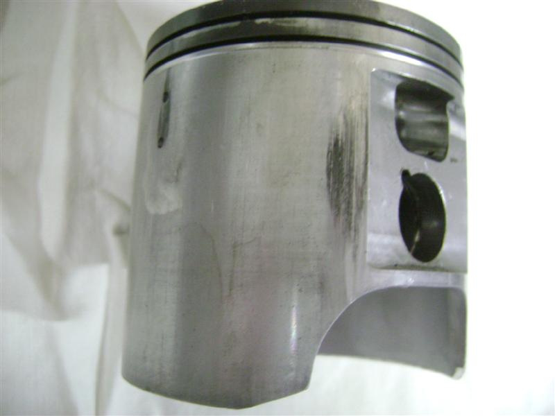

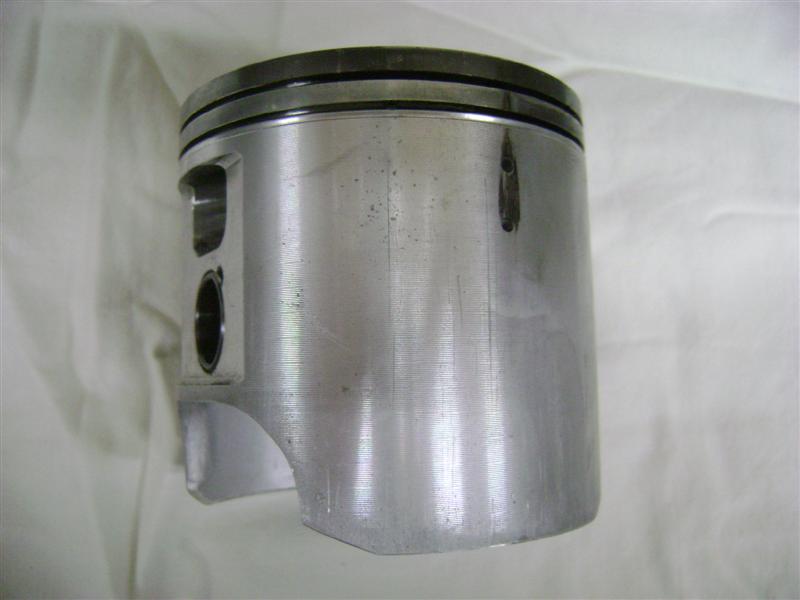

PostPosted: Mon Jan 31, 2011 9:06 am
The piston looks like it only has a few hours use on it other than the scuffing from the dirt no real wear, it will be reused, their was some slight scuffing on the bridge the bridge was not properly relieved in the cylinder this will be corrected before I assemble.
I will polish up that scuffed up area, relieve the bridge then finish hone the cylinder to a clearance of .0045.

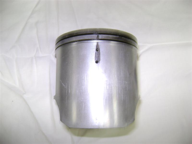

One side on the exhaust side of the piston also had a scuff mark it will be polished too.

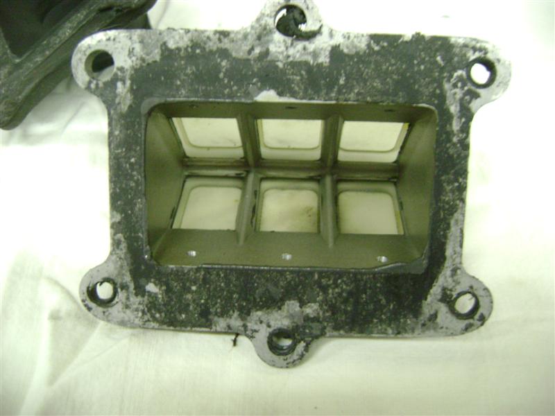

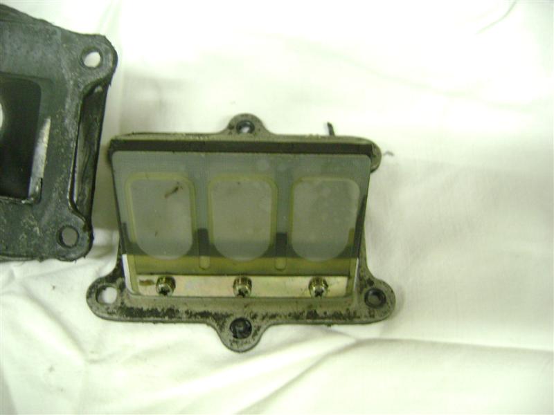

Intake manifold hard as a rock as usual, reeds look almost new.
I find that pic of the bridge wear marks,over the cooling/lube piston holes interesting.
It's tapered,not even? The piston must be rocking forward/backward on it's stroke?
Or is it the ring that keeps it away from the bridge?
PostPosted: Mon Jan 31, 2011 11:55 am
Look at the bridge on the cylinder pictures I gave the cylinder a light hone with my ridged hone, you can see the rub marks and see the cross hatch from the hone on the bridge, they never did anything to the bridge so when up to temp and the bridge expands into the cylinder it put the rub marks you see on the piston.
This is a good example why the bridge needs relieved as well as the holes drilled.
