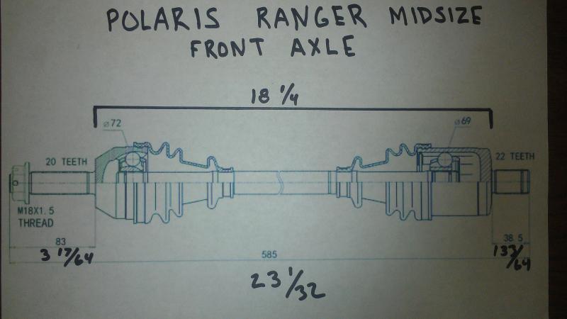

Ok I finally got some good specs here on a axle I believe should work. Thanks to the fine people at American cv they were very helpful. I went ahead and ordered a pair from them. I will have to ether modify a set of hubs or build my own to get back to the 350's bolt pattern. The outer splines are only 20 spline vs the 350's 24. I found banshee hubs are the same 24 spline. But now ill have to rethink my hubs.

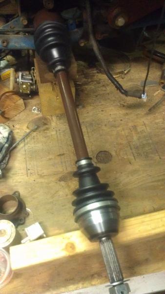

The axles came today. They look good.

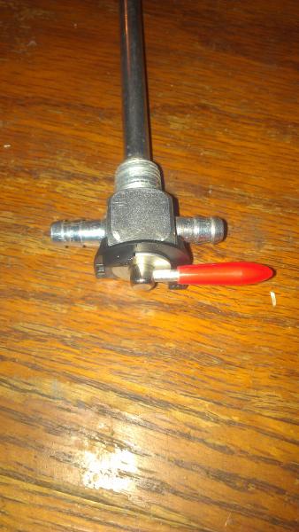

Got my petcock today. Its from a margay gokart or at least that's what its listed as. It's 1/4 pipe and duel 1/4" barbed outlets. The fuel tank is being built I hope to have it Friday.

Which Polaris Rgr model are the axles from? Must be something smaller than a 700cc? Everything I've looked at for the RGR & RZR & Sportsman 700-800 is 26-spline outer.
PostPosted: Wed Jan 28, 2015 4:45 pm
Posts: 642
the axles i bought are 2013 ranger 500 front shafts. the rear shafts that i found had a much larger splined end for the differential. the outer splines are slightly smaller than the inner but i don't think this will be a issue. plus id rather the weak point to be outside of the gear box. i guess we'll see if it can broken ill usually be the one who breaks it.

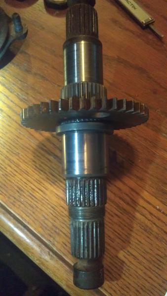

Ok before I talked about having to enlarge the splined portion of the output shaft. I happen to find that the crank shaft gear of stock 350 has a 34 spline count and seems to be an ideal spline size to enlarge my shaft to. The OD size of the splines are slightly smaller than the ID of the bearing race. So this will be the new spline size for the brake disc hub. I found a Ducati disc that measures 9-1/2" in diameter. I'd like to build a new hub that will fit both the disc and the new larger output shaft. The nut from the crank is also larger and I will use this nut for the new shaft and brake hub.

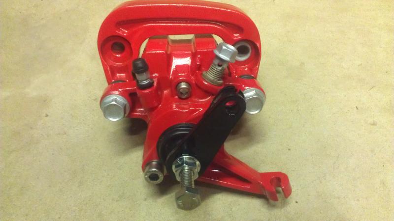

Finally finished my brake caliper. I've been waiting on some seals. Found that a 2000 Chevy rear wheel cylinder boot fits great for a replacement parking brake boot.

Now that's a spiffy rear caliper!

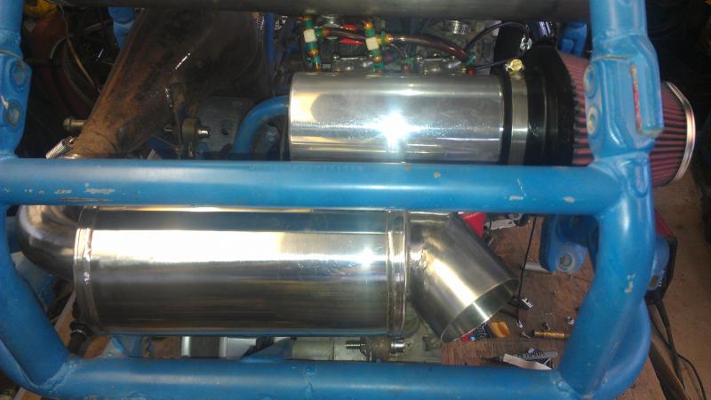

Added a tip to my silencer and welded and polished my intake.

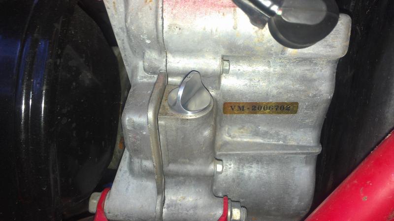

my gear box oil cap was old and Sun rotten. So I machined a new one.

Nice machine work. Did you make a groove at the base of the cap for an o-ring?

There's a relief area like the factory one has. The o-ring will sit there. I just put a small hole for a vent. I think I may add a pressed brass filter like a quadrajet uses. To help keep debris out and oil in. This is my first attempt I have at least 3 more to build.

It fits nicely
