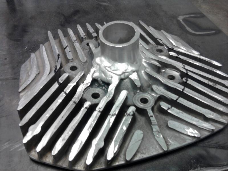

Had some success tonight welding on the head. Here is a photo.
All I can think of is that the aluminum piece I added supplied enough extra to the parent metal that I didn't have as much problem with the weld like I did when I just tried to weld on one of the fins. When welding on the fins alone it gassed off bad and the welds were full of holes. No doubt there are probably inclusions in the weld but it does seem to be ok. Gona try more tomorrow late at night after the trick or treaters are gone.

You may have a pin hole or two, but hopefully nothing some rad leak-stop can't fix.
Are you going to weld-in fittings? I'd recommend welding the bung in only so you can replace the elbow/fitting if it should ever get damaged. Seen a lot of "cool heads" with flattened or chipped outlets!
How true / perpendicular is that core you welded in? Could you chuck that piece up on a lathe, turn the OD down and then get like a 8" or 10" or 12" piece of aluminum tubing to just fit over? Like a piece like this here could cover like 4-5 heads and jugs: http://www.ebay.com/itm/12-OD-X-32-L-X-3-8-WALL-6063-ALUMINUM-ROUND-TUBE-PAINTED-WHITE-41-/300753054475?pt=LH_DefaultDomain_0&hash=item4606476b0b

Now your cooking, you try preheating the head in the oven before welding?
PostPosted: Thu Oct 31, 2013 4:10 pm
Not sure about the fittings yet as that is to far away for me right now.
No I didn't preheat, just wiped with acetone and brushed with stainless brush.
Seemed to work well. You might laugh but I am actually thinking of buying a block of ice to
put the head on when I weld up the the main piece. The reason being is that I don't want
to warp the head when welding.

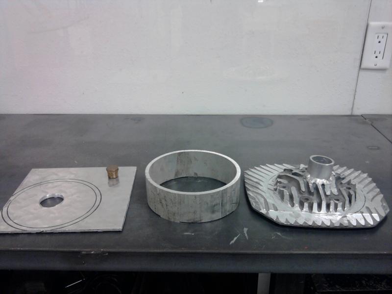

PostPosted: Wed Nov 06, 2013 6:18 am

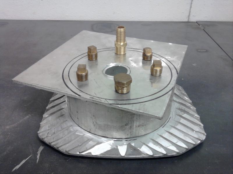

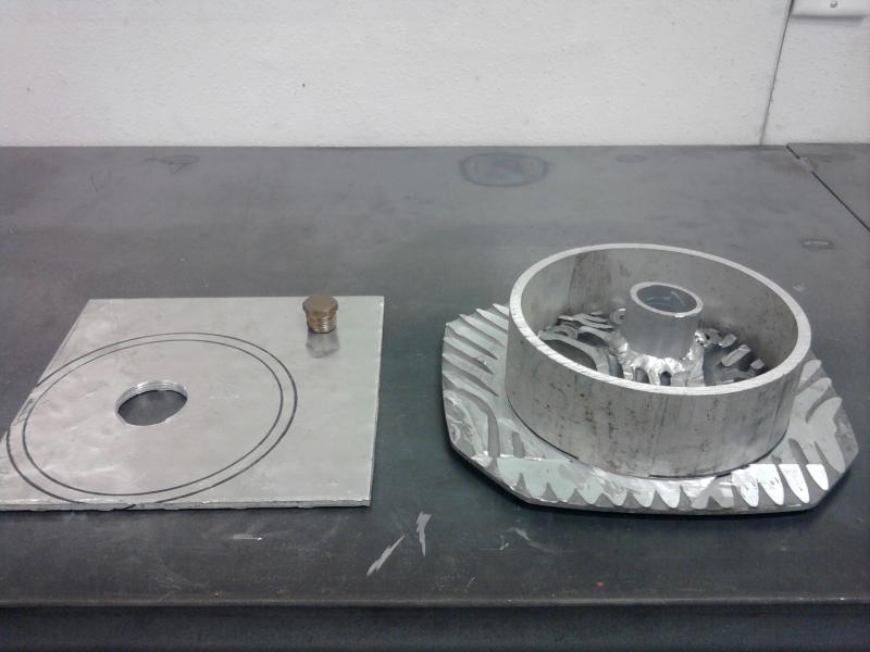

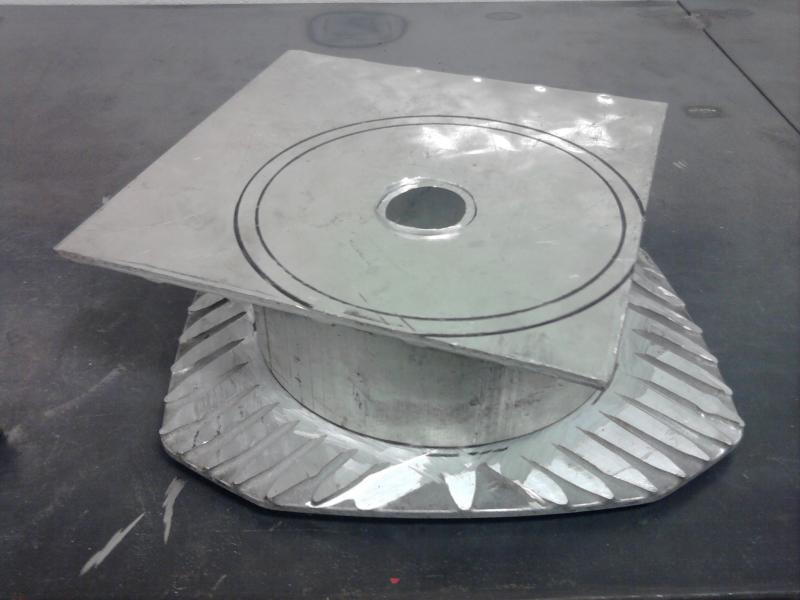

Some updated photos. This is more work than I thought. It's taking time.
Plan on welding it up solid and having plugs you can remove to get at the head
bolts so you can torque or remove. One hole will be used for water out and
another hole will be drilled n tapped on the other side for water in.

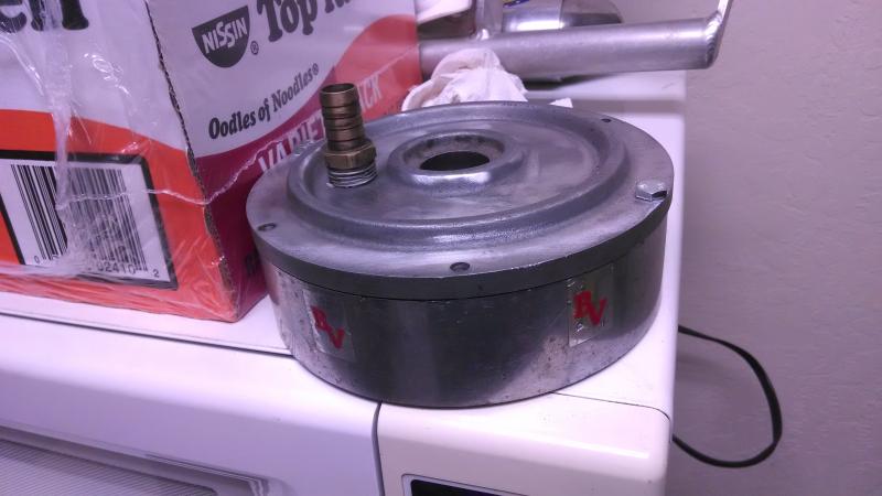

been thinking about having one of the guys at work help me make a copy of this
File comment: Bv Head
Looks good to me I like the idea of just having the plugs to access the head nuts good thinking, you might need copper sealing washers between the nuts and the head?
http://www.grainger.com/Grainger/flat-washers/washers/fasteners/ecatalog/N-8ogZ1z0w5de
Where did you find the large diameter aluminum pipe and how much?
I have a first generation 350 head here I might attempt to do the same as your doing you want to sell me the materials you used to make yours?
