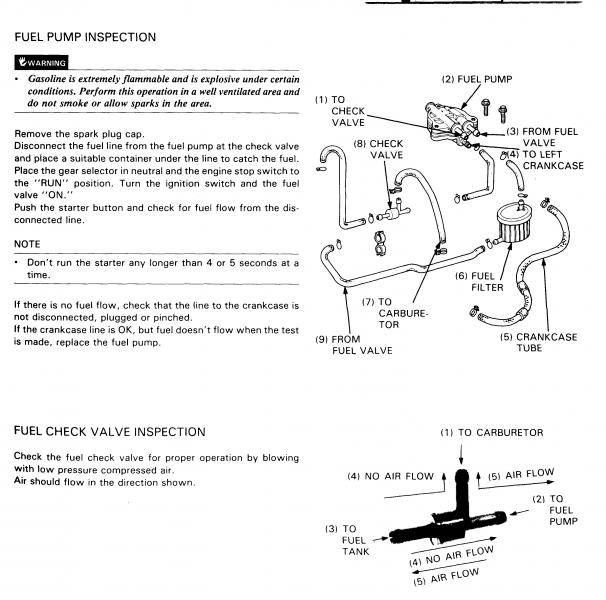

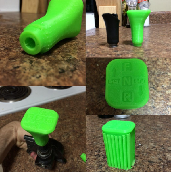

I found this online and thought it was a good idea. He 3D printed a new shift knob. Just an idea.

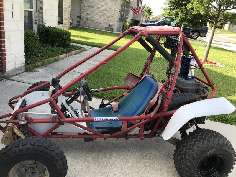

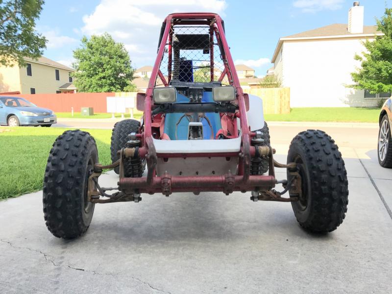

Here are pictures from the day i brought her home
that's cool! i have access to a 3D printer... where is the STL print file i can use?

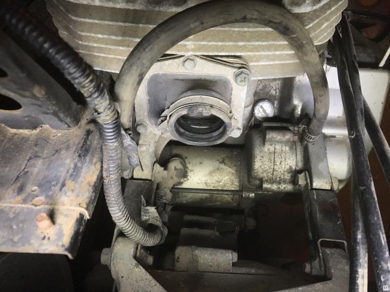

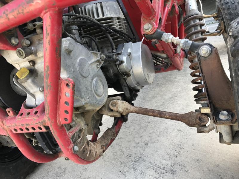

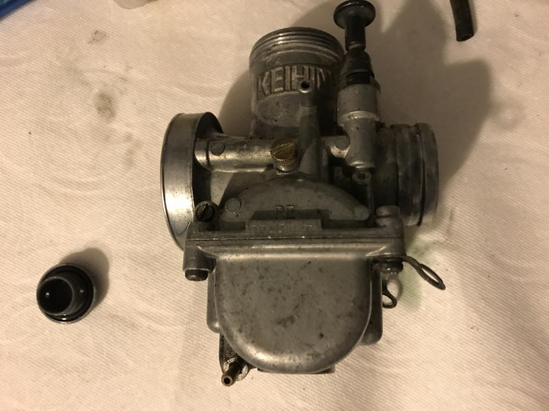

I took of the carb today to strip it, clean it, dunk it. Both jets were pretty clogged. I also took of the batter box to start cleaning and repaint soon.
What i learn today
1. Ive got a 138 main jet ( i live in texas with high heat and 100ft altitude) so ill check my need jet setting and turn my air screw out to the recommended setting based on the honda manual and it should hopefully improve its reliability for starting.
2. The carb must have been replaced or rebuild at one time because the choke is not attached
3. Boot looks ok. Picture attached
4. The previous owner looks to have installed the wrong type of air filter... so its not doing anything... BOO. Will fix somehow
Questions
1. How do i re-attached the choke cable (so i can control it up front)
2. How does my intake boot look.
3. Should i follow the honda manual for all my jet settings, #138 main, 1st grove, 2 turns out?
4.Whats the vent tube i have near the oil inlet... is this the vent mod people talk about?

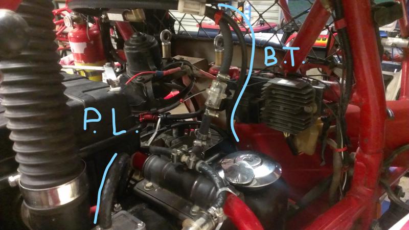

Nice project

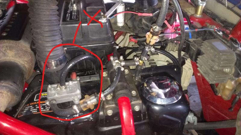

BUT your ? 4
I see there in no Stock tank which looks like NO stock Fuel pump
The PULSE line for the FUEL PUMP looks like it might be attached
to the Breather tube that you call the VENT tube mod
if this is the case DON'T RUN IT AT ALL
I don't know if you have a Manual yet if not get one
The Pulse tube comes from the base of the cylinder / Barrel behind the clutch then it goes to
the pulse side of the fuel pump ( which you might not have )
see pics
B.T Breather Tube
P.L Pulse line
The Breather tube is just a breather which I run up high with a Fine filter attached
Now I could be worry but it is the way it looks
wyeeoddy

CAUTION: If you can see a crack on that intake your done. YOU CAN'T FIX IT -- get a new one. I am not sure where you can buy one. I make my own. If you don't replace it then you are going to blow the Engine guaranteed.
PostPosted: Thu Jun 29, 2017 6:06 pm
Joined: Wed Jun 14, 2017 8:49 am
Posts: 48
Thanks for all the tips. I have trad through the service manual a few times (but i don't remember it all ) and have a details plan for this fl350.
Step 1 is unhack all the hacks in the rig and get things working as they are sappose to. (It hardly runs with the hack it has on today)
- clean carb (in progress)
- swap battery (done)
- repair all witing and electronics
- spark plug / coil replacment
- repair and preplace original gas tank
- repair brake system ( its dry )
- repair fendors
Step 2 is take if for a spin. If im in love with it, ill either rebuild or replace with a farr offroad rotax 500 kit. If im not a fan ill sell it having made it better for the next guy.
My lift of todos are alot more exstensive and detailed sorry if it seems im also over the place. There is a method to what im doing
I saw someone make one out of billit aluminum. If i could get the cad file i could 3d print one in aluminum.
How do you make your own?
PostPosted: Thu Jun 29, 2017 6:33 pm
viewtopic.php?f=1&t=17228&hilit=intake+manifold
