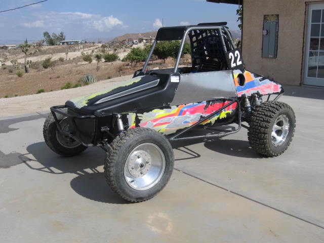

Now for the very cool part! Bob with Extreme Baja Kart sent me a scan of a magazine article from ATV Sport back in 1988 profiling the H&R cars. As soon as I can shrink it (the pages are 8meg each) I will post them
BUT, PHOTOS are now on POSTED! Vist www.bluecoyoteracing.com and click on Stadium Lite for lots of photos!
Next race - Aug 2 - Podium Productions - Milestone MX Park - Riverside CA
Below is a teaser...
