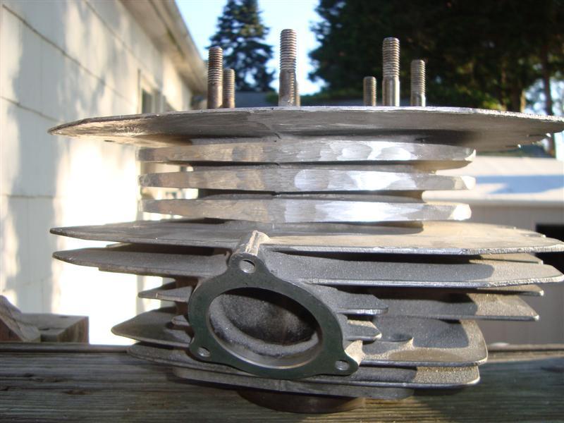

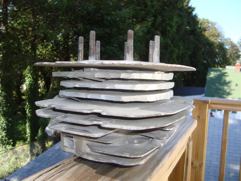

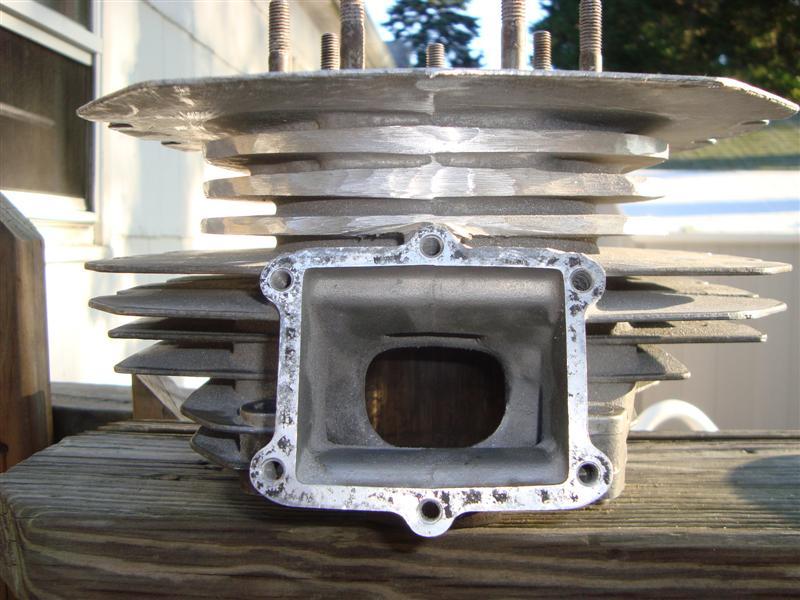

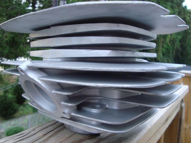

heres some pics of the cylinder im converting

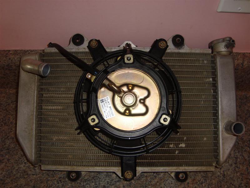

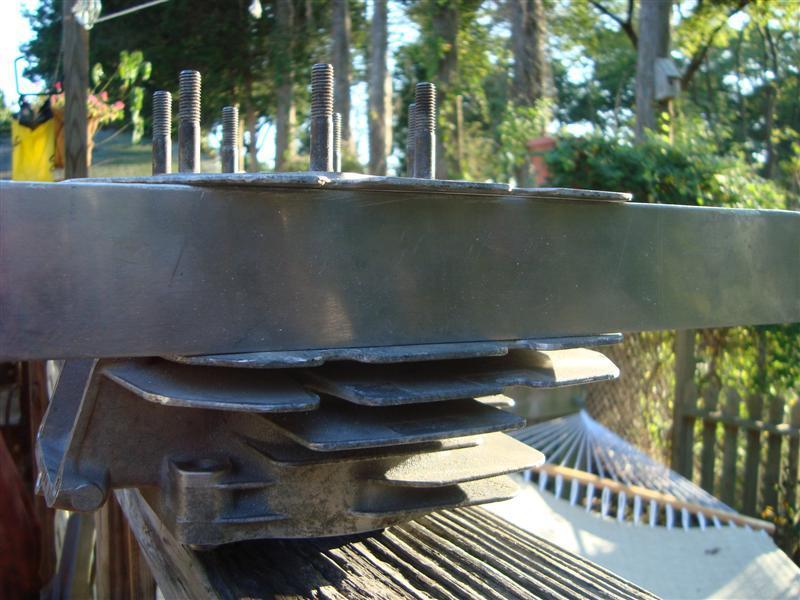

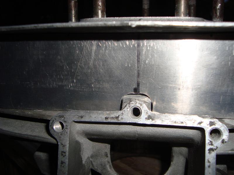

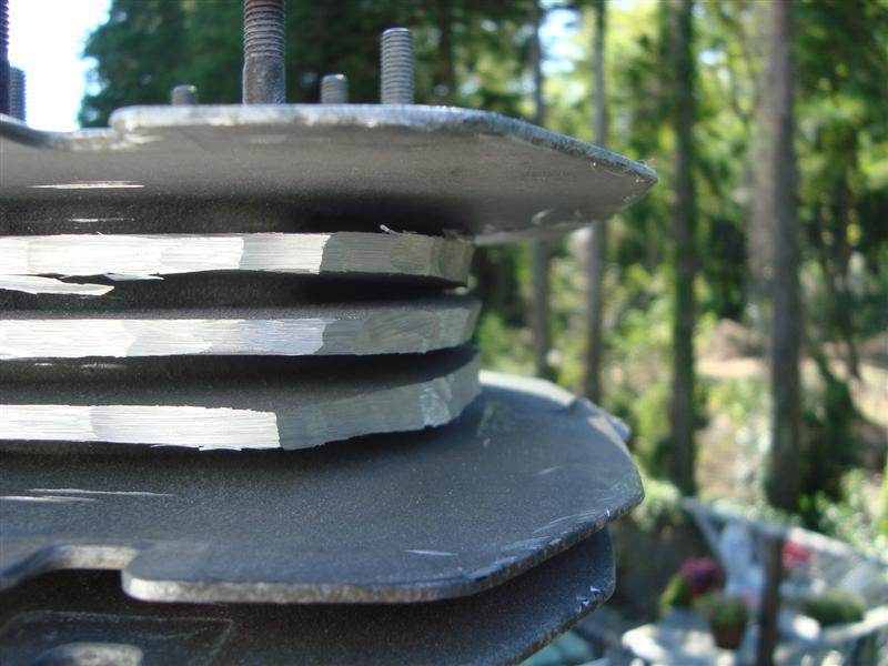

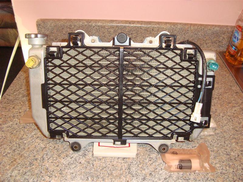

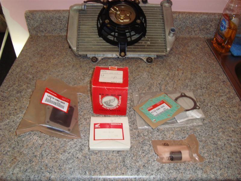

ok fins ground down and cleaned up.cut a 40" by 1 13/16 piece 1/8" thick aluminum.still need to grind around the one stud casting that attaches to one of the fins behind the intake flange then i can fit up the piece i cut.also picked up a used rad from an 07 yzf quad off of ebay for 48.00 which i thought was a great deal.also picked up almost all the parts for the top end minus the head gasket(babbits online had none left).so ill try service honda next hope they have it.

TRX450R radiator and fan?

question whats the vent coming off the fan used for.
PostPosted: Tue Sep 15, 2009 9:28 pm
to cool the motor (( Internal Combustion Engine ? ))???
PostPosted: Wed Sep 16, 2009 9:28 am
Posts: 708
Are sure you're not referring to the power cord?
If it's the vents around the fan that you're talking about, that's where the air is drawn through to the radiator.
Please tell me I'm not stating the obvious.
Does anything here answer your question? If not I'm sure someone can. :-)
PostPosted: Wed Sep 16, 2009 3:23 pm
Posts: 432
Location: long island NY
on the back of the fan itself.theres a fitting for a small hose or tube.have no clue what its for.

more pics of cylinder.not the greatest gettin dark

PostPosted: Thu Sep 17, 2009 8:40 am
Posts: 1090
Hello, that is a vent whole to cool the fan motor (( Internal Combustion Engine ? )) itself like turbo said. It probably has a hose connection because it came off of an atv and they do not want any water or debris to get in there. All the electric fan motor (( Internal Combustion Engine ? ))'s I have seen have some kind of fresh air vent.

PostPosted: Thu Sep 17, 2009 12:52 pm
Take care.
They usually have a hookup to the carb boot for filtered air...
PostPosted: Thu Sep 17, 2009 3:58 pm
Posts: 432
thank you all.couldnt figure why they had it pointing upward for.but hooking up by the carb i see why.

more details on the water jacket! How will you weld it, and plumb it??? going with a hillside head???
PostPosted: Thu Sep 17, 2009 10:00 pm
Posts: 432
trying to get hillside head.so far no luck.wanna get the head in my hands before i plumb the cylinder.as far as welding it will be tig welded.still gotta glass bead the cylinder before welding.hopefully ill
get it done sometime next week.

hy the glass bead??? To clean up the aluminum for welding??? I can't weld but I can get it fitted and have it welded...

yes the glass beading is to clean up the aluminum as much as possible for the welding.im having a close family freind who been doing aluminum hull welding for over 20yrs do the work.i weld for a living but don't have the equipment to weld aluminum,and cant justify buying a 2000.00 machine that will get used maybe a hand full of times a year.

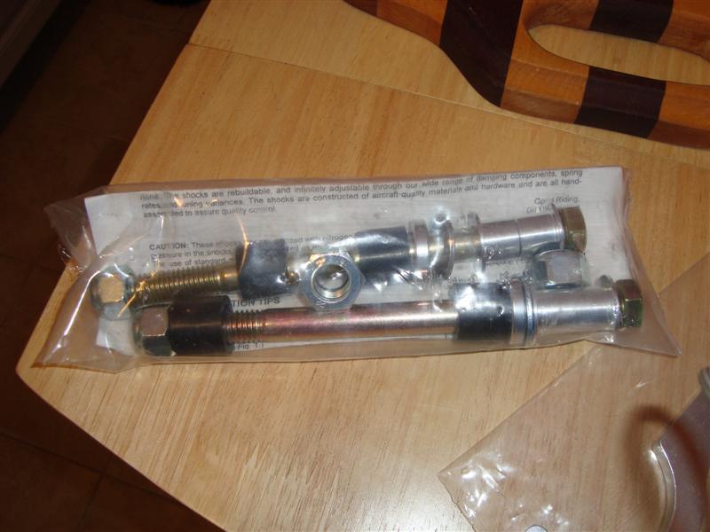

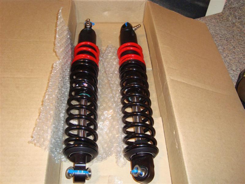

wow finally got my nice new G series shocks.took 8 weeks to get the dam things.went without the rezzies cant see these things fading from trail ridin.cant wait to try them.this thing beats me at high speeds in the bumpy stuff.

they gave me a set with the new shocks

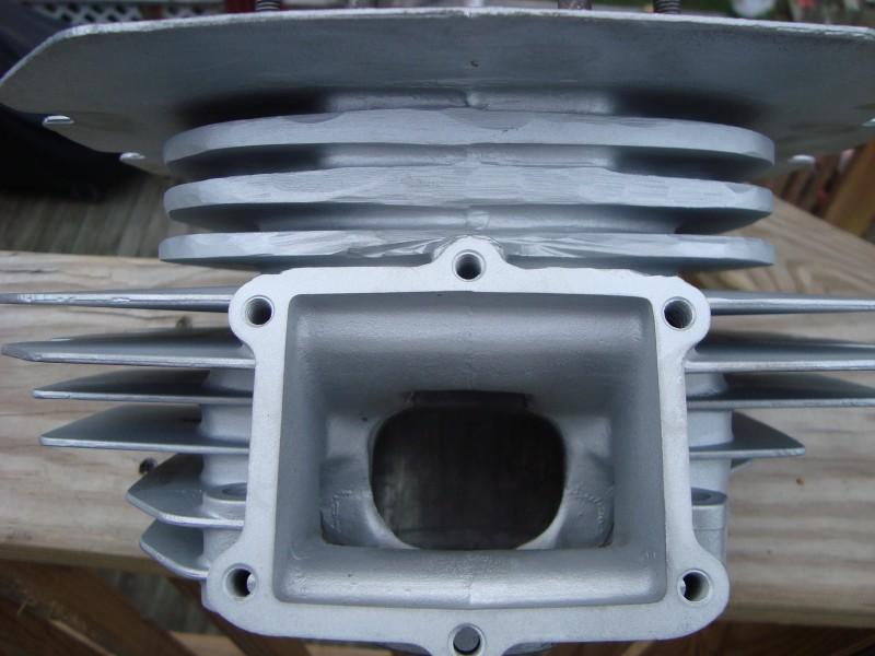

ok got the cylinder glass beaded today.hopefully will get it welded this weekend
