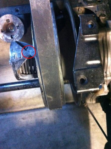

Lay the belt into the driven clutch and take a pic. I would like to see how it sits in the pully.

This is the pic I am after. How far above the pully does the belt ride? It looks close and you should be okay. If this was a stock driven clutch that belt would not even be close to fit.
I think you are okay. But here is a vid on how I made mine wider for the larger sled belt. I think this has already been done. But take some pic or tell me how far out of the pullt the belt ride.
Again from the looks of it and the parts that were on your car. I think this has been done already or one of the other mods to make them wider.
http://www.youtube.com/watch?v=M6iiN3sL8xA" .".." ."..
http://www.youtube.com/watch?v=M6iiN3sL8xA" .".." .".." ."..
on the new motor (( Internal Combustion Engine ? )) the belt sits on it with play about 1/16, on the first motor (( Internal Combustion Engine ? )) it sits inside the clutch good, on the rear it sits like the ribbed part of the belt sits inside and the flat part of the belt rides on the edge.

l3ooty6rabber wrote:
http://www.youtube.com/watch?v=M6iiN3sL8xA" .".." .".." .".." .".." .".." .".." .".." ."..
on the new motor (( Internal Combustion Engine ? )) ((starter motor (( Internal Combustion Engine ? )) or a fan motor (( Internal Combustion Engine ? ))?)) the belt sits on it with play about 1/16, on the first motor (( Internal Combustion Engine ? )) ((starter motor (( Internal Combustion Engine ? )) or a fan motor (( Internal Combustion Engine ? ))?)) it sits inside the clutch good, on the rear it sits like the ribbed part of the belt sits inside and the flat part of the belt rides on the edge.
Perfect you good to go then. Bolt that sucker in and hook up the wires clean the carb and fuel lines and ride it. The belt may just work fine as far as fit. Keep your fingers crossed.

Tpreed wrote:
I'm on my phone so I can't see too well, but how much life is left on the driven clutch buttons?
? This is my first fl 250 and I know nothing about them. But I have a thing for motors and modding. Anything and everything I own has to be modded to be different from factory. I just like to be different with taste. I've been building Honda automobiles for sometime now and know a lot about them. I got my first dirt toy new years 2012; my Suzuki ltz 400. Just picked this up a few days ago. Starting a new hobby since I live in the desert.
 Post subject: Re: New summer project
PostPosted: Mon Mar 12, 2012 1:42 am
Posts: 1228
I circled the part you need to check out. These slippers/buttons keep the two cams from touching as the clutch goes through its opening and closing motion. Here is a link to the part and how they look new. http://www.ebay.com/itm/HONDA-FL250-ODY ... 500wt_1054" .".." ."..
From the picture you posted it appears they are definitely worn beyond spec. Be careful replacing them as they may break off in the hole.
PostPosted: Mon Mar 12, 2012 3:44 am
Joined: Fri Mar 09, 2012 3:13 pm
Posts: 43
Location: Las Vegas, Nevada
Tpreed wrote:
I circled the part you need to check out. These slippers/buttons keep the two cams from touching as the clutch goes through its opening and closing motion. Here is a link to the part and how they look new. http://www.ebay.com/itm/HONDA-FL250-ODY ... 500wt_1054" .".." .".." ."..
What should it look like?
PostPosted: Mon Mar 12, 2012 3:46 am
Posts: 43
Tpreed wrote:
I circled the part you need to check out. These slippers/buttons keep the two cams from touching as the clutch goes through its opening and closing motion. Here is a link to the part and how they look new. http://www.ebay.com/itm/HONDA-FL250-ODY ... 500wt_1054" .".." .".." .".." ."..
They look like they have a rubber piece in between them. Just that everything is black it's hard to tell.
PostPosted: Mon Mar 12, 2012 9:56 am
Posts: 1228
Tpreed wrote:
I circled the part you need to check out. These slippers/buttons keep the two cams from touching as the clutch goes through its opening and closing motion. Here is a link to the part and how they look new. http://www.ebay.com/itm/HONDA-FL250-ODY ... 500wt_1054" .".." .".." .".." .".." ."..
Can you take a closer picture? try putting your camera in macro mode(macro setting is represented by a flower icon).
PostPosted: Mon Mar 12, 2012 2:20 pm
Posts: 43
Tpreed wrote:
I circled the part you need to check out. These slippers/buttons keep the two cams from touching as the clutch goes through its opening and closing motion. Here is a link to the part and how they look new. http://www.ebay.com/itm/HONDA-FL250-ODY ... 500wt_1054" .".." .".." .".." .".." .".." ."..
I must have missed the link. Yes they are in there. About 1/4" eyeballing
