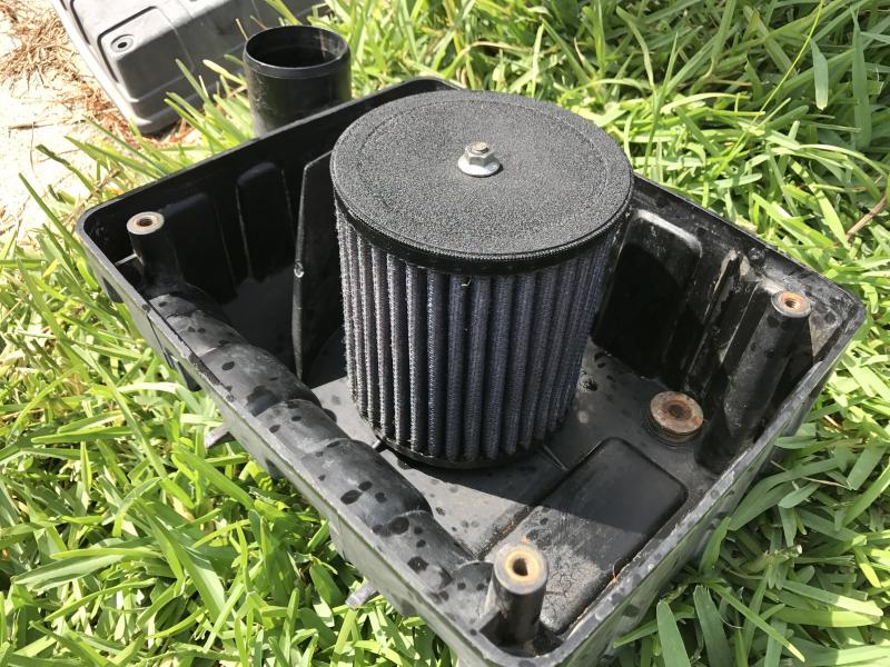

1. Dipped the carb and re-assembled it. (dirt dirt jets now clean)
3. Made a quick fix for my air filter issue (need to paint it black)

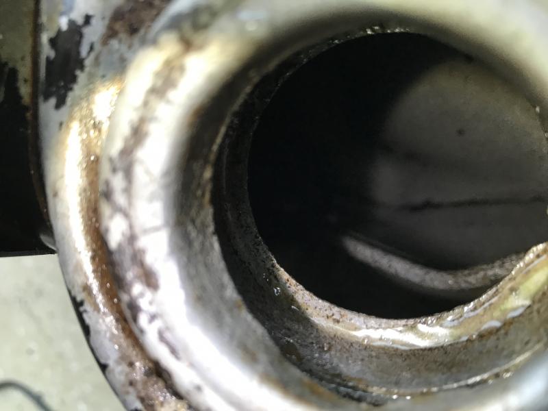

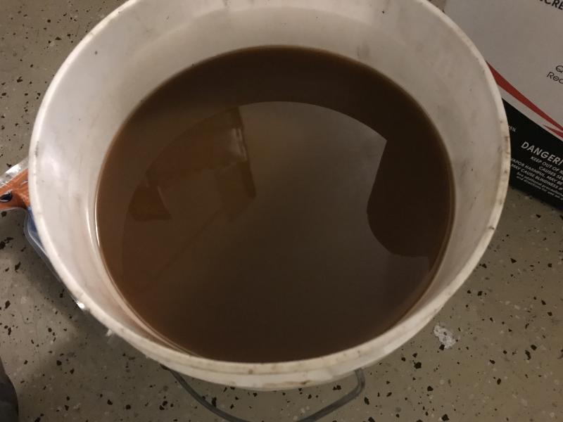

Weekend Updates
My Tank is finally clean!!!
Before and after pictures below. Im going to try and install the tank and get all the fuel line routing up and working tommarow.

PostPosted: Sat Jul 01, 2017 10:00 pm
Wow that's pretty good.
My only concern now is how badly the lines and screens are corroded. Look into the tank and you can see the screens at the end of the lines. How bad ??
What type of two stroke oil -- that is another one of those points of argument here. You choose.

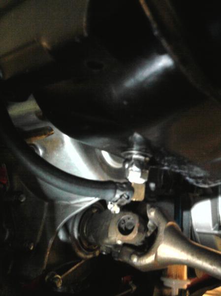

PostPosted: Sat Jul 01, 2017 11:02 pm
I just found this piece in the scrap box and took a pic.
This is what is on the end of each tube in the tank and in that round hole is a cylindrical screen about and inch long. This piece is spot welded on the tube. Mine were broken or corroded off. On one machine there was still a clogged brass screen. I must have thrown it all out but did have this bit left in the scrap box.
Can't seem to be able to attach any pics at the moment. Will post it when I can.
PostPosted: Sat Jul 01, 2017 11:05 pm
Lets try again -- that's weird -- it works now.
File comment: bit at the end of the fuel lines in the tank. Missing is the brass screen for the end of it.

yup that's what mine looks like... there is no screen, must has corroded off. But at least i have a clean tank, clean carb, clean air filter, working starter. The previous owner claimed it ran earlier in the day before i got there and he was running it up and down the street. If any of that is true im hoping it will fire up after all my TLC.

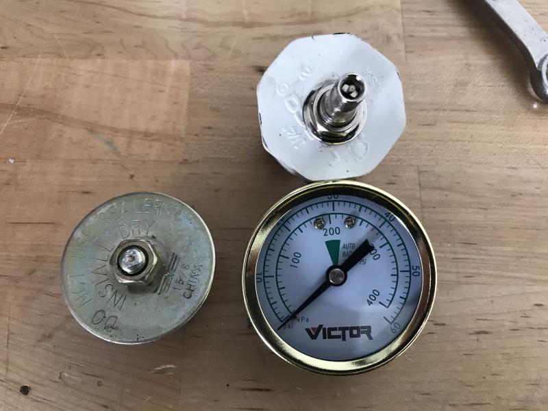

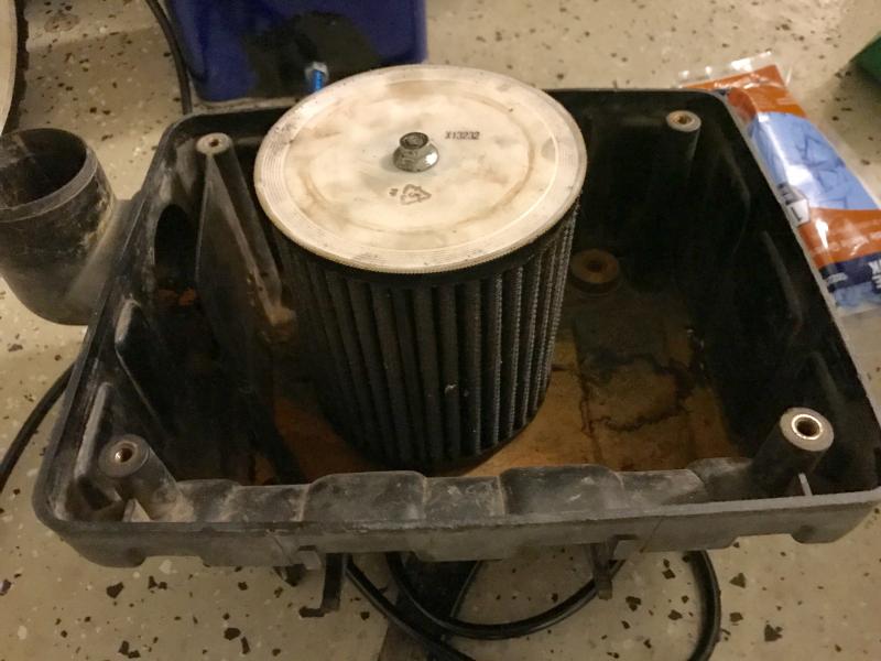

Update
- made a leakdown test kit, used it and it failed misserably. Held pressure for about 10-15 seconds max. I sprayed soaping water on every part i could find and no bubbles. The 2 places i could not reach where the crank seals. The cluch and pull start covers were both on. Ill find the leak before the teardown of the rebuild. (Video attached)
- the tank is clean but the res line is clogged, tried everything to unclogg it. No luck. Im buying an air compressor tommarow to try and blow it out and if that doesnt fix it ill be getting a new gas tank.
- cleaned air filter and air box, painted my air filter top.
- in an effort to remove the seat i tried removing the bottom seat bolts. Water started porring out of the bolts and 2 of the 4 bolts snapped(rusted) and 1 is stripped. Good news, now i know why my seat would never dry out...

3) Leak down test
Yup it failed according to that video. You can loosen the dip stick and soap around it to see if any bubbles. If yes then the double lip seal is shot. You will also have to remove the pull starter assembly so that you can soap the seal in there and check for bubbles.
Edit: I hope you had the piston in the down position or at least low enough that the ports were open. The reason is that if the piston is up at TDC (Top Dead Center) then the pressure slowly migrates to the combustion chamber through the rings. Piston must be down for an accurate test. In my opinion though, that pressure drop I seen in the video was unbelievably quick. I don't think it would drop that fast even if the piston was up.
