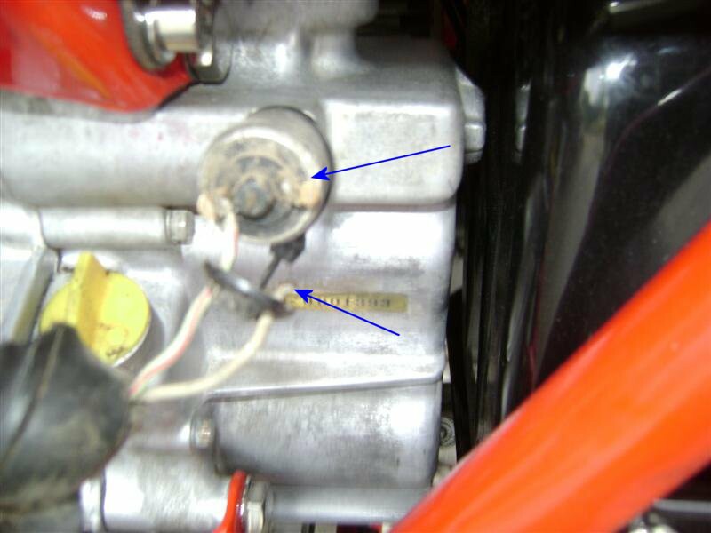

The wire broken off the switch on the trans seems to be the problem, soldered it back on not sure how long it will last everything designed to support the wires on the swich are broken their is a strain relief plastic piece that supports the wires under the rubber boot, both are damaged, my suggestion would be to bypass the switch as mention before.

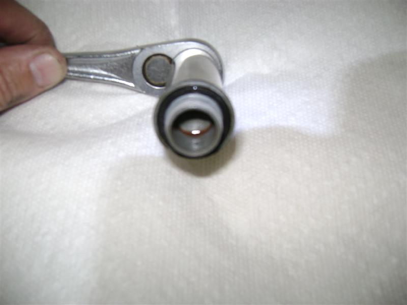

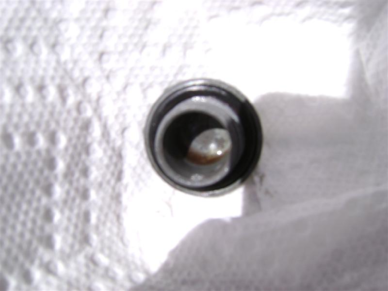

Switched to the 142 main found rust in the cap of the float bowl this is like a sump pit where the main jet draws its fuel from, your filter is not doing it job time for another filter, I looked close at the filter it looks like its just a screen inside?
Is the Honda filter still available if so I suggest you get the Honda filter they will filter out this small stuff if you cant get the OEM filter I suggest a AC Delco inline filter with the paper element they will stop this fine stuff from getting into the carb.

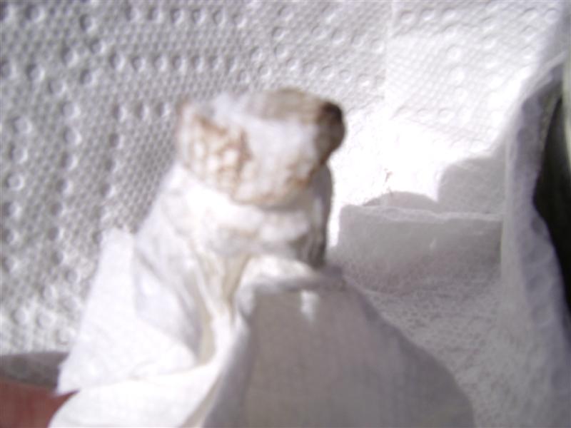

Ran it about 10 min with the 142 jet went back to the 150 when I pulled the cap to change the jet same thing in 10 short minutes their was rust in the cap again.
This micro abrasive will be drawn into your Engine and cause unnecessary wear as well as foul up your carb.

Here is a picture of honda part # 16900-538-024
PostPosted: Mon May 14, 2012 9:20 am
Nelly wrote:
I think Mud and Fully, where just stating that the Napa filter may be a usable alternative if I cant locate a Honda one. I have no problem going with a Honda filter as long as I can find one.
I did some research on the 10 part numbers you gave me. They are actually 5 different part numbers just with and with out the dashes. The 16900-658-004 is a completely different shape and style. The 16900-634-000 and the 16900-538-014 are both a different shape and not sure if it would mount in the same location. The 16900-538-004 is an old part number which was replaced by 16900-538-024 (which happens to be the only part number remaining on the list). This filter looks to be an exact match (shape and size wise) to the factory FL350 filter. This is a fuel filter for late 70's Civic and also some marine applications. So I guess I will have to try and hit up the Honda car dealer parts to find this one.
I'll let you know what I come up with.
EDIT*
Oh cool, thanks for the research, hopefully its a exact fit and reasonably priced.
PostPosted: Mon May 14, 2012 9:46 am
Posts: 185
Location: Aurora, IL
Looks like that part number is also used as a updated # for the FL250 fuel filter. Anyone know if the 250 and 350 filters were the same? The 350 filter # listed is completely different, NLA, and like 3-4 times the cost. Wonder if maybe the flow rate is different?
PostPosted: Mon May 14, 2012 2:55 pm
Posts: 185
Went ahead and ordered 2 of the 16900-538-024. Nobody local that I was able to get a hold of had it in stock. My local Honda dealer said they had some in their warehouse and they would have them there by 7am tomorrow morning. I'll pick them up and let you know if they are what I hope they are.
PostPosted: Tue May 15, 2012 9:52 am
Posts: 185
I got'em! These look to be the exact factory replacement for the FL350 fuel filter. Hoser, I will put these in the mail today. Shoot me a PM with your mailing address again please!
