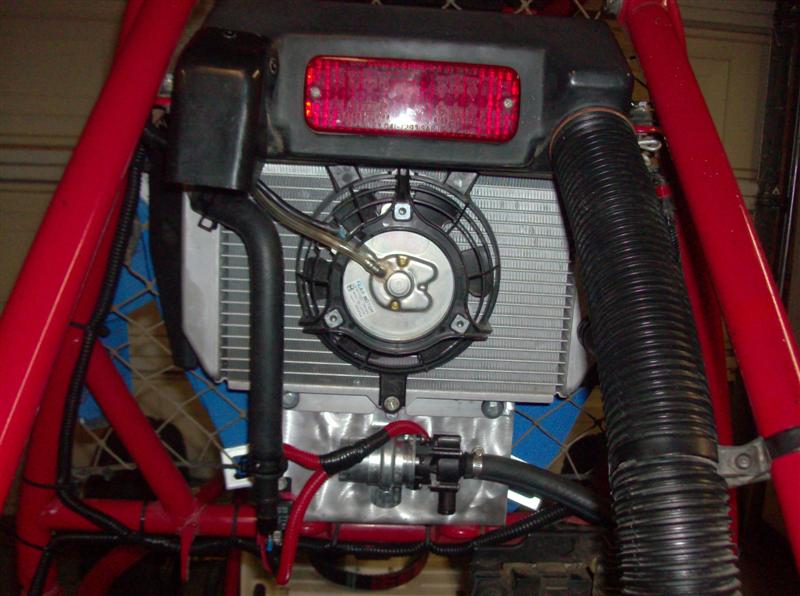

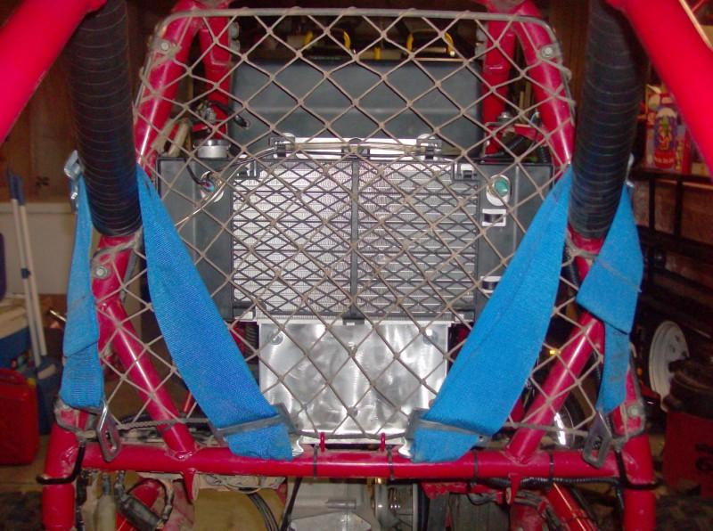

One thing you will want to research before you buy a radiator is how the mounting brackets are arranged to mount it. Myself and jim327 used a radiator out of a YFZ450 Yamaha quad. They have 4 mounting points and its pretty easy to fabricate brackets to mount it to the upper air box brackets and then make a simple bracket to mount it to the seat belt bolts. The Banshee radiator also mounts easily but I don't like having the radiator hanging on the rear down tubes in a position that anyone can bump it, get burned or bend the cooling fins.
I have mounted mine by re-enforcing the upper air box bracket to the air box (bolted not riveted) and drilled holes onto the air box plastic and used large 1" diameter washers to distribute the mounting over a larger area. I had to make sure the radiator has the rubber heat insulating mounts or it would transfer heat into the plastic and melt the air box! I guess I'll find out how well it works once I get my water cooled head installed.
As you can see, jim327 used a nice aluminum mounting bracket to hang his radiator from the upper air box mount.
What type of pump are you going to use? Jim and I both used a Mercedes auxiliary water pump. Pretty easy to find and pretty simple to mount.

Nice looking setup looks like it does mount much better than a Banshee radiator does and the fan is a big plus, I always have recommended the Banshee radiator and the Honda Gold Wing radiators because they are cheap and plentiful hopefully the YFZ450 will eventually be the same, I bet a YFZ450 radiator can be had as cheap as the others if you play the ebay thing long enough..
PostPosted: Fri Mar 05, 2010 2:54 pm
I got it in like new condition for 50 bucks plus $10 for shipping! I'm pleased with it. Chomping at the bit though waiting for the new heads to be finished. At the time when I was acquiring parts, all the Banshee radiators looked the they went through hell and back!
My only issue I might have is the thermostat switches. The fan switch doesn't activate until 216F. From what I hear, the YFZ450's have an issue with overheating due to the high switch settings. I have seen aftermarket switches that lower them on temp down to 177F. If I have an issue this will be the route I will have to go.

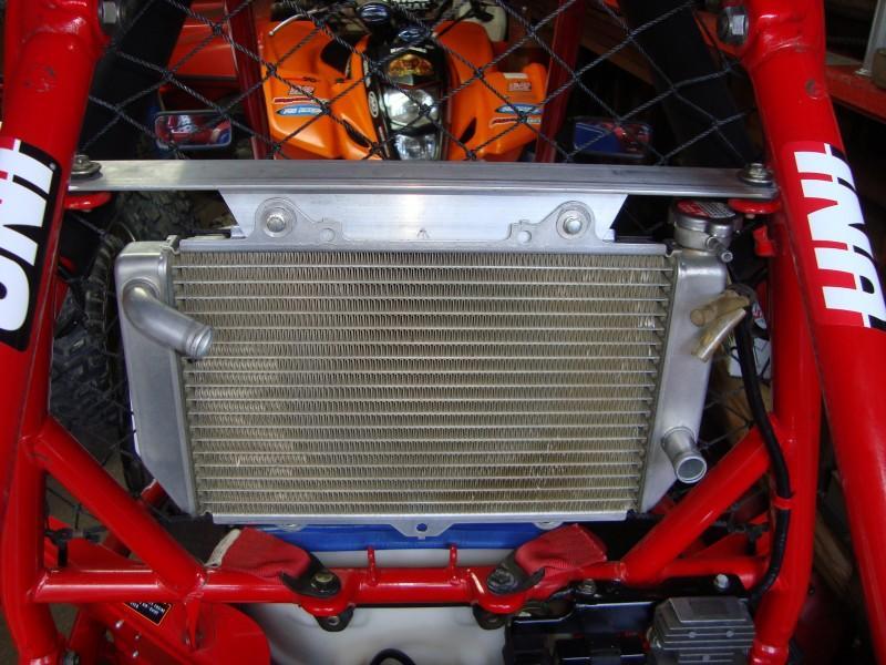

PostPosted: Sat Mar 06, 2010 3:43 am
Mozzy, core width is approximately 375
Core height is approx 195
Core is 38 thick
total height (mounting brackets top to bottom) 254
Hard to get an exact measurements as it is already mounted with a fan in the way. Here are a few pics so you can get an idea of how large it is in the frame.
You're welcome, any time,
