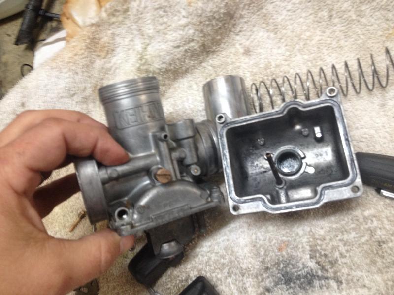

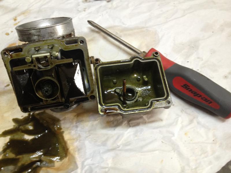

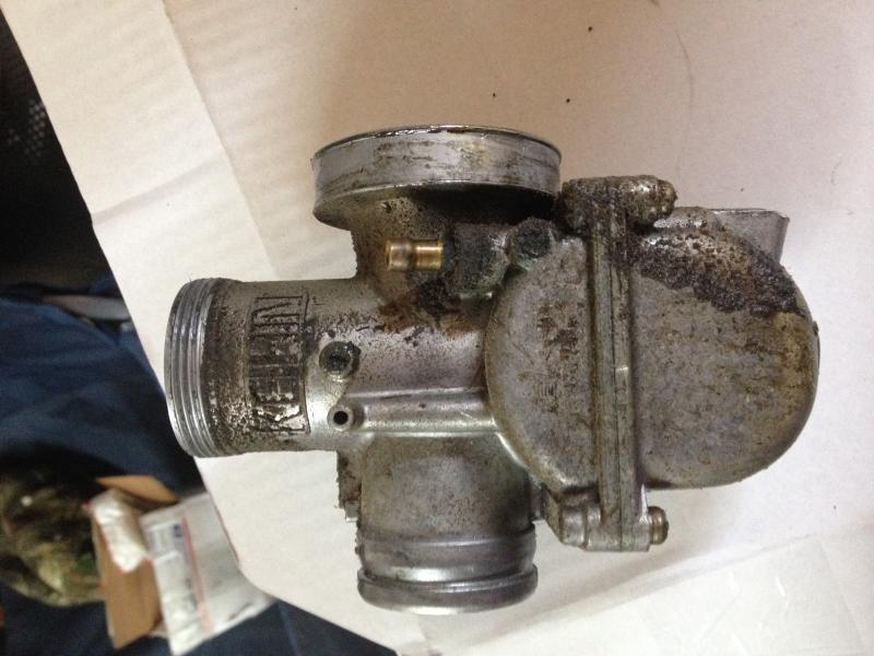

first thing was to soak the carb. if you have never tried pinesol as carb cleaner you should. I will never use carb cleaner again.
the carb was jettet with a 140 main
45 slow
35 slide
and the needle is on the top clip.

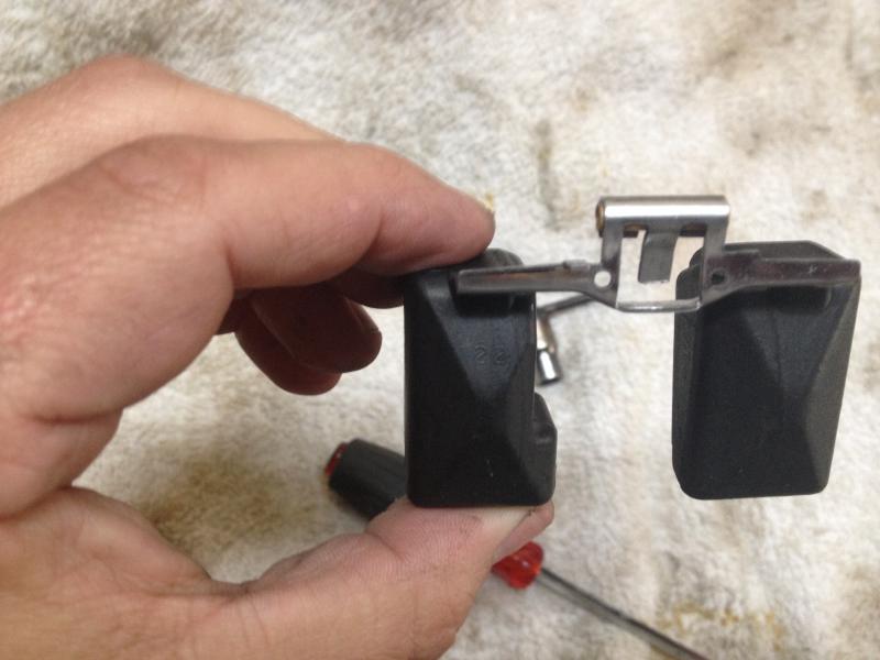

the fuel lines were disconnected and the T-fitting had the return line blocked off. How can I tell if I have the correct float?

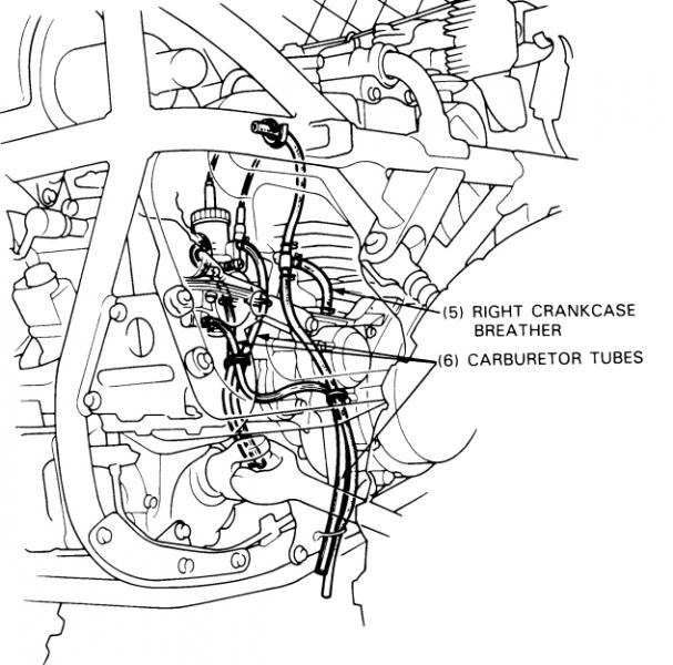

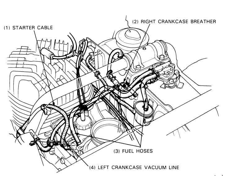

Looks nice, the 350 service manual will show the factory hose routing.

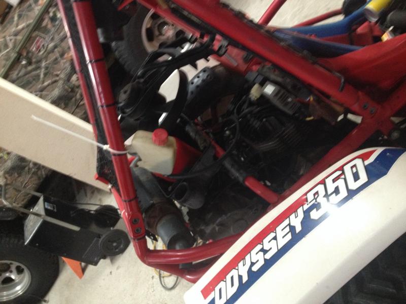

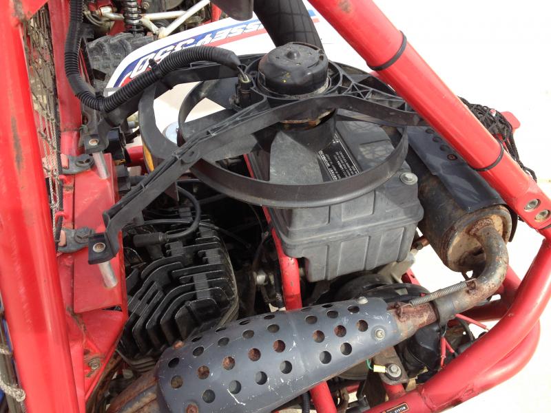

the fuel tank was rusty so I dropped it off at the local radiator shop to be vatted.
I did start it though. I used an old coolant bottle from a Polaris to supply some fuel.
is there an on line version?
found it. I see some people run clear lines where can I find them and what size?

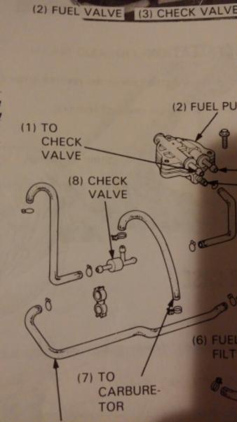

PostPosted: Mon Mar 24, 2014 10:27 pm
Posts: 939
Here is a pic that was sent to me to figure mine out.
PostPosted: Mon Mar 24, 2014 10:41 pm
350 fuel line diagram.
Fl350 Fuel Lines Routing

Lemon or lime juice in a pan on the stove is the best carb parts cleaner I have ever seen, will have to try the pinesol thing you use it straight?
PostPosted: Tue Mar 25, 2014 11:21 am
Posts: 379
Location: Monette Ar
ChrisV wrote:
thanks for the help. ill try to make a report on the progress once i get the tank back.
i used it straight. Google pinesol carb cleaner and you will be amazed at the results. You really don't even have to take the carb apart although i do. Just look at my pics and that is onlt a 3 hour soak. Not to mention the shop smells clean!!
