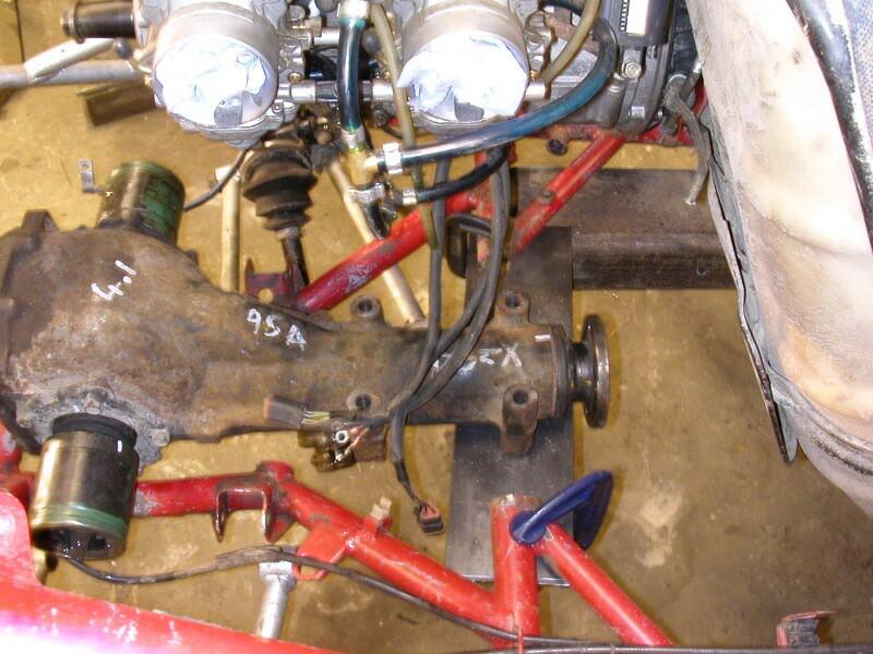

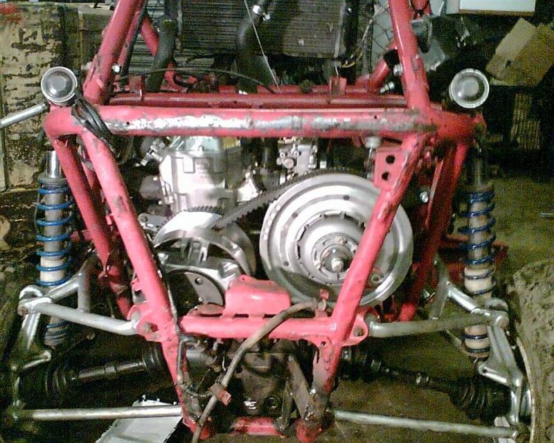

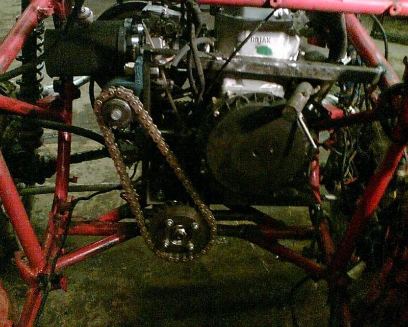

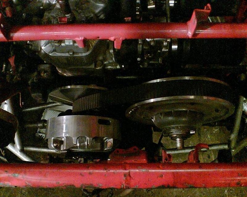

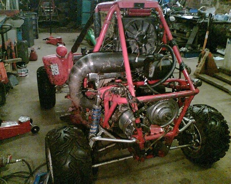

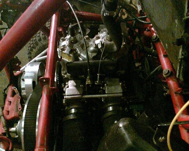

I thought I would post some pictures of my project in progress, pilot with rotax 793 Engine with RER, subaru impreza limited slip diff and fiddle/ cutter brakes. I will post more pictures if there is any interest.

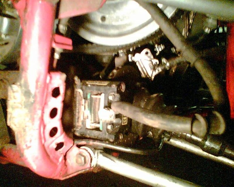

More photos.

Jesus Leegb I saw your progress on mini-buggy. Very nice work =) Seems to haul ass from the video. Hows the speed with the extra weight of the subuaru diff?

There is no extra weight over a standard pilot, I am not using the pilot transmission and the rotax motor (( Internal Combustion Engine ? )) is light, no balance shaft, just the bear minimum. The reverse is very light just a few extra wires a button and maybe a micro chip :-) I do not understand why more people no not use engines with RER.

I am told the Engine has 138 bhp? It feels fast :shock: I need the cutter brakes to steer because the front tyres bearly touch the ground under acceleration.

There are 2 pickups to tell it when to spark, basically it switches over to the other pick up, the Engine backfires and runs in the opposite direction, The 2 stroke oil pump, water pump and cvt drive are designed to work with this type of Engine. It has a lower rev limit in reverse.

The Engine is the same as a ski doo 800 but I bought 2 used engines with carbs CDI (Capacitor Discharge Ignition)/ecu,s exhausts and everything else to run them, and 2 brand new spare engines, they were used in hovercraft in the James bond film die another day but were taken out of the hovercraft before they were blown up.

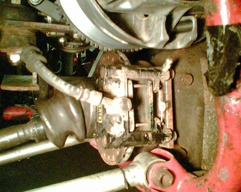

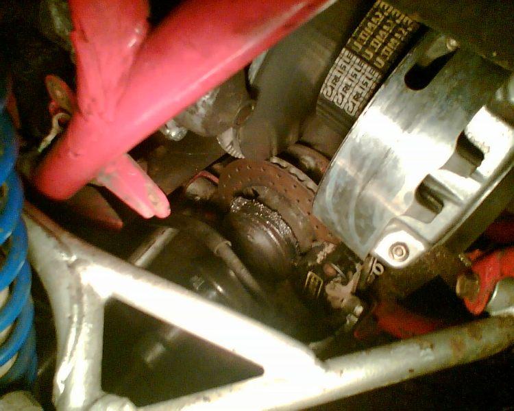

some pictures of fiddle/ cutter brakes, discs mounted to inner cv cup.
