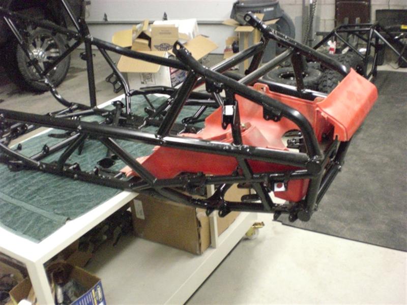

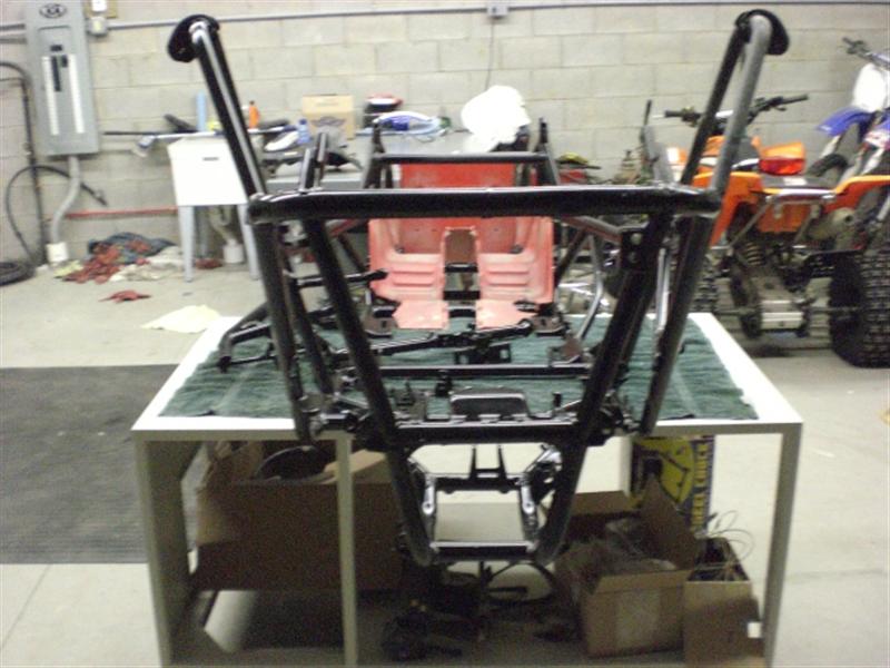

PostPosted: Sat Mar 15, 2008 7:52 pm

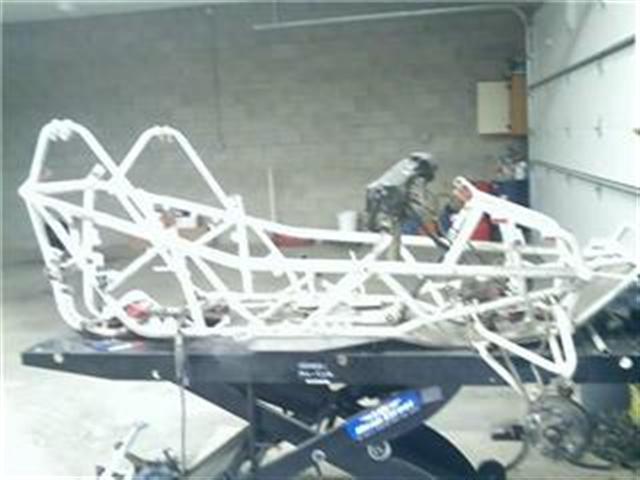

I only have a few pics but i thought i would start a thread on the rest of the pilot.. here are some from when we got it.
File comment: frame stripped

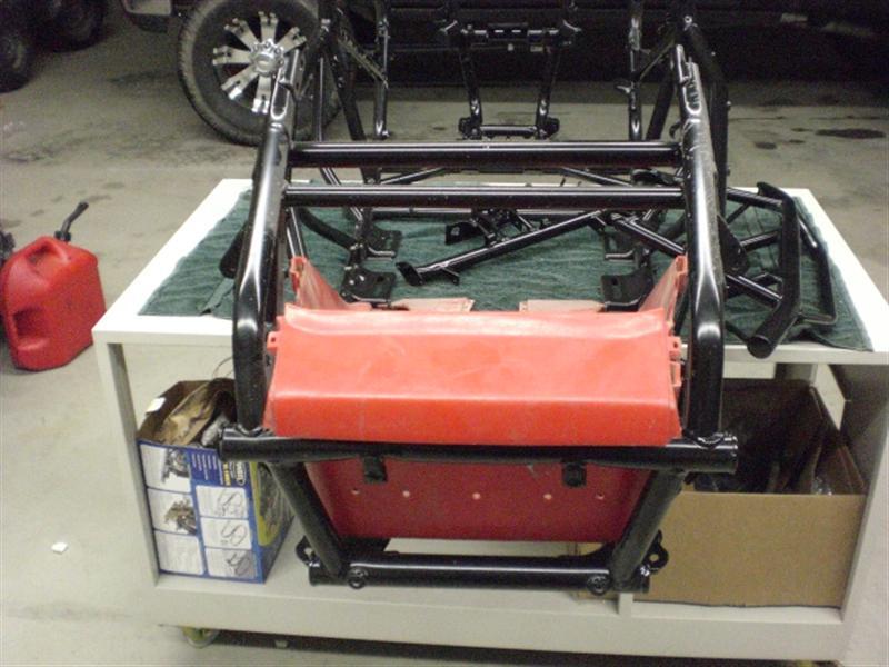

PostPosted: Sat Mar 15, 2008 7:56 pm
back from the powder coaters.

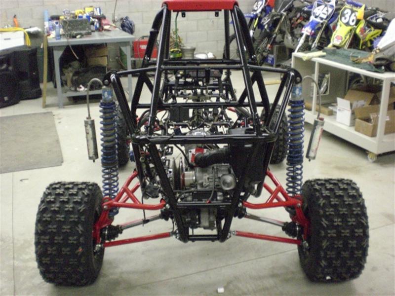

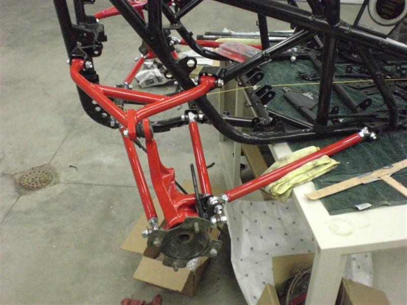

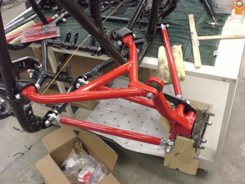

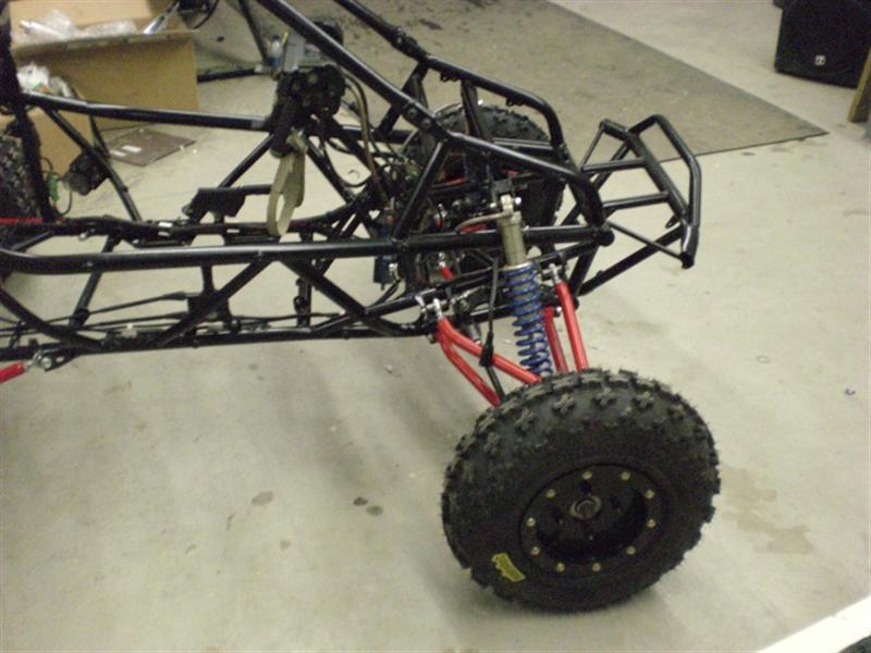

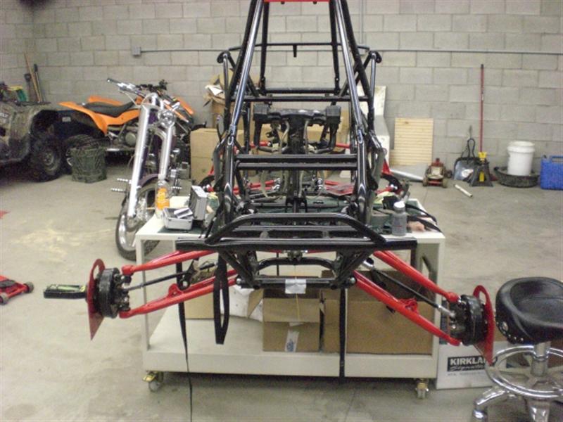

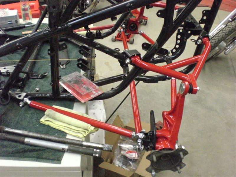

PostPosted: Fri Apr 04, 2008 1:42 am
here are some pics with the suspension bolted up.
PostPosted: Fri Apr 04, 2008 1:44 am
a few more.

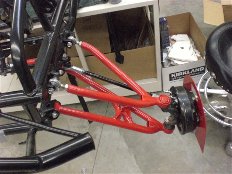

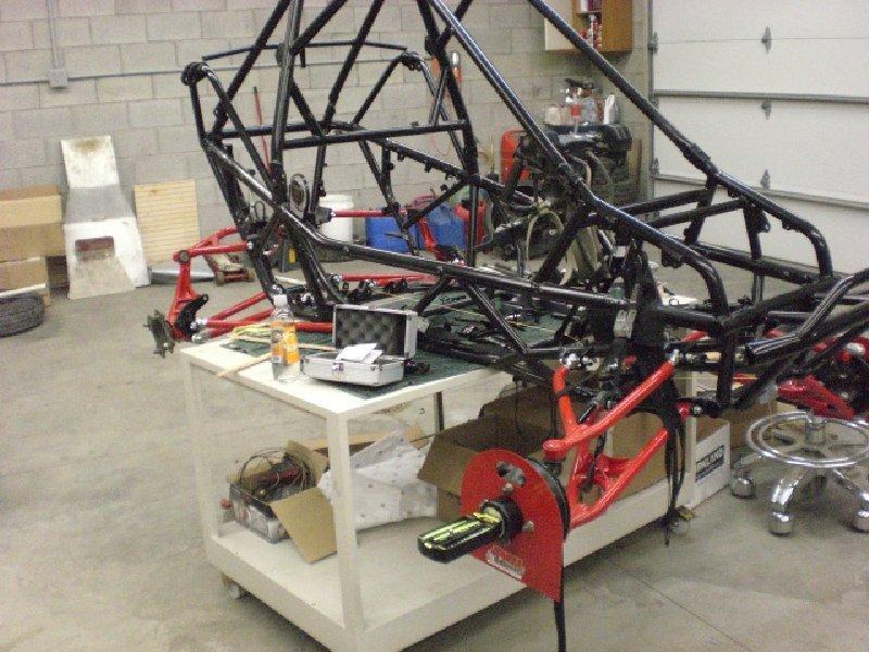

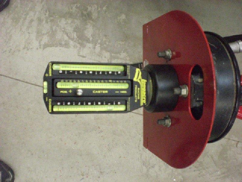

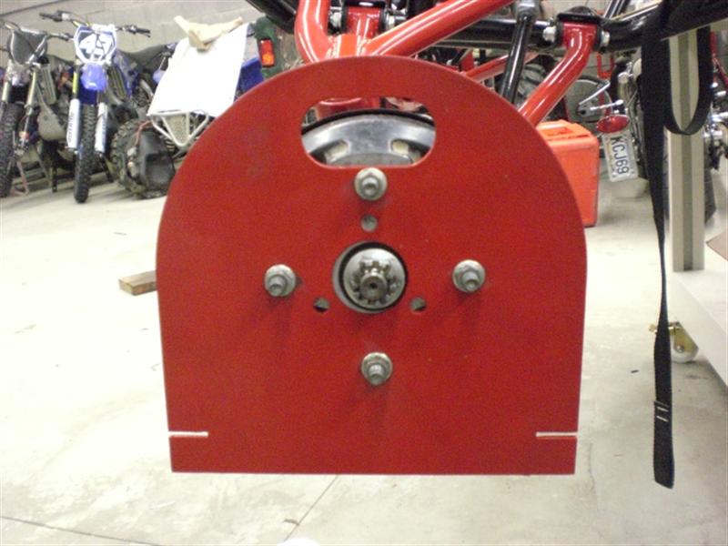

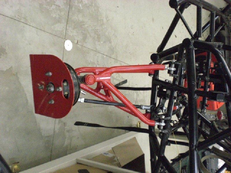

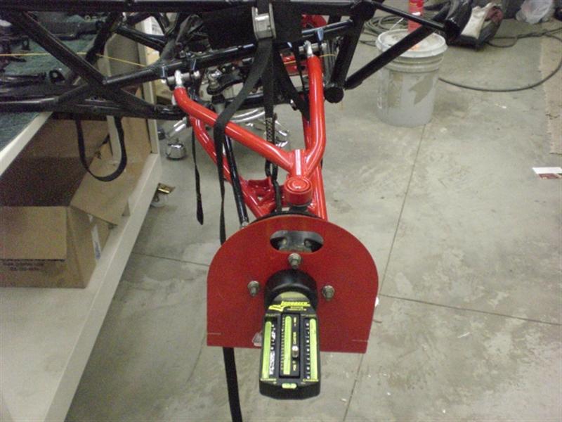

PostPosted: Fri Apr 04, 2008 1:50 am
we used toe plates for go carts and just drilled the front bolt pattern from the Pilot into them, and used a stock car camber and caster gauge with a magnetic adapter to set the caster and camber.
File comment: toe plate
File comment: caster camber gauge
PostPosted: Fri Apr 04, 2008 2:17 am
Thanks for posting up those pics AFC.
I am very interested in your wheel alignment'it is the stage that I am at now.
I have big understeer and is Moocho annoying at the races.
I have Neil's ex LT500 Stadium Pilot.Could you post up a how to,with specs etc for a dummy level like me?
I can't wait to get the steering sorted out so that I don't lose those few seconds & posi's/lap!
Would be much appreciated.
Cheers Baz.

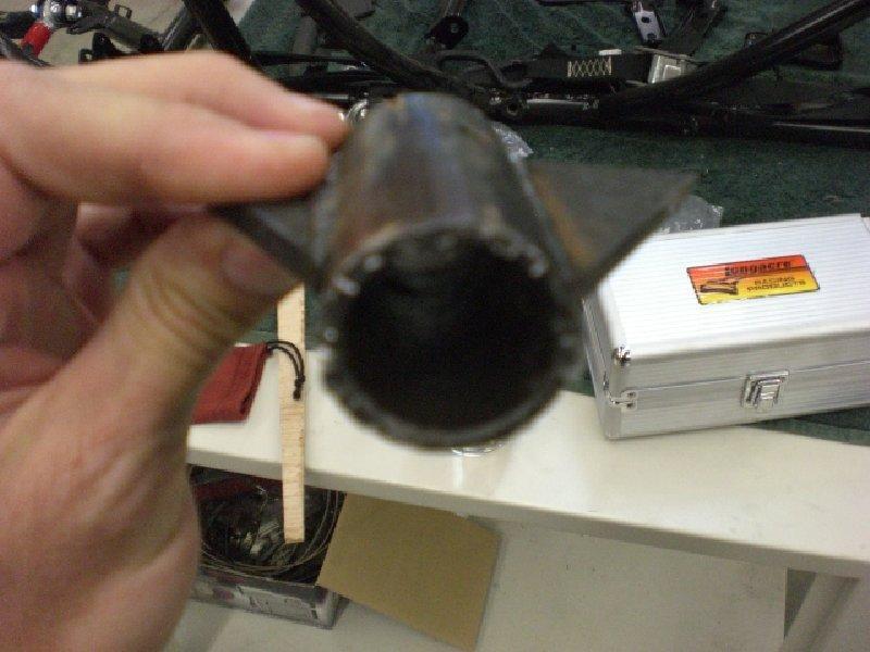

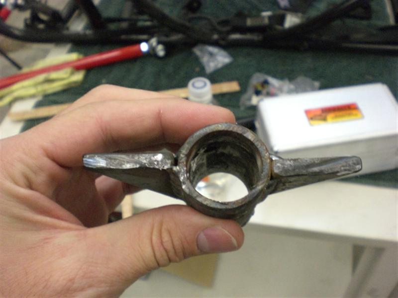

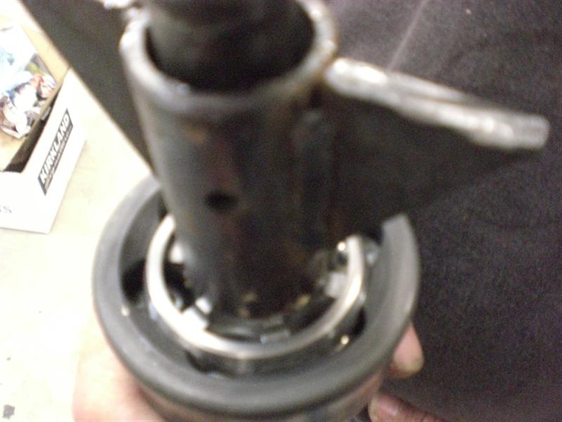

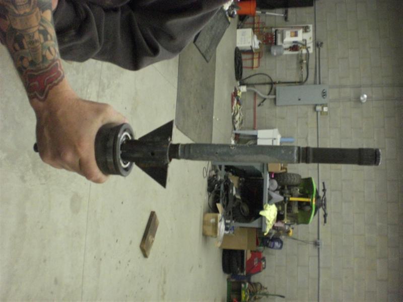

we had to get axles shafts from ATVR Marve from Tuff never got back to us, when we got the Pilot it only had one axle so we found a used stock one on ebay, and since ATVR only sells the shafts in sets and this is a first gen long travel from 92 or 93 we decided to use both new axles shafts and leave the old one for a spare, now to get the outboard CV off the axles, we made a tool, we used two people to do it, one to hold the CV and axle applying constant pressure trying to pull them apart and the other to swing the hammer (make sure you trust the person with the hammer) the tool worked great it only took a couple whacks.
File comment: tool
File comment: top
File comment: bottom
File comment: on the shaft

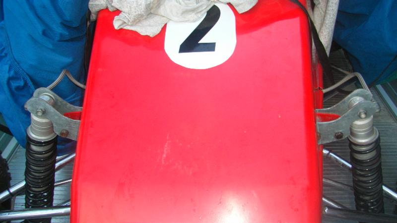

Baz there are 10,000 ways to skin a cat, the best i can do is let you know the way im doing it, but for sure there will be people that disagree.
by understeer do you mean when you go into the corner the front end pushes to the out side of the corner?
im only asking this because i know it by pushing or loose, pushing is when the front end pushes towards the outside of the corner and loose is when the back end comes around and the car wants to spin out, in my opinion the Pilot has a ton of rear percentage the Engine, trans, fuel, and radiator, are in the rear heck the driver sits more towards the rear, i have never had one on scales but i bet its close to 30% front and 70% rear, with that much rear % its always going to want to push no matter what, the three ways i would get it to turn are, horse power break the rear wheels loose and feather the throttle, or diamond the track enter the corner wide and dive down towards the apex, or run in low and grab the rear break to slide the back end, i just don't think you can ever get the Pilot to just roll smooth through the corners. just my 2 cents and im no expert by far or don't claim to be............
I will show how I set up the front end and rear end when we finish it up, in the earlier pics we where just getting it in the ballpark.

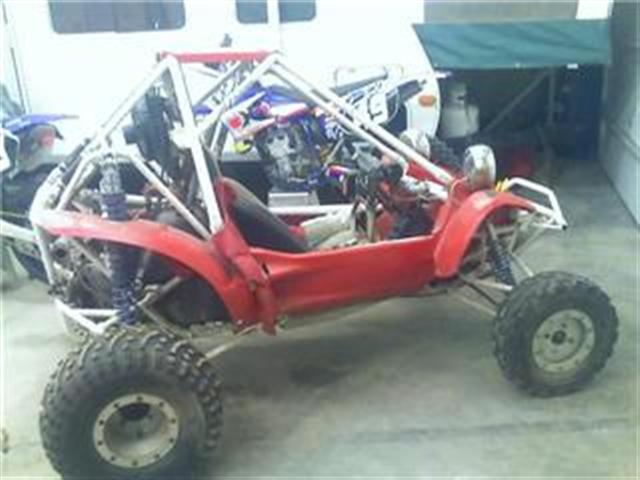

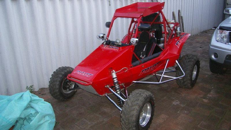

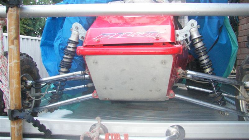

Here's a pic of my 1st Stock 89 Pilot.

here are a few pics of the progress, we just stuck the shocks and wheels on today to see what it looks like, the suspension is not set yet so please don't tell me its not straight its not done yet.
