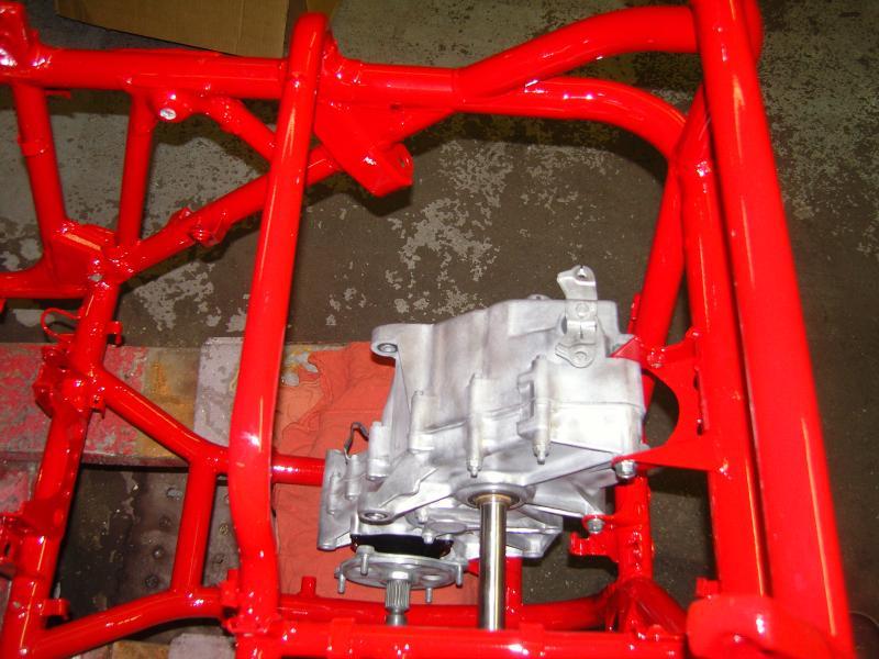

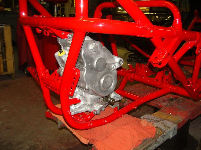

File comment: I spent an entire day last weekend wire brushing the transmission by hand. Tried cleaner's, wire brush on drill and sand blasting. All did not work, the drill and sand blasting was leaving deep grooving.
File comment: In the end a small wire brush the size of a tooth brush and a lot of elbow grease did the trick.

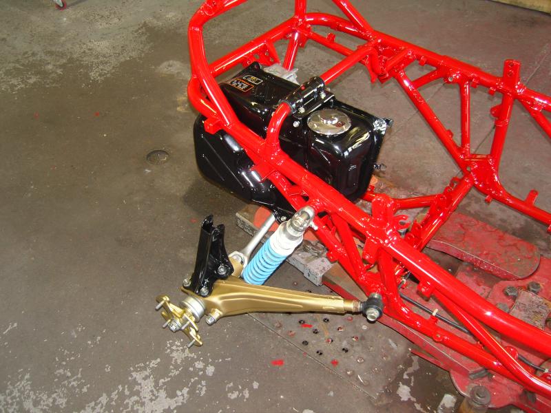

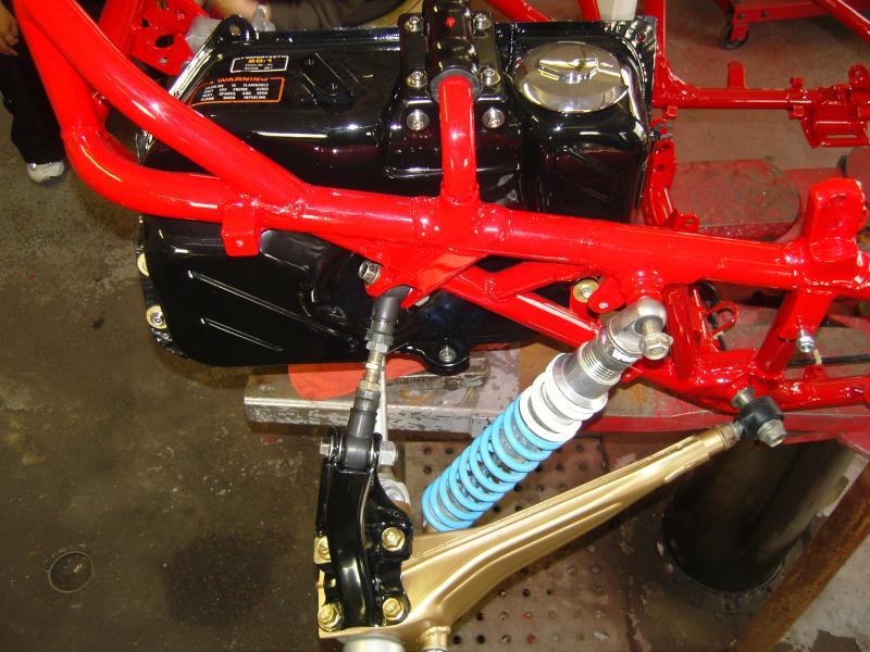

File comment: Gas tank is double lined, brand new gas cap (lock set), three coats of black and three coats of clear, original decals, new honda wheel bearings and seals in the axle carrier.

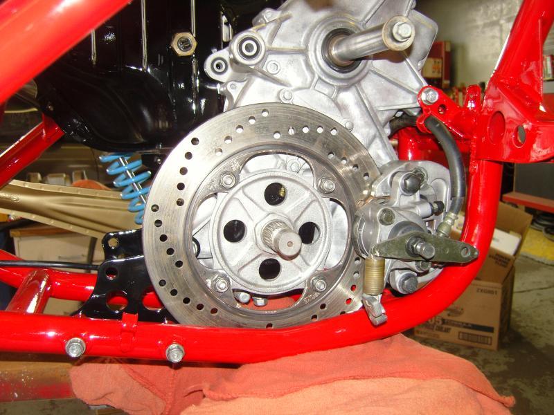

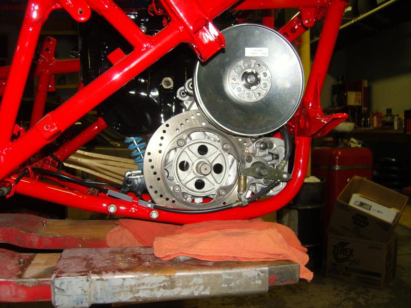

File comment: Total rebuild on pilot caliper for the odyssey. Done today.
Caliper done getting ready to install e. brake bracket.
If you look at the bracket you can see what the caliper looked like before brushing. All honda parts.
File comment: Caliper and rotor installed.

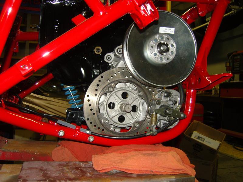

File comment: Comet driven clutch and pilot e. brake cable installed.

really nice... I didn't realize that the pilot caliper would work on a 350
PostPosted: Tue Jun 23, 2009 6:33 pm
nice that you added a fuel sensor. Looks really good
 Post subject: fl350 restore
PostPosted: Tue Jun 23, 2009 11:16 pm
Posts: 1090
Hello, my son is going to be 16.
The pilot caliper bolts right on, the only difference between the two is the e. brake bracket and the mounting bracket.
I had to use a pilot brake cable, the whole on the e. brake arm at the caliper where the cable hooks up is smaller on the odyssey.
The pilot brake cable is 5 or 6 inches longer which is a bummer but I think it will work out ok.
The advantage is you have the brake indicator, the return spring and you can hook a brake switch to it. Which I am doing at some point.

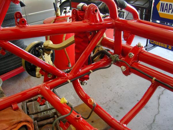

I am putting a pilot steering wheel on, I first did this to get rid of the cables and go to all hydraulic.
I decided to use a pilot wiring harness and add all the switches and sensors, hope it goes well not even close to that stage yet.
I painted again all day today, I have almost everything painted.
I will put the front suspension and hopefully the motor (( Internal Combustion Engine ? )) in tomorrow.
I will post some more pics when I have some actual progress and more parts put on. Hopefully tomorrow.
PostPosted: Fri Jul 03, 2009 7:40 pm

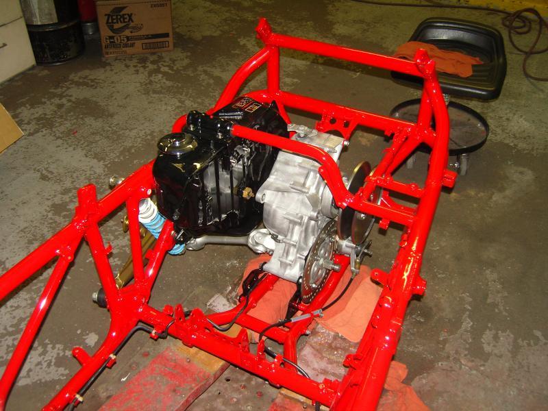

Steve -hate to mention this but that tank will need to be removed to install the motor (( Internal Combustion Engine ? )) to trans brackets,you'll never get the bolts in them at all.Love the fuel sensor and Pilot harness, please keep us up on the install and useage of them, are you going to use a Pilot wheel with it, I do think the splines are the same on the top of the steering shafts,meaning the 350 can be used on the Pilot wheel.Are you going to fab brackets for the Pilot electrical systems (which mount on the frame)or eliminate them?
The tank will slide back in there after you tighten and install the brackets and trans-no worries at all there.

Hello Gregg, yes I know. I am going to turn the bracket by the fuel tank around backwards, I have checked and it will clear with no problems and in the future I might not have to remove the tank to pull the motor (( Internal Combustion Engine ? )) or trans.

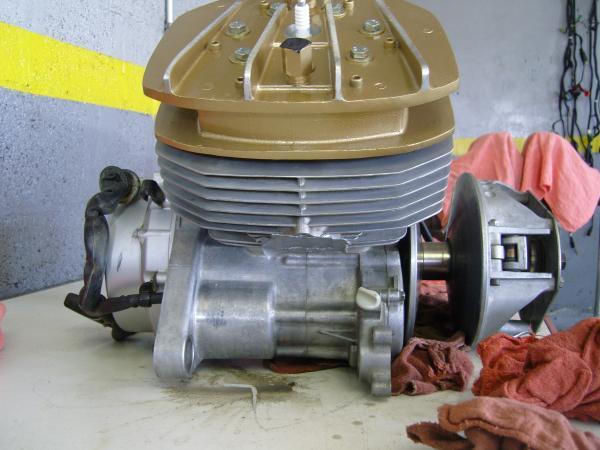

File comment: My Hillside Honda head.

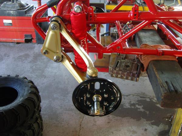

Thank you Thank you, Mudbogger.

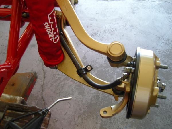

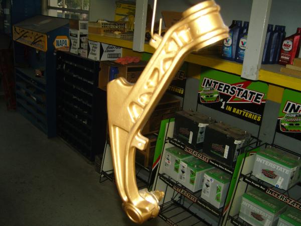

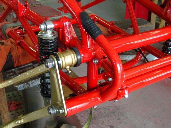

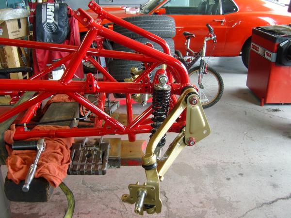

File comment: Front end together with new Speedchaser bushings and shims.
Awesome stuff Speed, thank you.

File comment: My wife worked her butt off cleaning this motor (( Internal Combustion Engine ? )) with a wire brush and a tooth brush.

I especially love the OEM bolts and how the heck did you find OEM rubbers for that front bumper?They are very very hard to find-nice touch indeed!!!!
Are those rubber dust seals on the front end new, they look it!!!

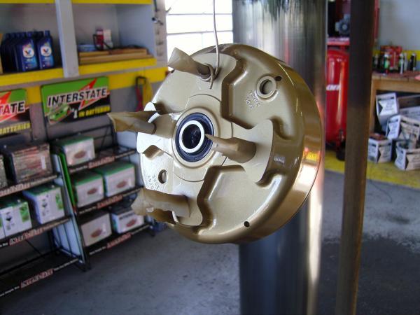

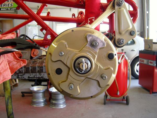

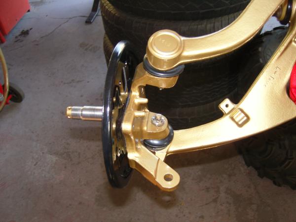

Good evening, are you talking about the seals for the J arm bushings. If so no they are not new I wish, I have been scrubbing everything with brake cleaner and soap and water. Lots and lots of elbow grease.
I got very lucky and was able to get a brand new front bumper kit off of ebay.
Thank you, I told you I was a perfectionist almost to the point of insanity. Actually I am driving my self crazy wanting everything just right.

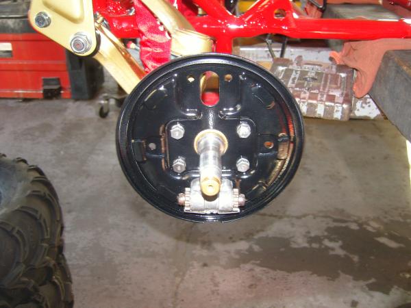

For example I painted the front brake backing plates and then sanded the contact area where you mount them, I put a little silicone on the mounting surface and lock tight on the bolts and installed one of the backing plates. I then realized that some of the surface I had sanded was overhanging the mounting surface, thought about just touching it up but I could not get to the whole area. So I paced the floor for about five minutes and then decided to take the dam thing off and paint the exposed surface area. I had to clean all the silicone back off and clean the bolts again, see what I mean.
One thing that amazed me is that the ball joints are in excellent condition, no play very tight. Did Honda make good stuff or what.

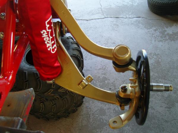

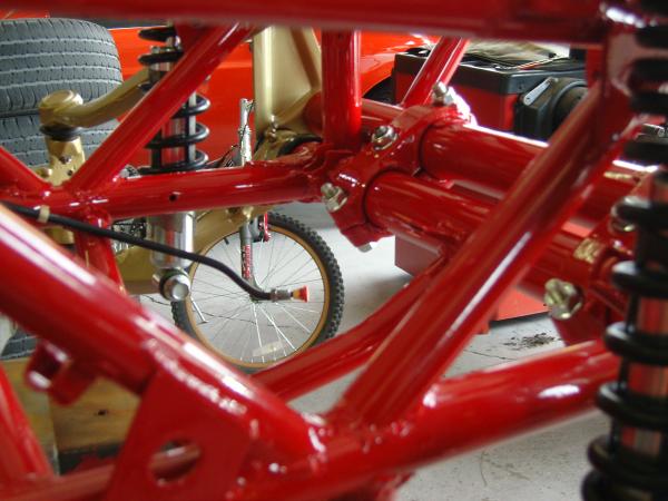

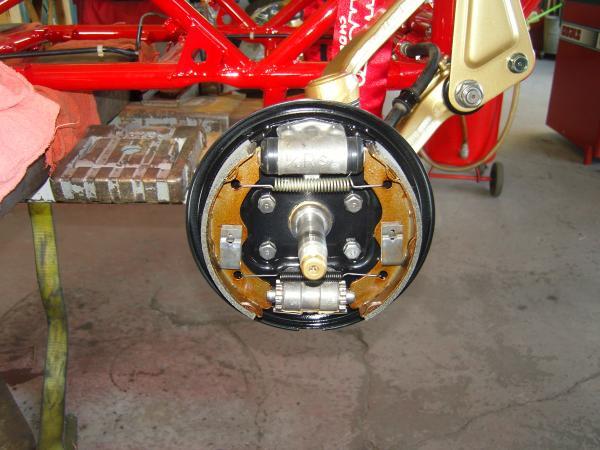

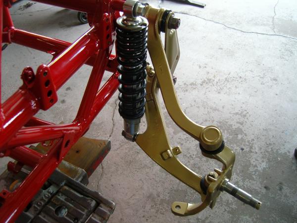

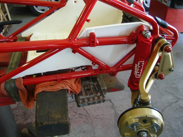

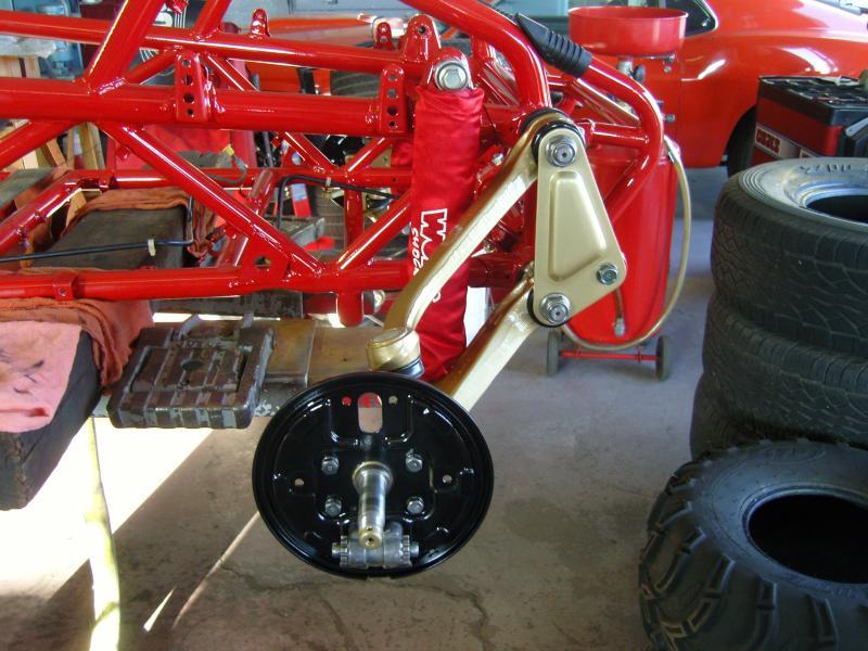

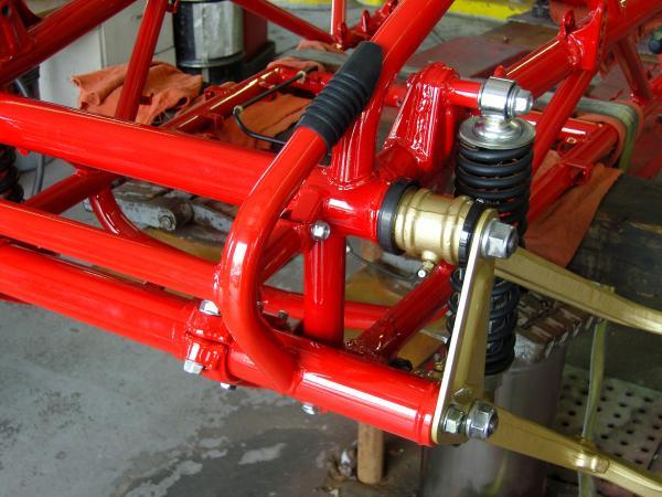

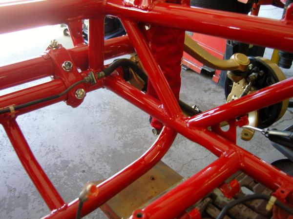

The front suspension and brakes are all together, I am putting the steering parts and column in today.

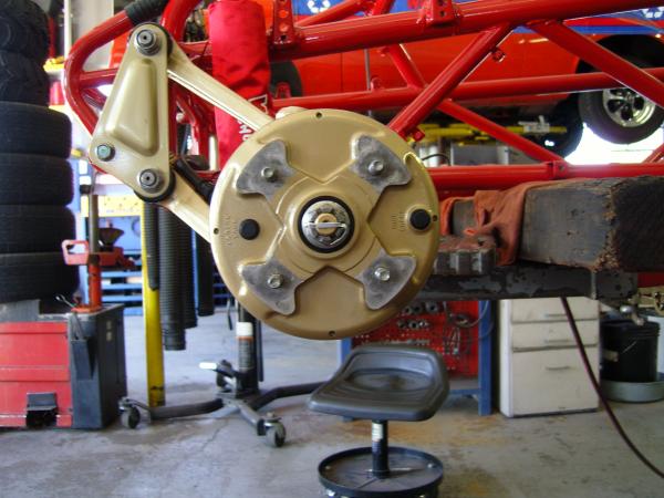

PostPosted: Sun Jul 12, 2009 10:01 am
Posts: 1090
More pics.

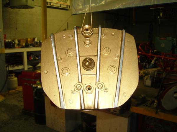

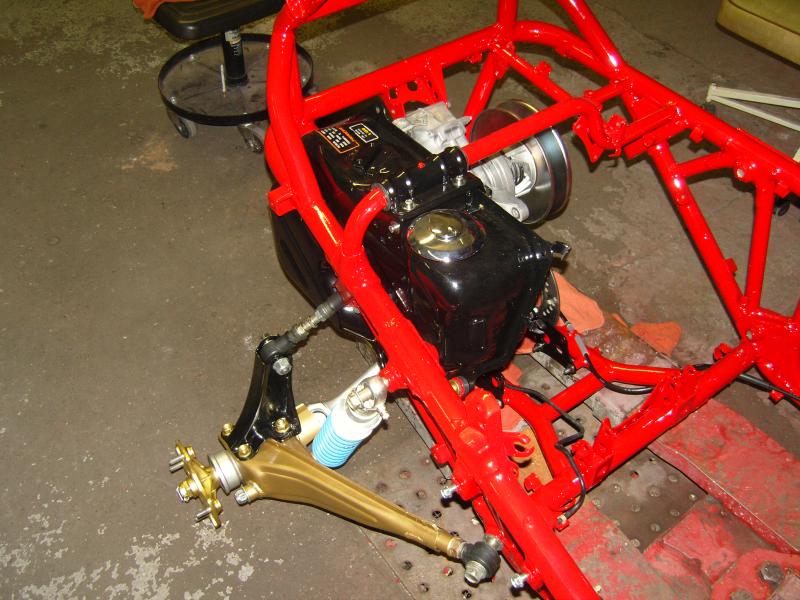

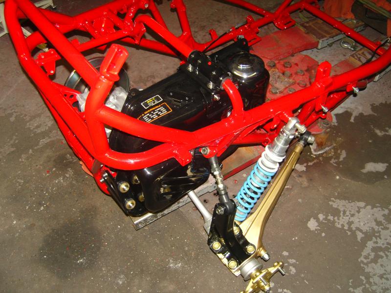

PostPosted: Sun Jul 12, 2009 10:02 am
Posts: 1090
Three more.
