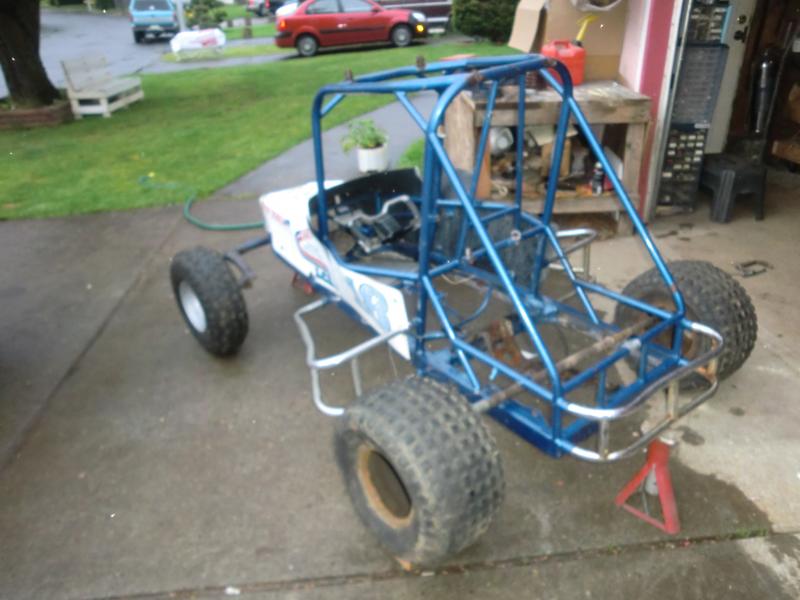

sorry guys... you are going to hate me!! I know I know, you guys would rather not know about something like this. Bear with me...
I already dissected it. I am really looking forward to all the plans I have on this.. pics and captions...

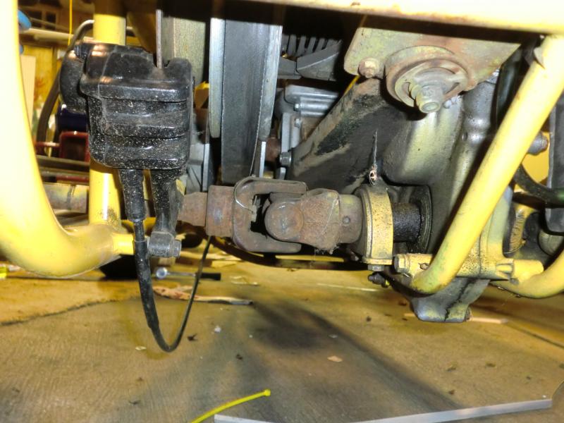

U-joints in the rear. They were all buggered up. Looks like they were stripped out and somebody welded them to the axle. also cracked around the ears and those were also welded. There was no saving this and I had to cut the axle. I would not run these.

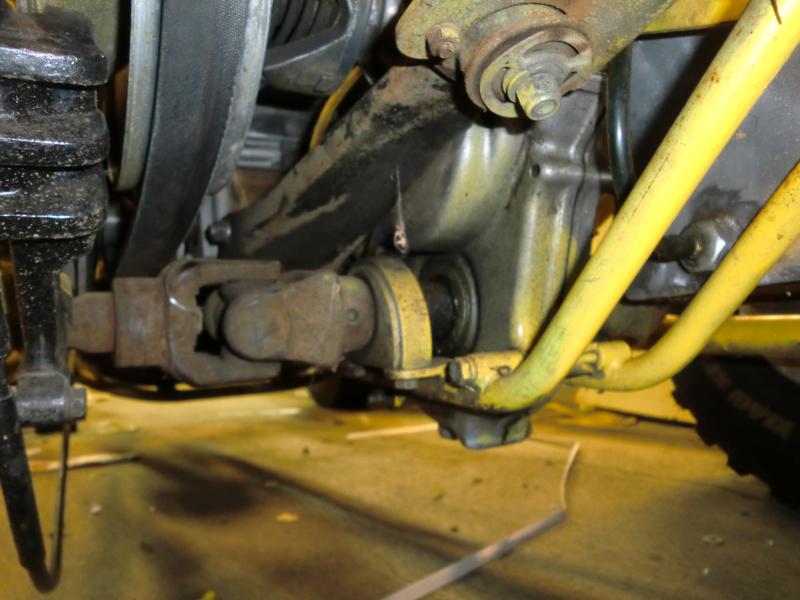

PostPosted: Thu Apr 19, 2012 1:49 pm
Posts: 714
my yellow car has the trans in the center. Not sure what they did but it's in the center.
As far as splines axle for this swap is rare to find. You may have to make/machine your own using tractor parts using the axle you have now that fits the trans splines. Or start with stock axle that fits the splines and sale me your setup. Pretty sure you can find the joints at a tractor supply store. Going to have to have machine work dome though regardless.
Also posted pics of the axle kit you would need to center the trans. Problem is you cannot buy them anymore. But should give you an ide what you will have to make or have made. This kit is almost like the one in mt yellow car. But mine had the tappered axles and not just straight axle. From what I gather the tapper is stronger.

PostPosted: Thu Apr 19, 2012 2:12 pm
As far as splines axle for this swap is rare to find. You may have to make/machine your own using tractor parts using the axle you have now that fits the trans plines.
They centered it to get more suspension travel, move the U joints inboard more and center no idea why they also didnt move the frame rails in and actually make more suspension think you can get 6-8" travel out of that car?

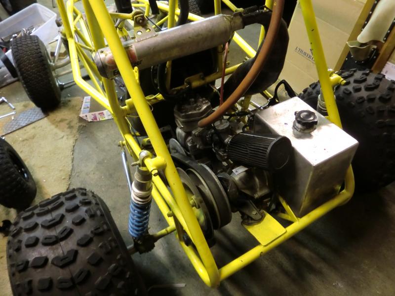

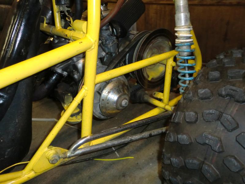

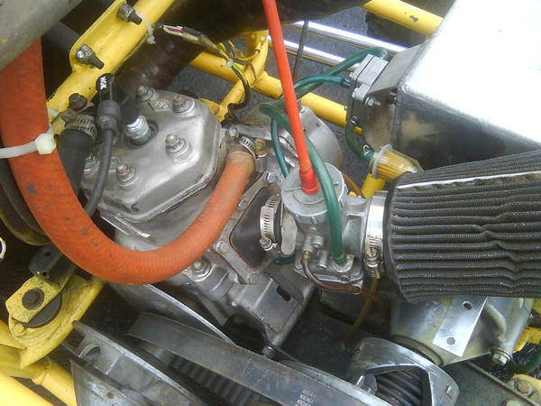

Only driven the car a few times in front of my house and a field. It does go well but the works shocks need rebuilt or charged. As far as travel goes I have no clue. I got that blue car that I got those parts from you to finish next. Then I am taking all I learned and putting it into this yellow car. Here is the only vid of it running right after I got it home.
http://www.youtube.com/watch?v=dCMuwGDdJKY" .".." ."..
PO said when he took the Engine apart it did not have gaskets. Then found out that these may not used gaskets or something like that. I got scared and parked it until I can find out more and have it gone thru. I have talked to calvin from CPI. He also said this Engine should run very well.

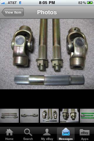

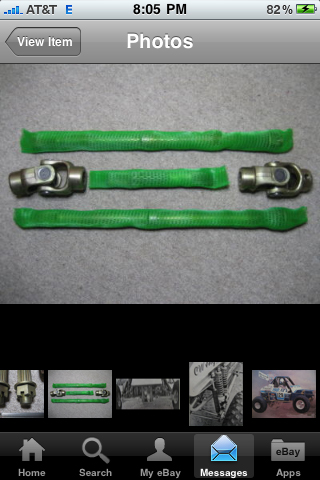

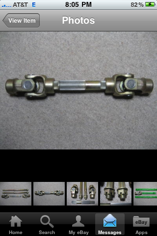

Here are some pics of the axle kit you would need to center the trans. Problem is you cannot buy them anymore. But should give you an ide what you will have to make or have made. This kit is almost like the one in mt yellow car. But mine had the tappered axles and not just straight axle. From what I gather the tapper is stronger.

Are any of the joints good and not welded on? If any of them are good I should buy them from you for spare parts if I break any on my yellow car. Probably never have the chance to buy them again. So is any of the joints/knuckles good? What about the axle sections? Although they look different than mine the more I look at them.
Tie rods are the flat track style. I need to other style. Can you ID what brand shocks those are?
I missed your post above that shows the parts for sale. So when talking out of post above you know why. LOL
I can tell you a challenger person out there will need those axle parts. There was a guy a few weeks agaon that busted one. I think he ended up selling his ride for he could not find the part. Here is the thread. It was not long ago maybe PM him as I will to. Cannot remember what he needed but I think you have it?
viewtopic.php?f=5&t=9597
Do you have the axle that goes thru the trans?
