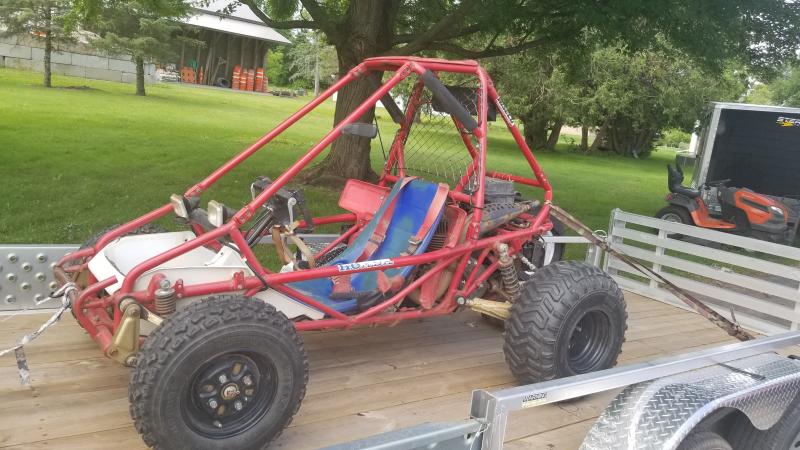

Hello everyone, just purchased my first Fl350r last week. I've been scanning the net for things I had questions on and most of the time ended up finding the answer on these forums, so I thought I'd join. Cheers

Wow, thanks for the info. After looking it over I have found these things already. 1 Front bushings are shot 2 Brakes are almost non existent 3 Parking Brake doesn't work 4 Tank is in great shape 5 Needs tires and rims all the way around 6 Needs right side mirror 7 Tie rods are not so great 8 Rear suspension might as well be a solid axle with the way the rear shocks feel 9 Rear brake light needs to be wired up 10 Has the original tool box and tools 11 Front bumper is bent and welded 12 Looks like the po wired up a tether switch on the steering wheel?

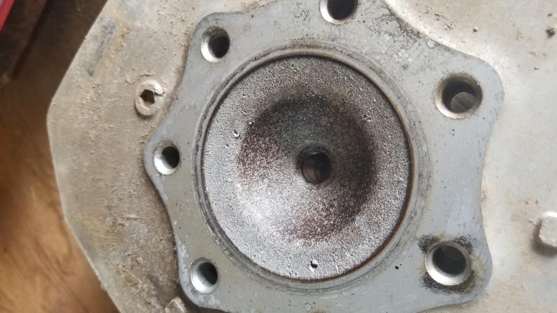

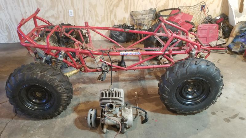

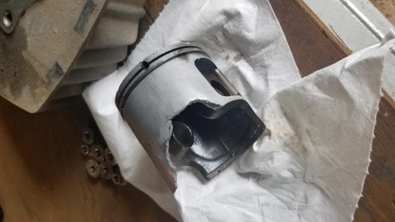

Got some work done yesterday and today, much more to come b4 she is ready to rock.
 Post subject: Re: New to the forum
PostPosted: Wed Jul 22, 2020 6:18 pm
a little JB weld, that piston will be good as new LOL
hard to believe it ran long enough to do all that damage
