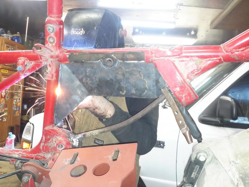

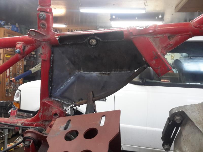

A lil more progress
File comment: Had my buddy Doug weld it in place I'm still a learning welder lol

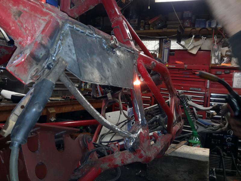

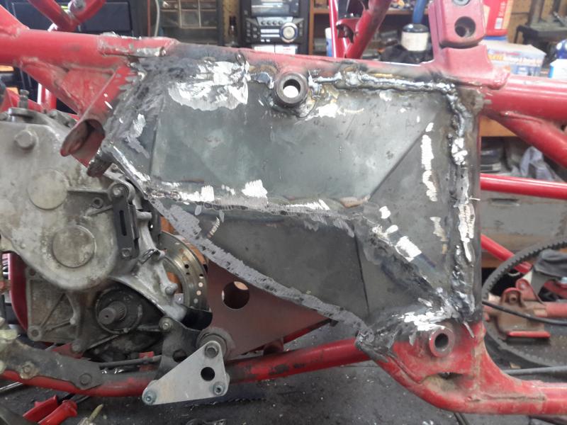

Done lol I had the confidence to weld today so I finished up the project myself looks great grinded more after last pic capped the inner frame with washers welded in

Nice to see someone show their actual welds in a photo. The more you weld the less grinding you'll have to do. Kudos, man! :-) Is that with gas or flux-core wire? I'm certainly no expert, but be sure to clean-up the joints before you weld with a grinding wheel or tiger-paw pad. Get rid of that mill scale, and wipe it down with acetone or non-chlorinated brake kleen. Contamination kills a weld, even MIG.
Thanks making my own header pipe I need one tho do you have one, and it's a gas welder,
