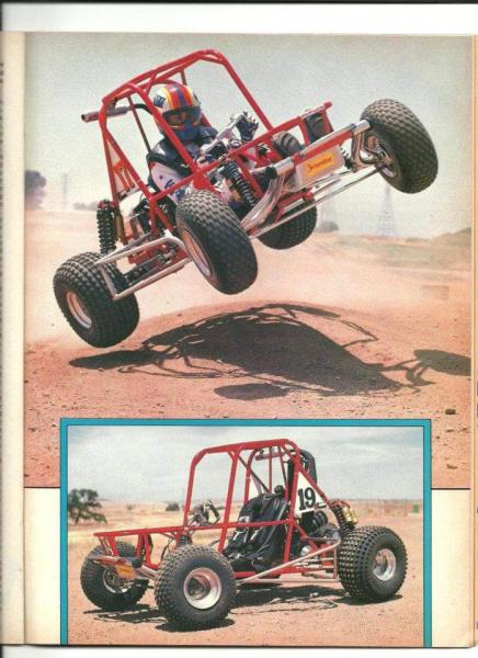

This is my first fully suspended FL250. The reduction case was centered allowing for 12 inches of rear wheel travel. Won a lot of races in that car. This photo is from Borona Oaks raceway.
These pics were cut out of Dirt Wheels magazine, they did an article on this car.

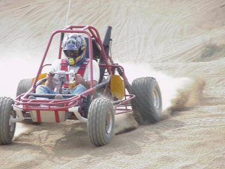

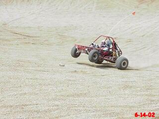

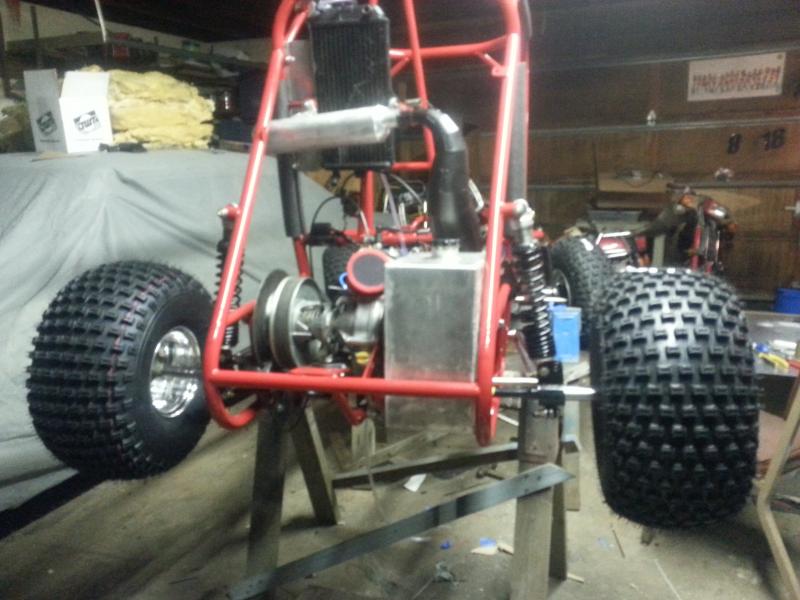

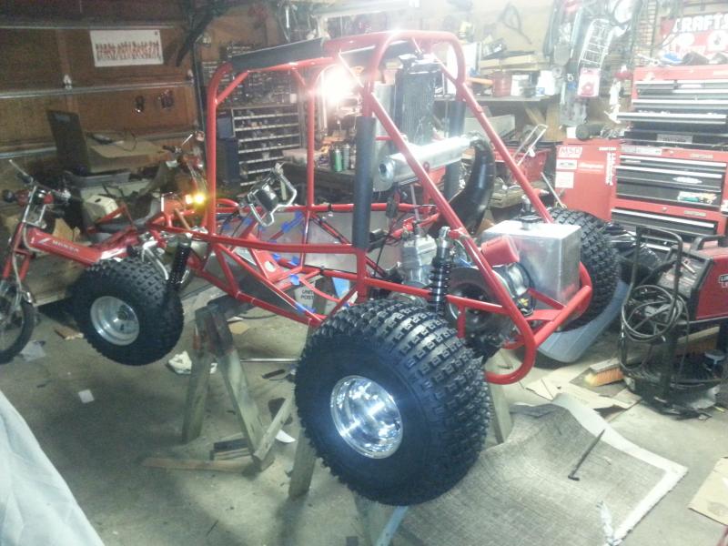

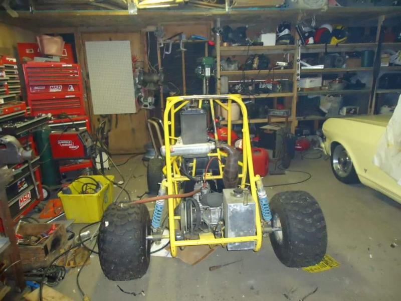

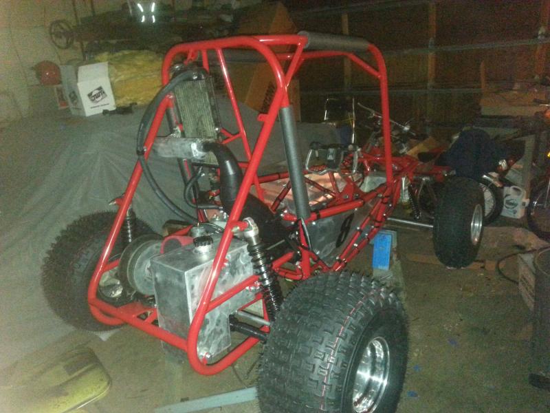

Old thread yes. But I got to add my class 3 car here. Almost done with restore. 360cc Cammex Engine. First pic is not my car but one close to it.
