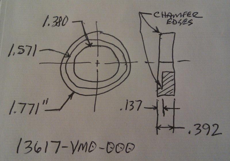

Thought I lost one of these for my rebuild, but got lucky and found it in my giant box of Oddy hardware. Decided to put the vernier calipers to it in case I ever needed one in the future, since these are discontinued.
See attached sketch with dimensions. Looks to be made of mild steel. No sharp edges on that stepped side, since an o-ring sits in there. OD should be very smooth since it seals on the oil seal.
Also, when installing...the stepped side of the collar faces the o-ring and crank (in). Its crank, o-ring, then collar.

Good idea thanks for measuring up and documenting, its #13 in the pic correct?

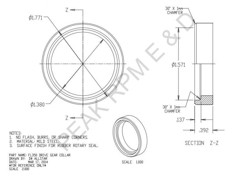

Yep, its #13 indeed.
Here is a print for it (better than my chicken scratch on an envelope). I got bored on a mundane Monday morning tele-conference and created it in Creo. :-)

Excellent thanks for that, I did a screen cap for those that does not want to fire up their PDF feader like me lol

Also, i have absolutely no intent in making any of these available. ''Peak RPM E&D'' is my home biz name under which my personal CAD license is registered. That's all.
