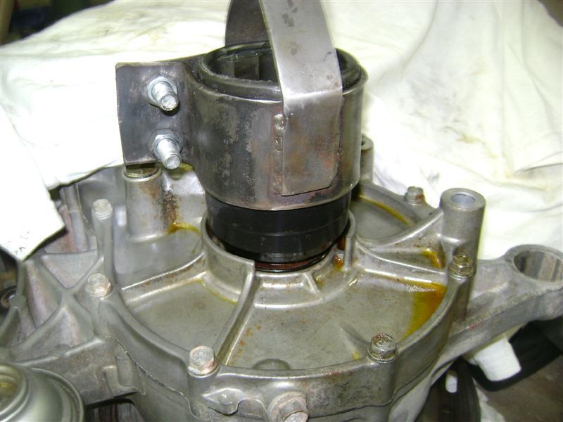

Pilot Axle Stub Removal - CV Puller By hoser.. Innovation in progress
Since I have the Engine out of my Pilot waiting on parts I wanted to touch up the
frame paint where the sand has sand blasted it off and remove my axle stubs to
clean and lube up with clean fresh grease so I fabricated this puller.
42220-HE0-013

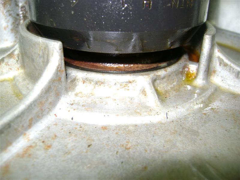

PostPosted: Sat Mar 27, 2004 3:46 pm
As I suspected they need cleaned and greased again, its been 3 years, don't know
why Honda didnt install a seal on the stub shaft guess I will put a bog gob of
silicone at the very end to help seal it up.
PostPosted: Sat Mar 27, 2004 3:47 pm
I had to weld a small bead on the inside so it would fall into the groove on the
stub shaft and not slide off the end, the puller seem to work pretty good don't know
if my slide hammer has enough weight to remove one that was rusted in real bad.

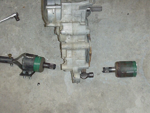

PostPosted: Sat Mar 27, 2004 3:49 pm
Once one side was out I used a 3/4" brass rod about 8" long to TAP the other stub
shaft out .

That is a great looking tool, I could have used that during my recent rebuild. I never could get one axle out.
Can you take a picture looking directly into the "hole" where the axles go in the tranny. With both axles out does it go all the way through??
PostPosted: Sat Mar 27, 2004 8:31 pm
Joined: Sun Dec 21, 2003 12:17 am
Posts: 192
Yes the trans drive is hollow. that's how you are able to pull one stub and tap the other one out from the other side
PostPosted: Sat Mar 27, 2004 8:43 pm
Posts: 407
Location: Orlando
now that sucks..I didnt know it went all the way through....I had one out and couldnt get the other out. Didnt realize you could tap the other one out..... live and learn I guess

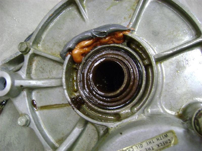

PostPosted: Sat Mar 27, 2004 9:10 pm

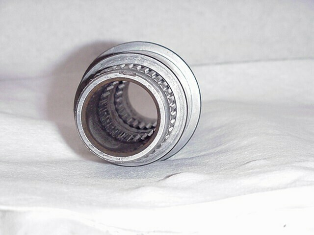

Yes it is hollow all the way through here is a picture of my old final shaft , I whish you
would have asked when you were working on yours I have had mine apart 4 times
now and been inside the trans twice.. http://pilotodyssey.com/800reasons.htm
When I put mine back together this time I greased inside the final shaft and all of the stub
shaft but the last 1/2 by the CV cup then I put a big bead of silicone around that area so
it will form a seal and help keep the grease in and moisture out.

PostPosted: Sat Mar 27, 2004 9:58 pm
Posts: 407
Location: Orlando
Do you think there is room for a rubber seal like a ball joint boot over that joint?
How much space is there between the tranny case and the end of the CV housing? Looks like at least .25 inches or more. That should be enough room if a boot with the right diameter is available.
Can you measure the diameter of the CV joint housing and the shaft coming out of the tranny
I'll do some searching for a boot of some sort

One possiability would be use a large diameter "O" ring bihind the hub to seal the stub shaft.
PostPosted: Sun Mar 28, 2004 9:22 pm
Posts: 407
Location: Orlando
maybe a big neoprene or viton washer that would seal around the shaft and then compress up against the tranny housing. It would wear as that axle turned but could be changed every season or so as a maintenance item.
Hoser how about some measurements since you have yours apart?????
PostPosted: Fri Apr 13, 2007 10:26 pm
Update: I took the trans apart again the silicone seal works perfectly...
