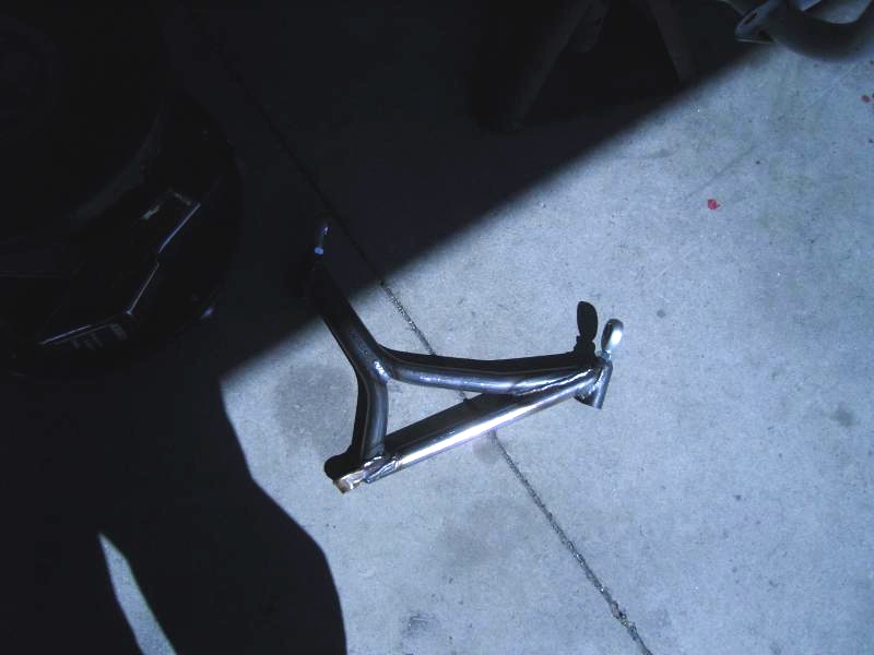

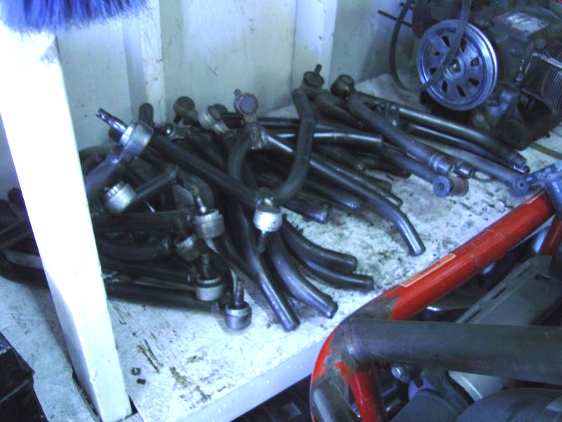

PostPosted: Sun Apr 12, 2015 12:21 am
Posts: 1088
Here are some pictures of finished front upper and lower arms Dave had sitting on the shelf, I felt at least 6 or 7 of the ball joints and every single one that I felt were nice and tight.
File comment: b
File comment: b
PostPosted: Sun Apr 12, 2015 8:42 am
So how come the ball joints on the shelf didnt get loose when they were welded? No wonder the kid brags up his Pilot they have all the best parts installed how could he complain when the best parts are kept and the lose ball joints are pawed off on others. This is exactly why I question using weld in ball joints in the first place IT MADE NO SENSE THEN AND MAKES NO SENSE NOW unless your the source of the parts and are hand picking the ball joints going on your own machine.
HUGE difference when your select fitting parts on something mechanical.

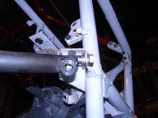

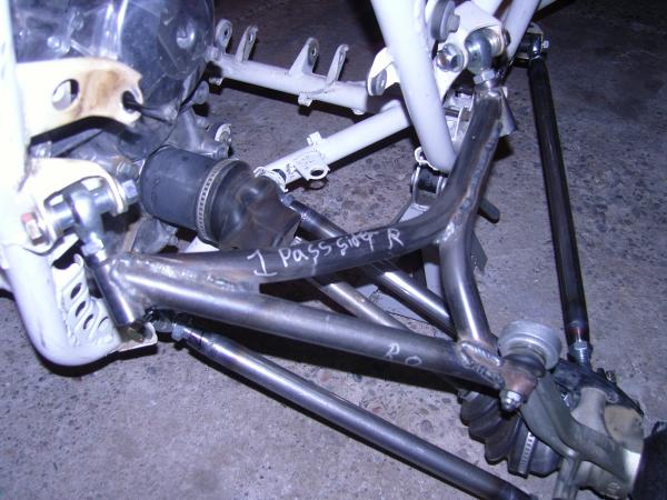

PostPosted: Sun Apr 12, 2015 1:58 pm
Posts: 1088
Here are some pictures of the rear upper swing arms Dave was going to send me home with but they would not work right (Thank goodness), he was also trying to leave the rear radius arms in there stock location. Dave ended up walking away from the rear and working on the front. This was on Saturday 3/21/2015.
Saturday night and Sunday morning it was bothering me about the rear radius arms being moved, I knew that they were supposed to be moved. I had decided that I was going to ask that they be moved if Dave was not going to move them.
On Sunday 3/22/2015, when Dave got back to working on the rear he was sitting there looking at things with a what do I do look on his face (I had not said a word about the radius arms) and I TELL DAVE, I SURE WISH YOU WOULD DO WHAT YOU ARE THINKING YOU NEED TO DO. Dave looked at me surprised I think because I knew what he was thinking and the next thing you know the rear radius arms are being moved.
After moving the rear radius arms the rear upper swing arms still would not work right, Dave tried and tried to adjust the rear and get it to work but it would not.
DAVE SAID SOMETHING MUST HAVE HAPPENED WHEN HE MADE THEM!!! Referring to the rear upper swing arms that would not work right.
As luck would have it, Dave tells his son to go over under the bench (opposite side of the garage from where the other arms are at) and get some arms that are wrapped up in a towel. Wow, low and behold the arms are what I paid for to begin with, made with 4130 and with weld in bungs. Dave tells me he had made these for himself and in the end charges me $100.00 more for them.
After installing the new rear upper swing arms the rear suspension now moves to Dave's liking and I could see that they allowed much more travel then the other set. I kick myself for this but no measurements were taken as to the amount of travel. My fault I should have asked for measurements on travel, really mad at myself for that!!!
I think one big problem with Dave's kits besides everything else is that the swing arms or at least the rear upper swing arms DO NOT COME OUT THE SAME EVERY TIME!!! I think Dave believes that close is good enough because it is all adjustable. I think different.
File comment: -
File comment: -
File comment: -
File comment: -

PostPosted: Sun Apr 12, 2015 3:15 pm
So does Dave-Co normally relocate the rear radius arms further forward or not?
The Wolfskill LT ARV Racing Pilot the rear radius arms are located further forward if you need measurements how much further forward let me know.
Cant believe Dave-Co is not using a jig to build his arms not what a expected from a aerospace fabricator who has welded on every Space Shuttle ever flown, its just not adding up just like his kid coming here talking out his ass telling everybody not to judge the work before its assembled and tested heck you have not even received what you agreed on and paid for yet HOW CAN YOU ASSEMBLE AND TEST, makes no sense.

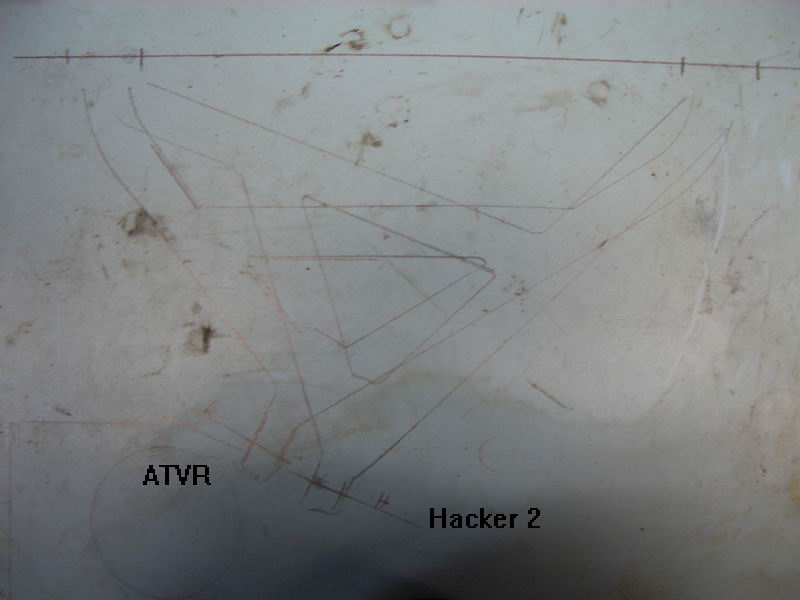

PostPosted: Mon Apr 13, 2015 3:08 pm
Forgot to add this provided 13.875 inches of travel full compress to full extended at the up rights ball joint. This also uses ATVR axles and the stock radius rod point of attachment modified by moving pivot to the exterior of the stock mounting point and adding a bracket. This moved the upright rear ward and changes the I-rods length from front to rear. This also relocated the ball joint center line to the arm pivot center line out 1" verses the ATVR arm. The New arm configuration allows the shock to be bolted up in the stock location for more than a 1 to 1 ratio on the shock. The lever ratio now become variable thought out travel this to say the shock shaft will move at a ratio of the vertical wheel travel.
Adnoh
