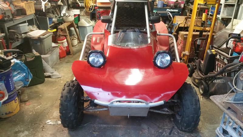

Again bit more forum content.
Thought I'd put this here because of ol pics of hood bonnet when raw black.
So after ? Years,finally decided to pull my finger out and geter painted Red to see what she looks like?
Came out ok,but just need to finish with some dual centre stripes,maybe Stang style and either in straight Black or in Carbon Fibre vinyl sheet?

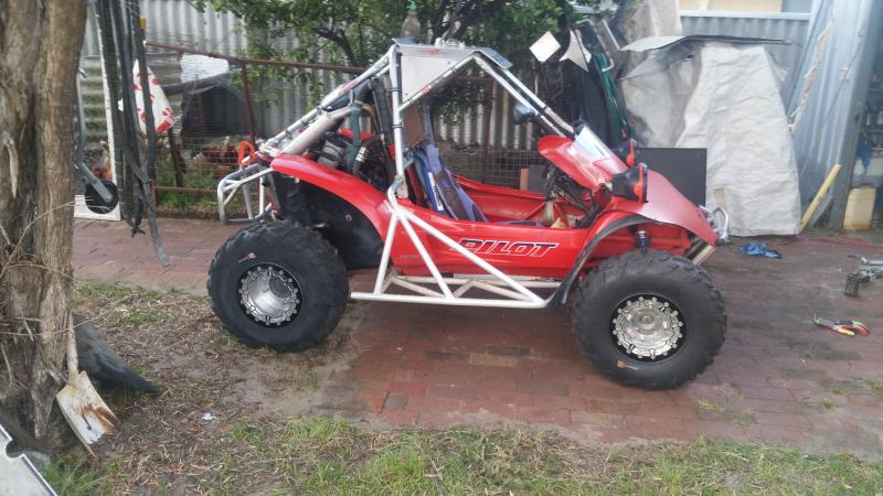

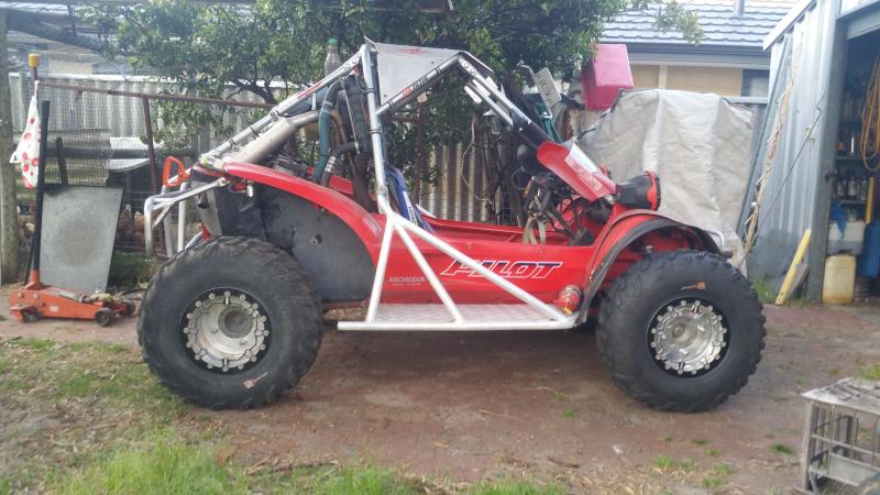

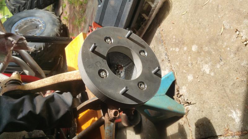

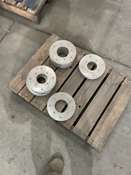

Made up some wheel adapters to utilise a spare set of 26" Polaris/Revolt wheels for extra height/clearance where I camp.Mate of mine jet cut some 25mm/1" alu plate.
Fronts 4x110 to 4x156 pcd,and rears 4x130 to 4x156pcd.
Much better stance now but will have to mod the front nerf to clear full lock.

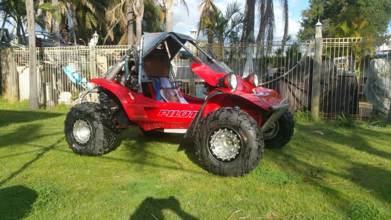

 Post subject: Re: AC550Pilot
PostPosted: Sat Sep 16, 2023 9:30 am
Took off the racing nerfs today ready for clearancing the fronts for full lock.Not sure if I'll put them back on as I don't race anymore and much prefer bugcamping at the beach dunes.Tested driving in backyard and surprised not too much difference in turning especially when it's all at slow pace and will be easier at speed outdoors.

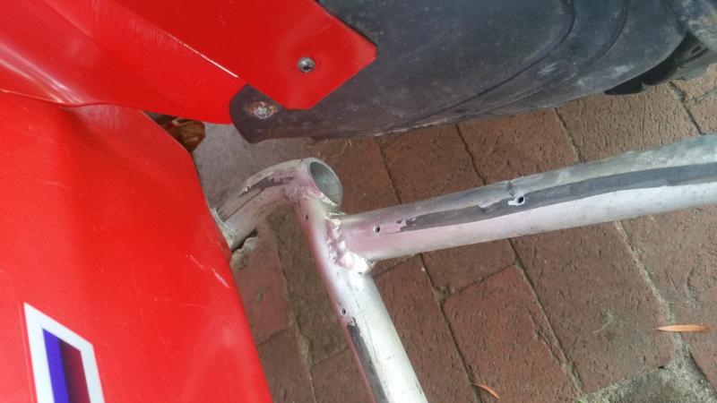

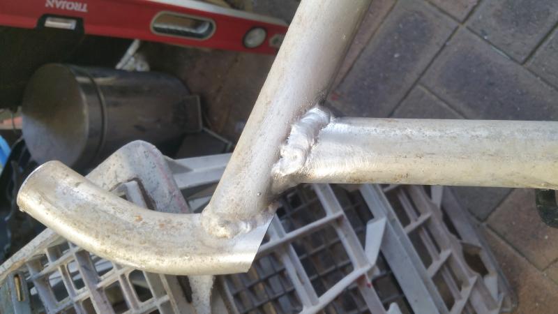

Cut inner end of alu nerf bar then pushed it in and rewelded for the full lock clearance.Still learning/practicing alu spoolgun welding.Wish I had started decades ago absolutely love it.Next to learn is Tig. :shock:

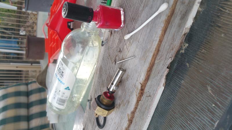

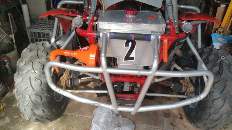

Slow leaking Pilot fuel sensor in my custom alu fuel tank drivin me nuts.
Thought it was the washer seal each time but turns out its the tweaked wire spade connecters where the black resin is.
So used some nail polish all round to hopefully seal it.
Yes it's my polish! :shock:
I use it to refit my fishing rod line hoops and touchups on the buggies.
Its also RED so don't be hatin me! :-)
I'll update the results when known.

Quote: "So used some nail polish all round to hopefully seal it.
Yes it's my polish! :shock:"
and we also see a bottle of baby oil there ----- that's what we all thought :-)
CO
On a side note, will nail polish hold up to fuel ?
I doubt it.
CO
PostPosted: Fri Apr 05, 2024 7:13 pm
I was thinking the sam thing, will nail polish hold up to fuel?
Test it by pouring some fuel on it.
May have better results with some JB weld.
