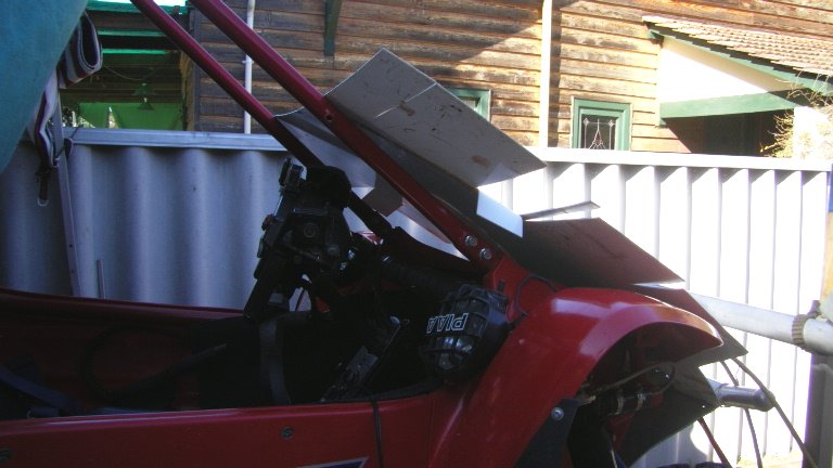

Have started to make some plastic panels for up and coming Northam Race.
First up ,the number plate, then a prototype protective bonnet.Last race meet, I got blasted by the big Bearclaws on the 100hp plus Piranhas, :shock: Was not fun!
Tested it out today and was fine, just needs some more shaping and finishing trims.
Will post more pics during the week.

PostPosted: Sun Jun 17, 2007 9:41 am
Looks good, I have seen wire mesh screen used with great success over the open area to keep rocks and stuff out usually a 1/2" x 1/2" mesh, if you get mud on it and cant see you just smack it a few times with the back of your hand it falls off.
PostPosted: Sun Jun 17, 2007 9:53 am
Yeah, I was thinkin of something similar, but don't want it to impede vision too much.
Best thing I'm thinkin is, Best Holeshot Ever! Get to first hairpin first, then spray them and go like !@#$ :-)

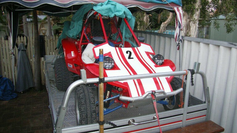

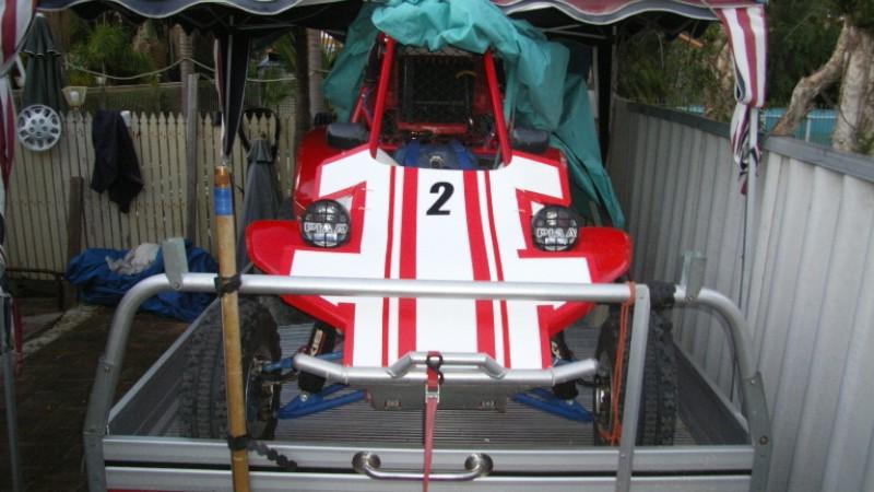

PostPosted: Wed Jun 20, 2007 6:41 am
Well I got some more done today on the bonnet, what do you think?
PostPosted: Wed Jun 20, 2007 7:45 am
Posts: 631
Location: Fredon,NJ
HELL OF A JOB !!!!!!!!!
Like the number........... :-) :-)

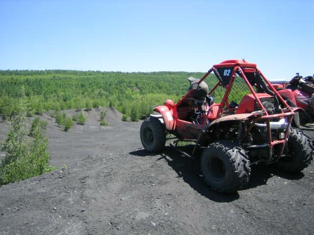

PostPosted: Wed Jun 20, 2007 8:04 am
G'Day Joe, thanks, and yeah ive always liked #2, 2 many drinks! 2 much to eat! 2 much fun! 2 much bullshit! :-)
You get the idea! :shock: :-) ...Baz
PostPosted: Wed Jun 20, 2007 8:19 am
Posts: 885
Nice
Could you post some info and pix of the mud flaps on the front fenders. I have thought of doing the same.
PostPosted: Wed Jun 20, 2007 8:52 am
Posts: 631
Location: Fredon,NJ
oh no doubt - right there with ya!!!!!
