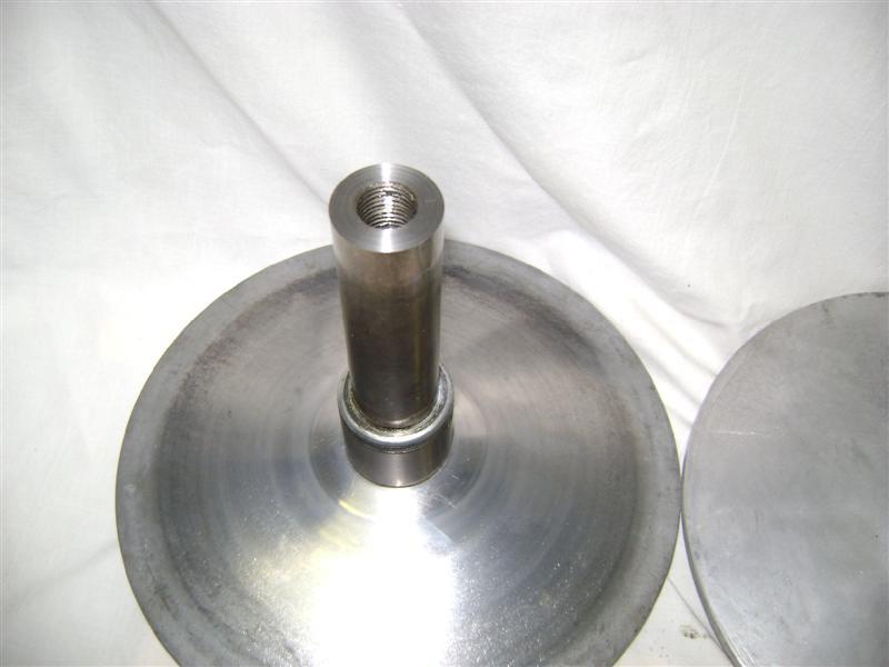

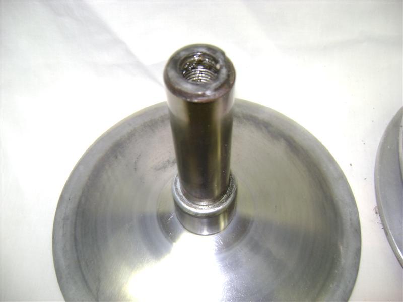

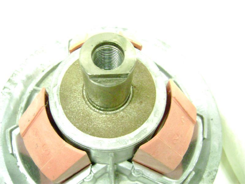

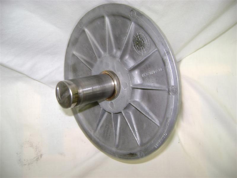

Here is the clutch off Mudbogger's CO Pilot he had dropped off at my house viewtopic.php?t=4460 someone did not install the clutch properly so naturally its damaged, they did not line up the D washer with the D on the end of the shaft, many people mess this up for some reason..
This clutch like new it has no wear on it other than the damaged cover and shaft.
The plan is to cut off the bad part and make a spacer to replace the material removed then modify the cap to make it stronger, better.
Below is a picture how the end of the shaft should look, the pic is of my new spare Power Bloc.

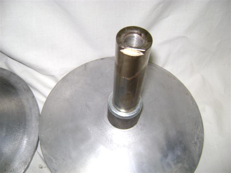

Here is Mudbogger's damaged shaft.

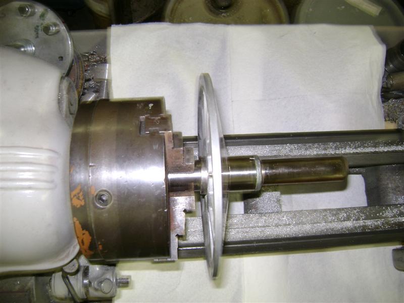

In the lathe.

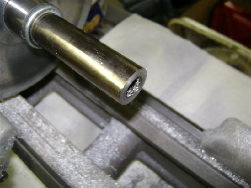

Skim cut with parting tool to check the hardness, not hard at all but tougher than mild steel.

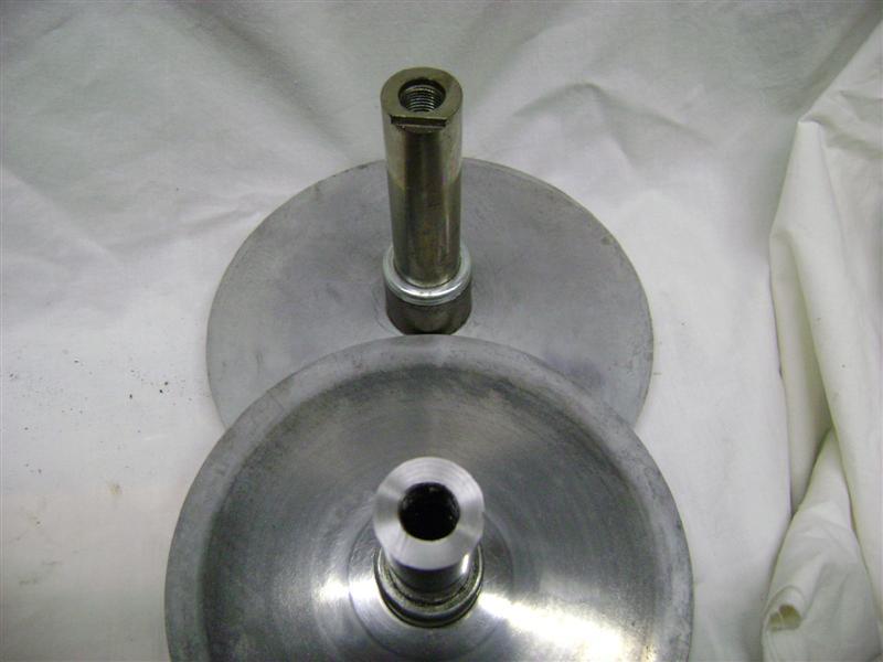

PostPosted: Wed Aug 27, 2008 7:35 pm

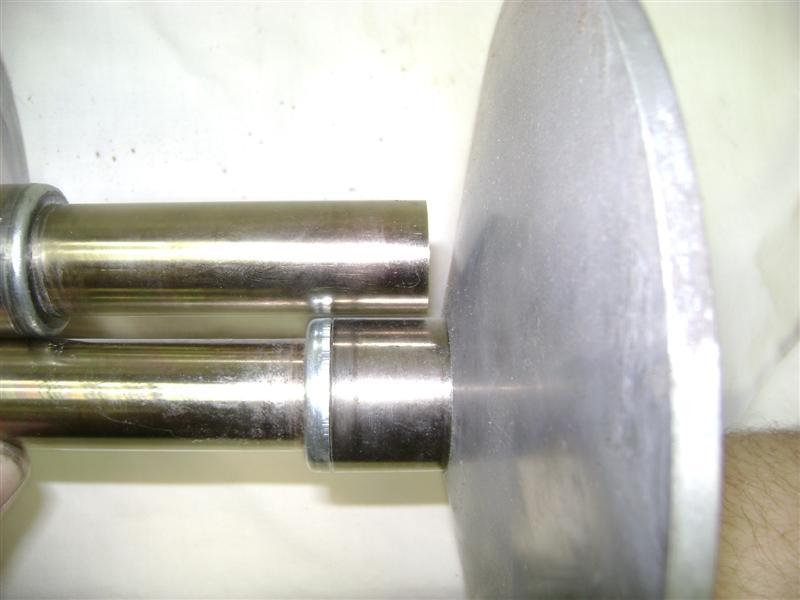

Ok now the damaged area is removed its shorter, here it is compared to a new clutch.
PostPosted: Wed Aug 27, 2008 7:36 pm
See the difference in the ends of the shafts now

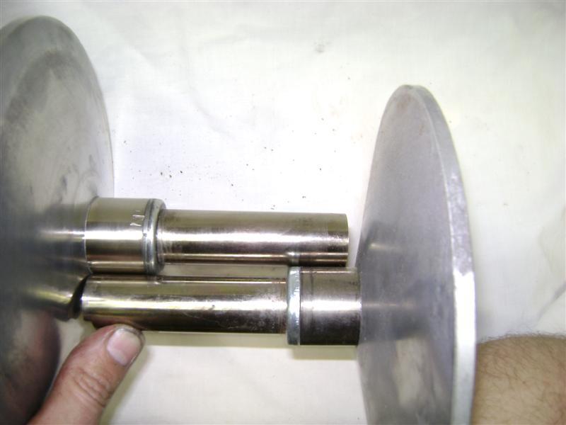

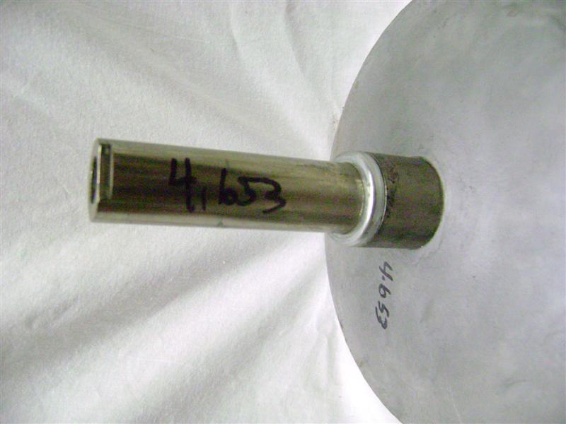

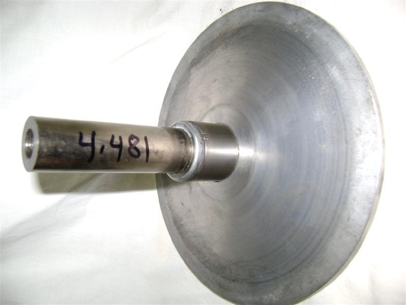

Here is the shaft lengths.
Stock is 4.653 long
Mudbogger's after being machined is 4.481
The difference is .172 so I need a spacer or harden washer about .172 thick..

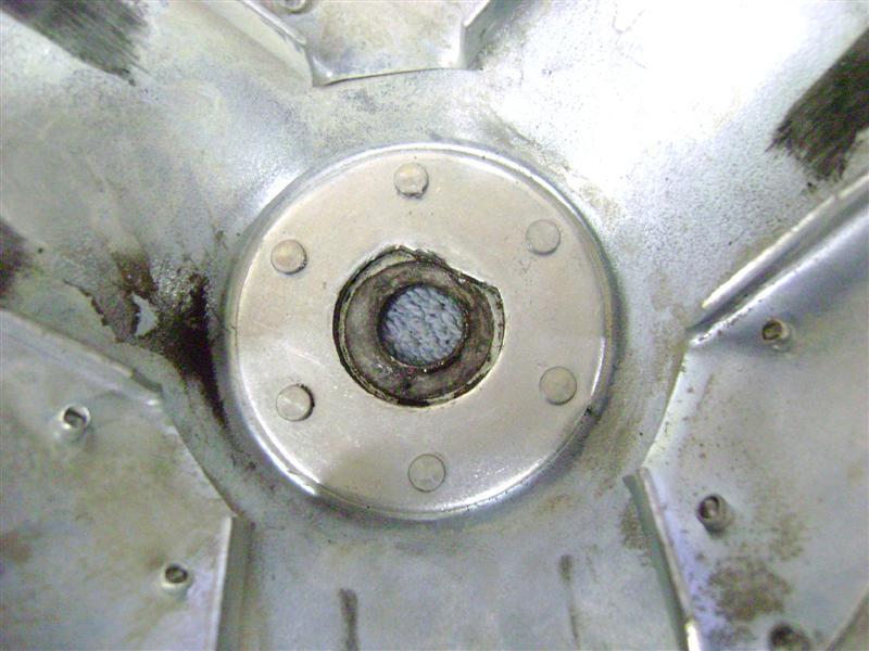

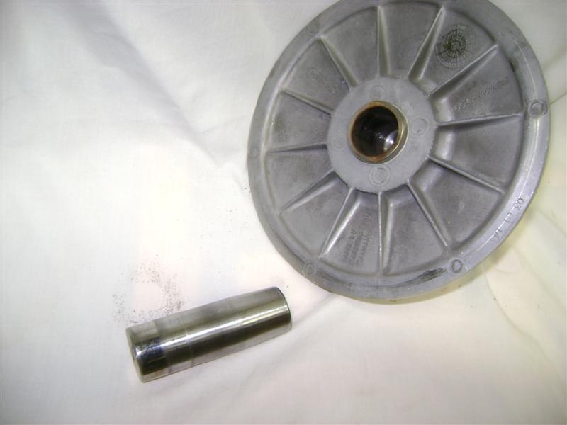

Lets move on to the cap, the D washer is just riveted to the cap so you can grind down the rivets and take a punch and drive them out to remove.

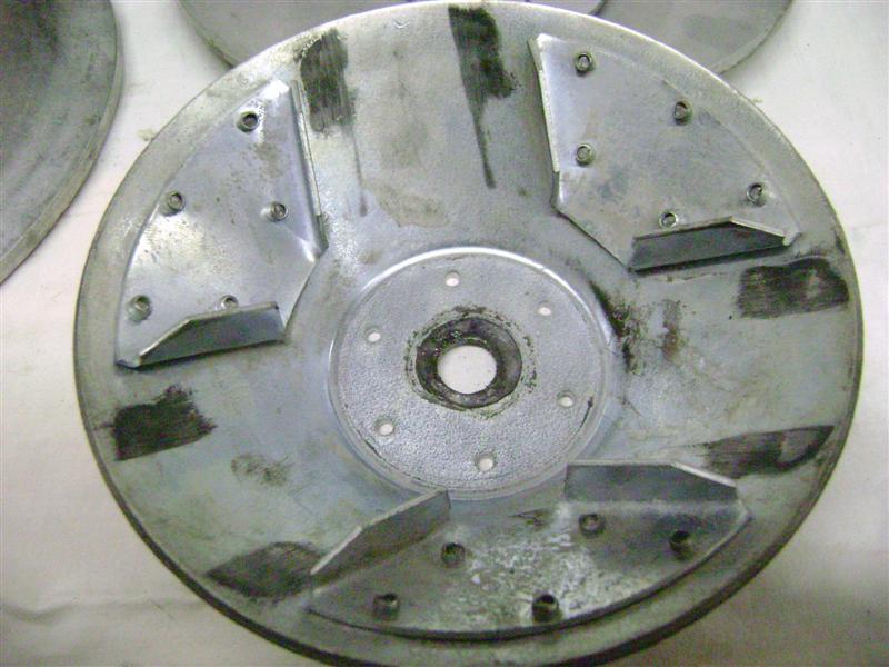

PostPosted: Wed Aug 27, 2008 7:42 pm
Inside the cap with the D washer removed

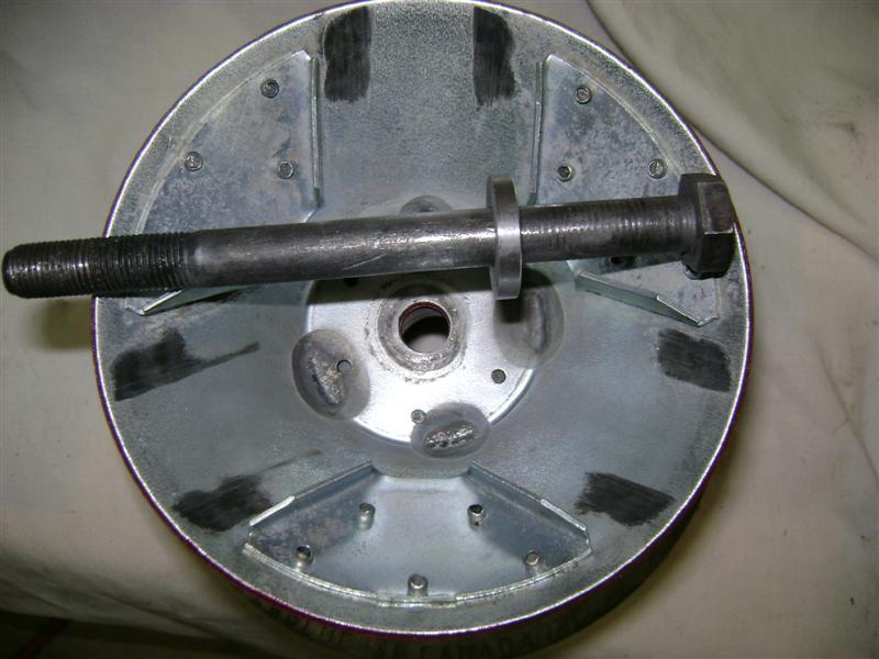

I think I need to make a washer that is .172 thick out of some cold roll? steel as big as the D washer that was removed so I can tack weld it to the cover, I would like to make a harden washer larger than the one that comes with the clutch so the head of the bolt don't dig into the washer.

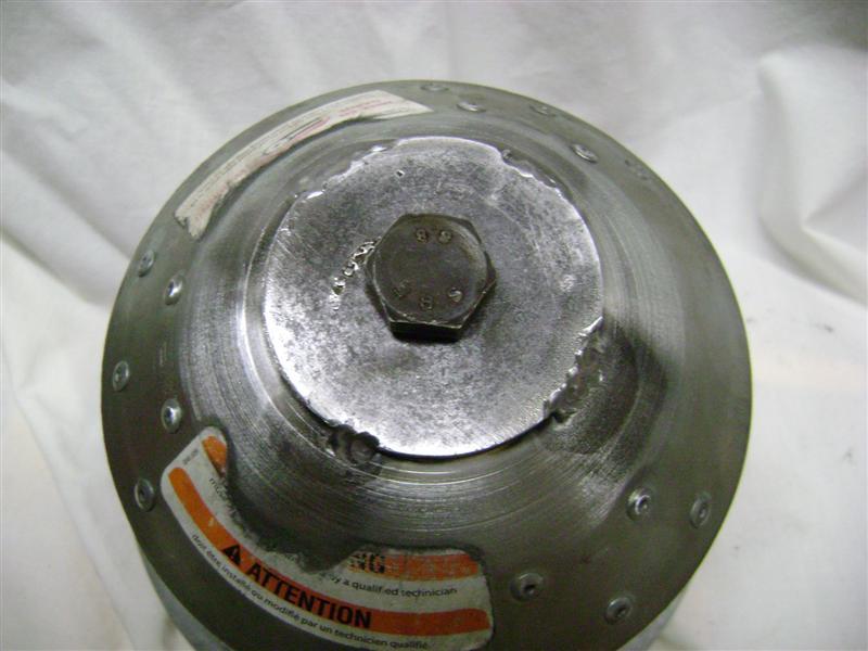

PostPosted: Thu Aug 28, 2008 7:36 pm

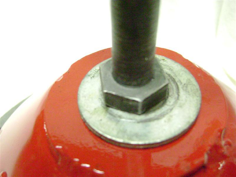

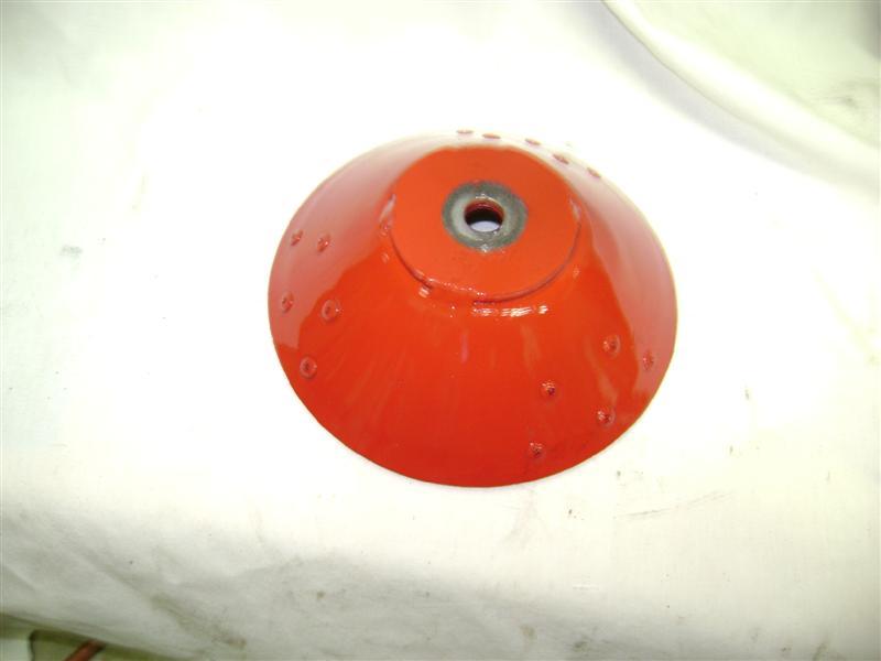

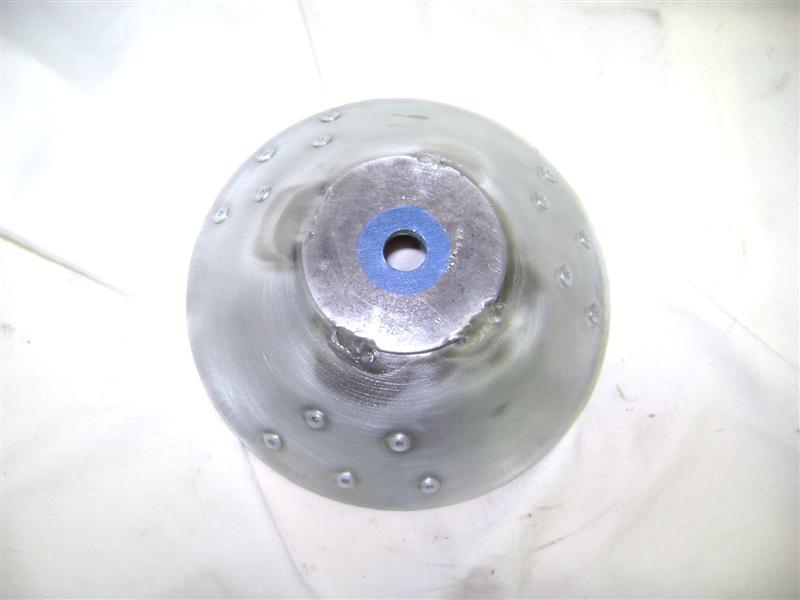

Made a new washer for the outside, tack welded it to the cover so it cant spin, didnt use and filler material so it wont affect balance, tacks would be easy to remove if the washer ever needed changed.

Masked it off for paint, don't want paint between the washer and the head of the bolt so it cant slip.

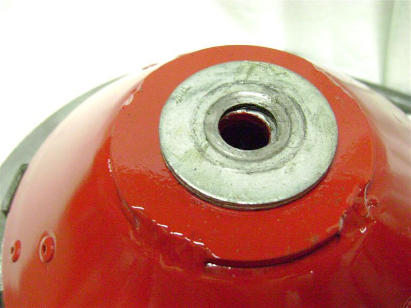

PostPosted: Thu Aug 28, 2008 7:38 pm
Splashed a little RED paint on the cover so it wont rust.

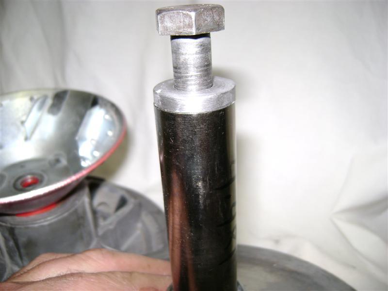

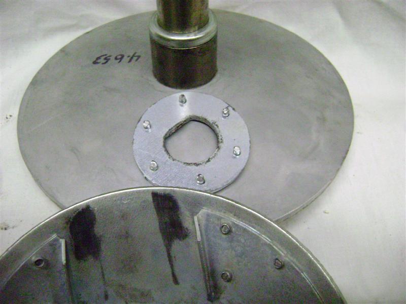

Made a new washer 1.00 OD x .072 thick to go under the cover.
PostPosted: Thu Aug 28, 2008 7:57 pm
The washer makes up the difference in length I cut off.

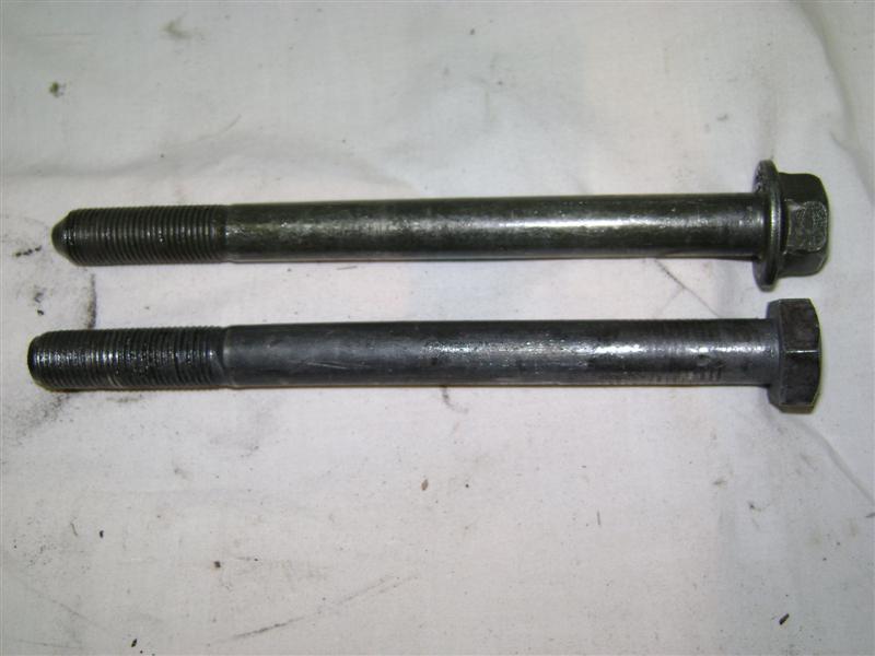

PostPosted: Thu Aug 28, 2008 8:05 pm
The top bolt is the HONDA stock clutch bolt, the bottom is the one supplied by Power Bloc, anybody see a reason why I should not use the HONDA stock bolt the head is much LARGER (better) than the Power Bloc this will eliminate the damage to the outer washer problem.
Mudbogger you have any stock Pilot clutch bolts?
Service Honda says 90128-SG0-000 BOLT, FLG (12X142) and they are only $8.75 each... wonder if we can still get them wonder if we can get bolts with a large head like that else where 12mm x 142 mm actually the bolt could be 1/2" longer...
