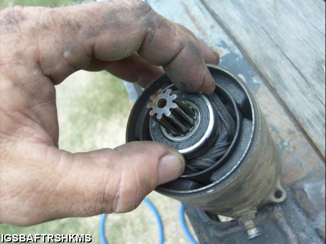

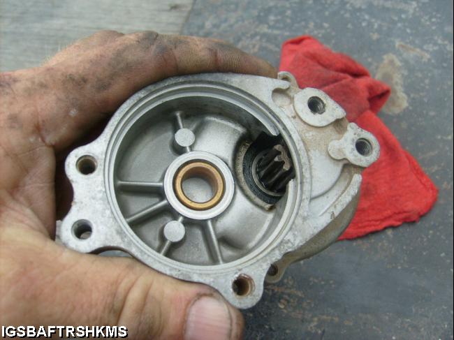

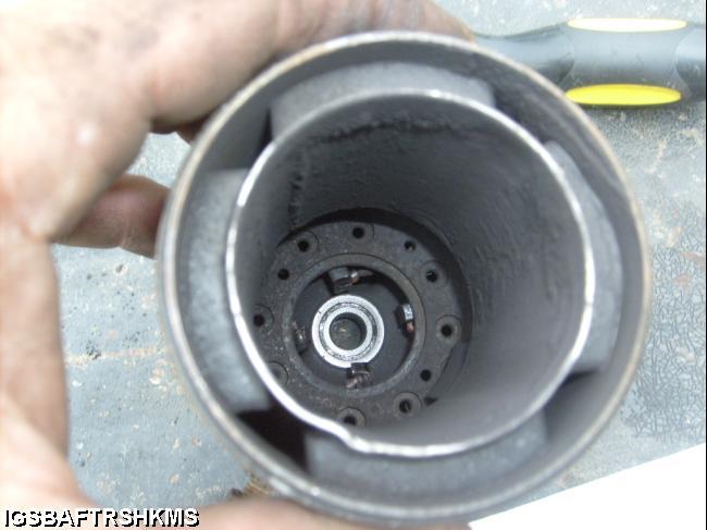

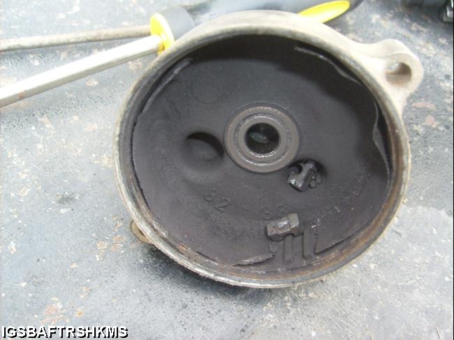

I took this apart expecting to see a lot of oil as I have seen everyone complain about... Just a light coating on the outer gears, what were visiable from notch... I pulled it apart and found a bunch af carbon looking particles??? I wonder if this is a rebuildable starter??? What do you think... (It will take some time to load all pics on my end...)

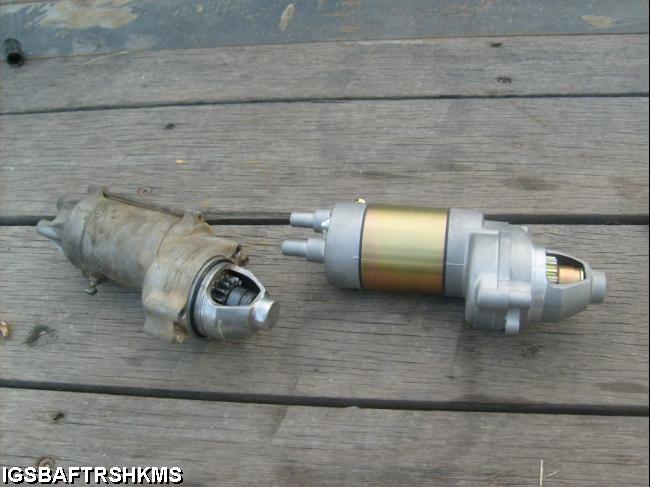

File comment: New and old side by side... Only new has connector on the bottom??? wire was long enough to reach so no worries... fit in easier also!!!
File comment: inside the flywheel...
File comment: cover off...

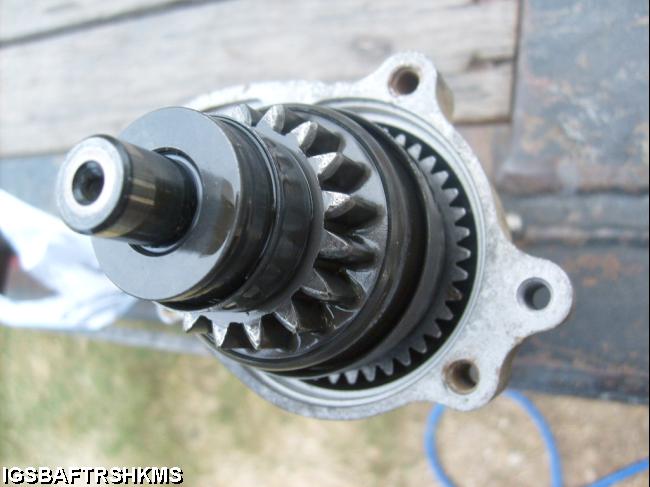

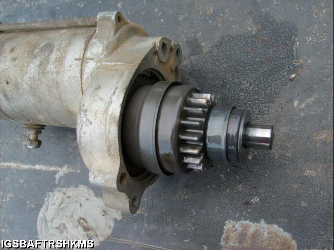

File comment: gears look clean...
remember I have never torn into one of these...
File comment: no oil in here either... I have seen stories of black goopy oil in these...

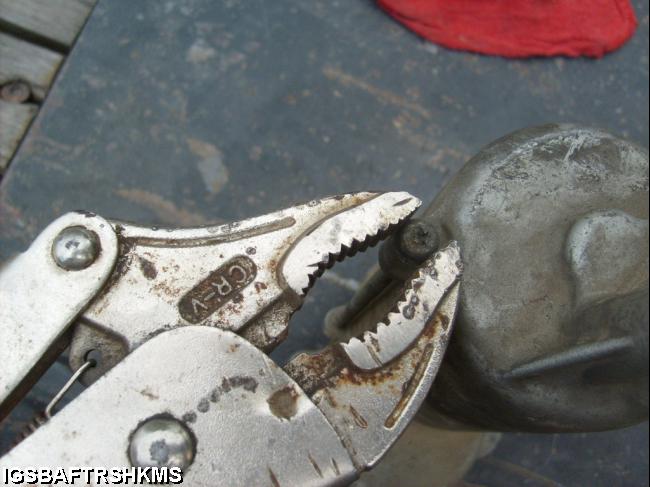

File comment: Someone has been into this one, phillip's slots are buggered up...

I am hoping to learn whether or not this is worth rebuilding before I buy alot of parts...

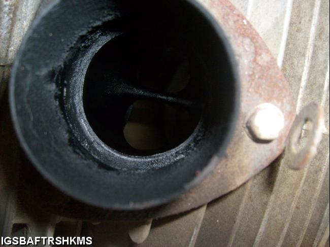

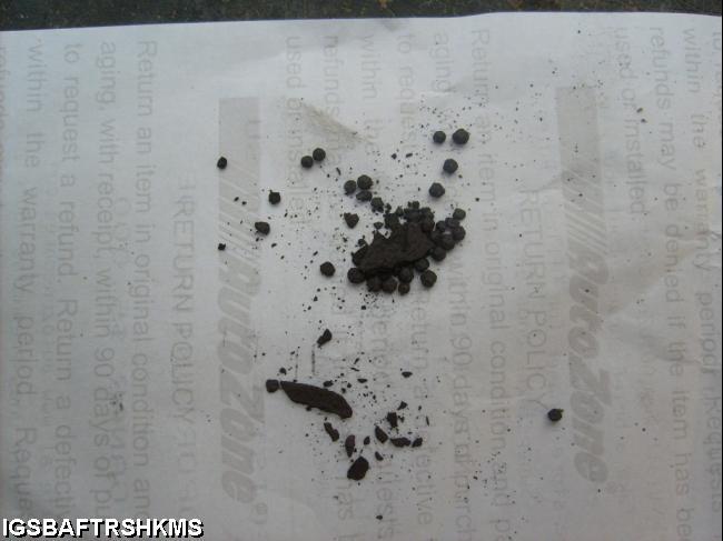

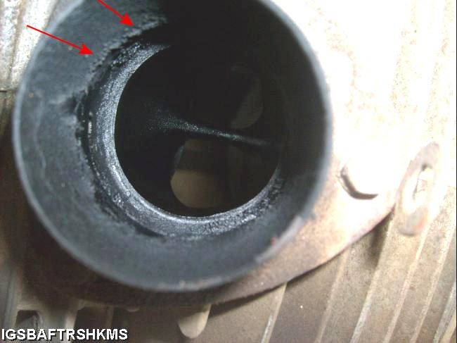

PostPosted: Mon Aug 13, 2007 4:26 am
Remove the exhaust manifold and take the pic again.
You need to remove the carbon it will just fall off and get sucked back in the Engine and do damage.
When you take the pics also roll the piston up to TDC (Top Dead Center) so we can see the skirt.

That starter is worth fixing up.
Looks like the brushes may have failed.
The rebuild kit has the (edited) brush replacements and the part (pic 41) that holds it. its not that expensive.

Which is the armature??? the big piece with wires... or the piece on top with the little magnets???
PostPosted: Mon Aug 13, 2007 10:01 am
Posts: 407
Location: Orlando
Wash everything up and lets see the pitcures again. Your brushes are gone for sure but that is an easy fix. The comutator on the armature (PICT 37) looks wasted and you may need an armature. The rebuild kit usually contians the brushes, bushings, bearing and O rings.
Id be glad to rebuild this for you if you don't want to try it yourself. You supply the parts and I'll supply toss in my 25 years of alternator and starter rebuilding knowledge.

Clean up all the parts and take a closer picture of the copper part of the armature and I should be able to tell if it is worth trying to save or if you'll need an armature.
Other then the brushes and armature everything else looks good.
