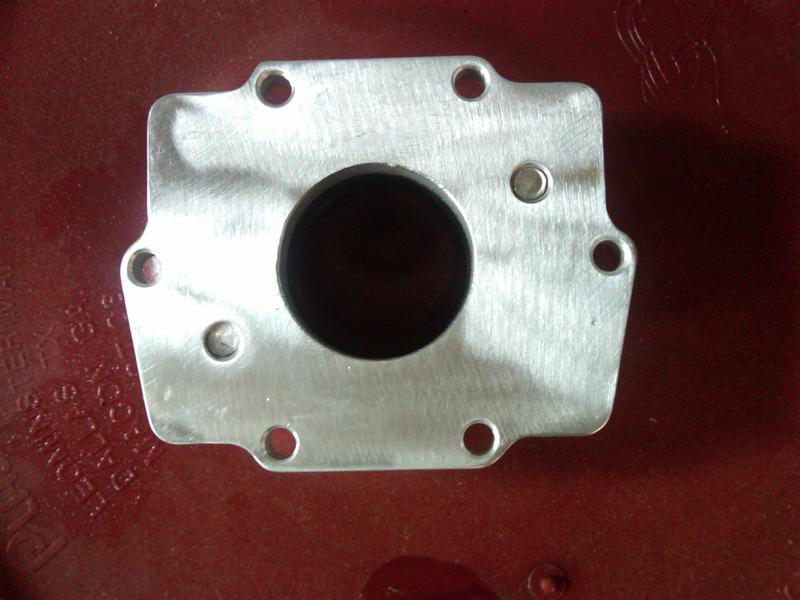

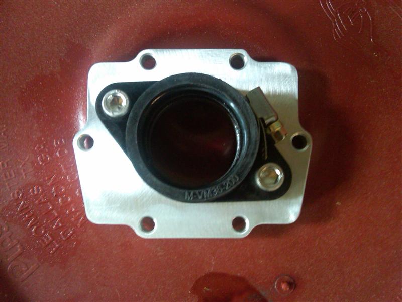

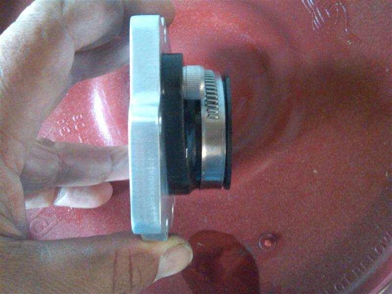

Here's pictures of the intake.I messed up when I ordered -they asked me if I wanted a flatside intake and I told them yes-I need a angled intake so the carb sits level-I screwed up! I had another replacement OEM intake from the manufacturer on the 3 wheeler boards, so I installed it tonight-we will see tomorrow if it seals well.
File comment: this is the flatside manifold, this needs to be angled-
File comment: see the OEM replacement is angled up top so the carb sits flat when installed, this is what I needed.

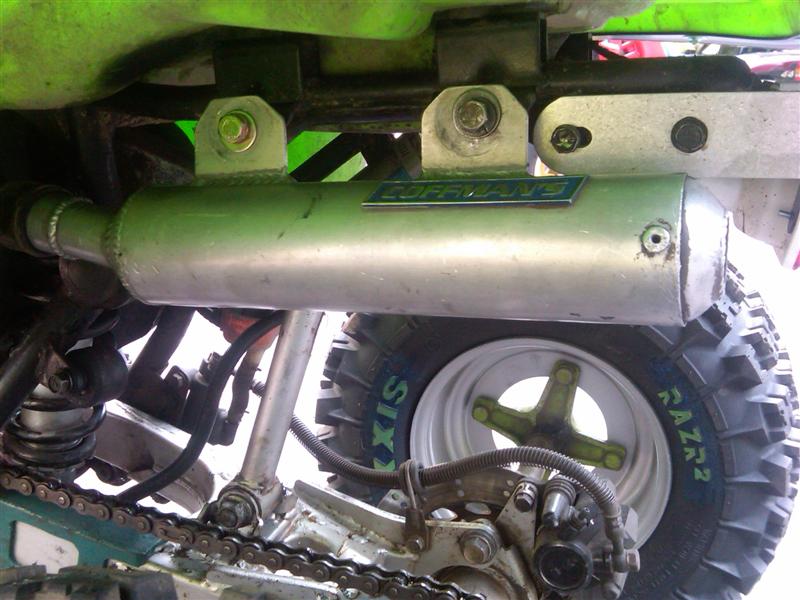

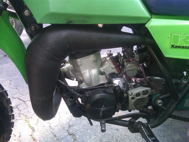

I installed the replacement intake yesterday, let it sit for 24 hrs.I air leak tested the motor (( Internal Combustion Engine ? )) today-held 6 pounds for 4 hrs,PHEW!! THANK YOU GOD!! I double checked with soapy water, no leaks at all.I installed the COFFMANS exhaust will let that sit for tonight as you need black rtv around the pipe seals by the jug, then start the jetting process all over again.I installed a 185 main to start with, needle on middle slot, stock 68 slow jet.Here is some pictures for you of the finished product:
File comment: Coffmans exhaust installed, with 35mm PWK carb, and new intake as well

File comment: opposite side of the motor (( Internal Combustion Engine ? )), I should have taken a closer shot for you-sorry.
File comment: Coffmans silencer, a very rare rare silencer from what I am told on the 3 wheeler boards-
