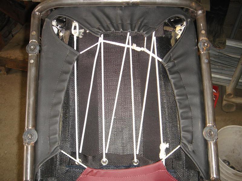

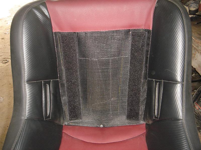

Good Debate, I definetly see both sides. When I was down at the super sand car show in Orange County a few years back is when I decited on using a suspension seat. I can't recall a single car there without a suspension seat. It seems for the recreational rider they suscribe to the comfort over safety debate.
Right now it would be much easier to stick to the stock seat. It seams much, much less maintenance than the suspension seat. Right now I plan on taking out the seat for every power washing, where the stocker works wonderfully for that.
This seat is from Renegade, and was from someone who "knew" just what will work in a Pilot, last words from a salesman. The reason it is not in the FL800 now is because it wont fit between the seat tabs and made it even higher.
I not happy with how thick it is, It looks like the cusion is as tall as the sides of the seat. With out the seat cusion it seems just right, except pretty tight in the arse not something you would want to ride for an hour much less all day.
Here is a couple pics of the bottom construction of the seat.
Wayne
File comment: Looks like they used nylon rope to hold the nylon mesh. Litespeed how has the nylon rope you switched to held up? You can see the seat bottom bar is right at the washer/nut recessed in the mounting frame. The actual back bar of the seat frame is level

PostPosted: Wed Jul 30, 2008 12:50 am
Posts: 727
The one in the pilot was the one that the cotton rope replaced with nylon but doesn't get used that much anymore. I replaced the seat in the Drak a few years back with a Corbeau also but it still has the original cotton rope. Still good to. I could have put the pilot away wet and the rope may have dry rotted, no clue on that. Anyway to answer your question it's holding up fine so far. It was some of that fine Homo-depot china rope I used and I'm sure it was built to last a life time. :)
