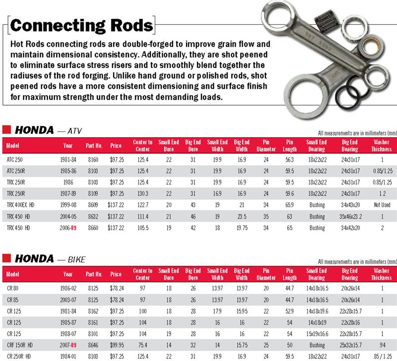

spec for fl350 from hotrod cat
its the cr250r 1984 to 2001
Note the thrust washers are to be 1.2mm = 0.047244094488188976377952755905512
Note the pin is to be 59.5 mm long
so if you get the 8160 kit you will get a shorter pin that may not work as well
the thrust washer that are 1.25mm May work = 0.049212598425196850393700787401575 maybe tight
.85 mm = 0.033464566929133858267716535433071 maybe to lose
FL350 Honda Odyssey crankshaft rebuild repair rod replacement.
File comment: rod kit 8103

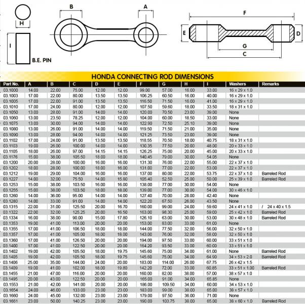

now Pro x spec out the cr250r for a part # of 03.1315
this one has the 59.6mm long pin and the 1.2 mm thrust washers

Note nobody make a rod kit for the fl350
as i seen with the right parts yet
this is what Honda used
Rod center to center = 125.3 mm
big end pin length 62.56 mm not available any more
stock Honda thrust washers 1.2mm Thick
so you are go to get thicker thrust washer or a shorter pin
I think THE PRO=X ROD kit for the cr25r 84-01 my come with the longer pin 59.6 mm and the 1.2 mm thick thrust washers
call Rocky Mountain http://rockymountainatv.com and the clarified it that it come with the longer pin and the 1.2mm washers
So as of right now if you see a rod kit for a fl350 watch what you are getting as noted above
