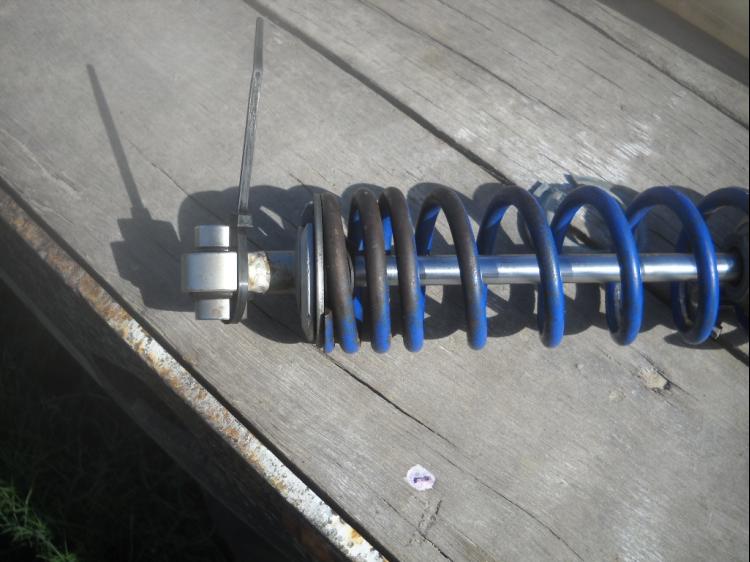

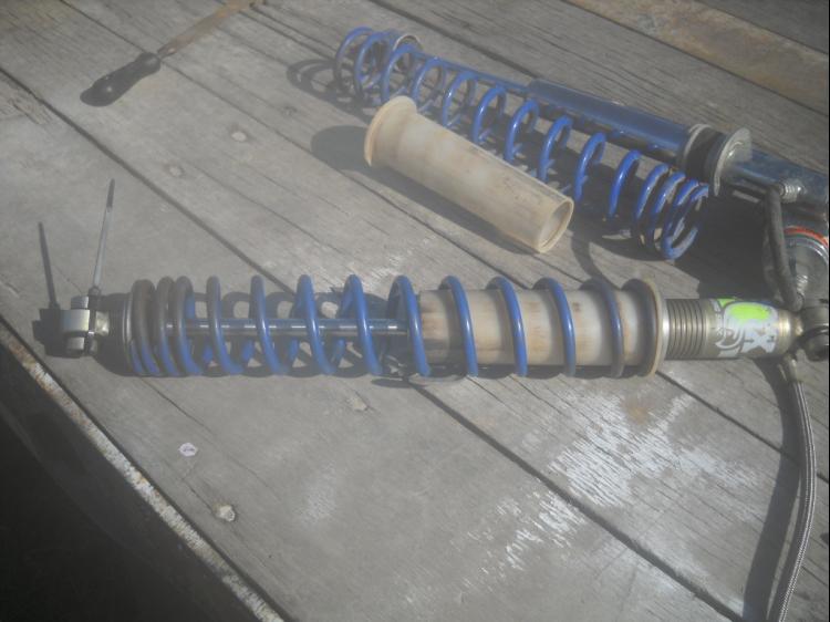

Who knows about these? I recently found a pair of rear, and they look to have some of the same parts off of the stock shocks? Does anyone have a pair, or photo's of how they looked before previous owner molested???
I have both the fronts and rears, and will be wanting to try them out just for giggles!

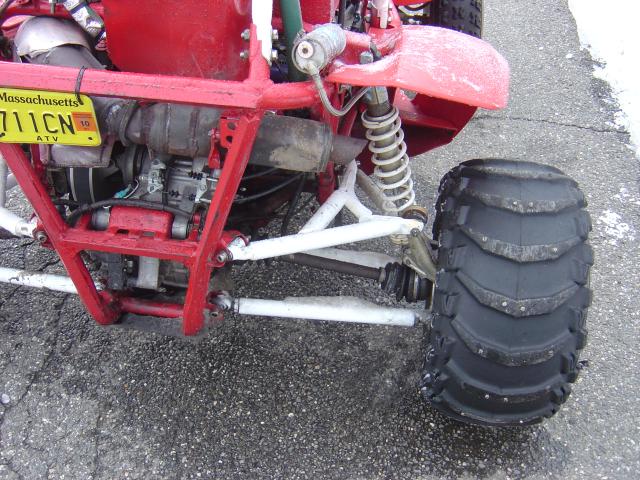

PostPosted: Tue May 25, 2010 9:04 pm
Posts: 1037
Location: CT
I have fox coil overs on the rear on mine.

PostPosted: Tue May 25, 2010 9:27 pm
Did you have the coil overs painted white? Mine are blue just like the stock rears, but are a 1/4 shorter, the shaft is 7 1/4" long, the eye to eye is 3/8" longer!
They also had what appeared to be the plastic protectors but they were upside down/backwards from the stock setup...
Is this the long travel setup brooks found for you???
PostPosted: Tue May 25, 2010 9:43 pm
Posts: 1037
Location: CT
I did not paint them. Mine too had the plastic protectors but they were so brittle that they just fell apart. Yes this is the long travel set up that brooks found for me.
I also have fox coilovers on the briggs car. They have the blue springs and are much beefier than what is on the pilot.
PostPosted: Tue May 25, 2010 10:50 pm
here are some photos.. I see the closer springs are at the bottom instead of the top, just like yours King KX

PostPosted: Fri May 28, 2010 11:04 pm
I got these cleaned up and mounted! I took the springs and put the tighter coils up at the top. I then cut the plastic down to about an inch to keep the springs from moving around. I like the ride so far, just around the yard, want to try it at a rougher spot this weekend!
