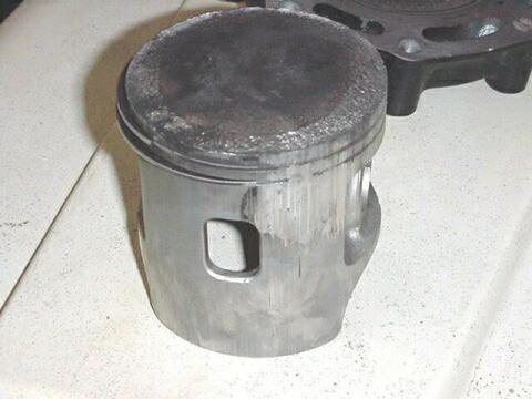

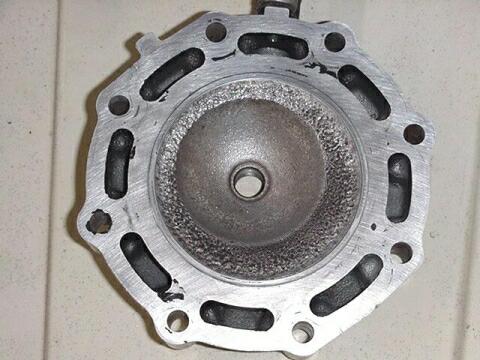

Soon as I removed the head I knew something other than a seizure had brought my motor
to a hault

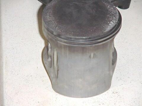

You can see by looking at the top of the piston that something had been bouncing around inside

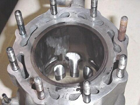

my motor for quite a wile. Below you can see where my piston stuck to the cylinder wall on the
intake side.

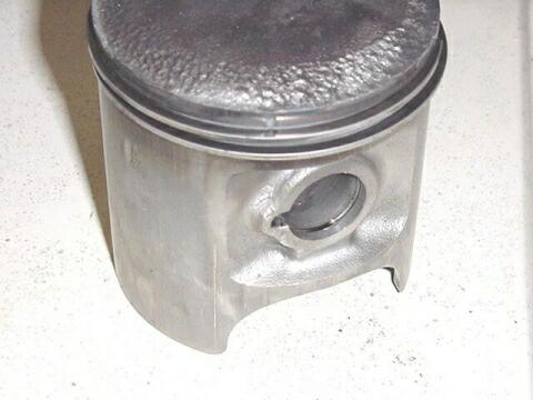

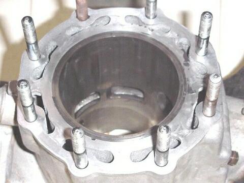

Look close at the piston below and you will see where something came between the piston and
cylinder wall almost 180 degrees from the scoring on the piston.

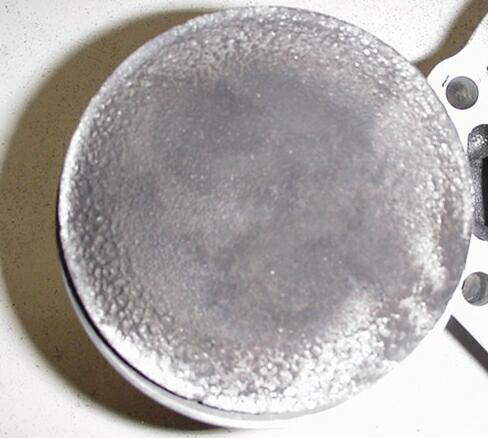

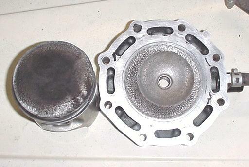

A close up of the metal that was beat away from the the top of the piston, notice almost
no scoring on the exhaust side of the piston.

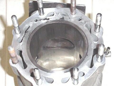

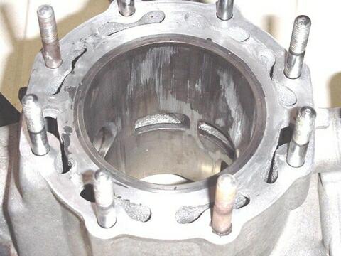

Below you can see where the piston stuck to the cylinder wall.
once the aluminum is removed from the cylinder using murtatic acid I will be able to tell if the
cylinder is still serviceable or will need bored oversize.
