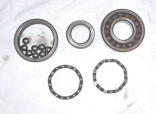

Crank shaft is out Just like I thought the bearing holder came apart the bearing that failed was on the clutch end of the crankshaft. Ok this has been a frustrating adventure, I ordered a new crankshaft and all the necessary gaskets, seals and bearings necessary to replace my crankshaft I figured the old crank was 11 years old and had a lot of miles on it so I would be better off buying a new crankshaft order a second set of bearings, gaskets seals and keep the old one for a spare, lets face it Honda is not going to make replacement crankshafts for ever so it would be nice to have a spare laying around just in case. Well about 5 days after ordering my parts from Hillside Honda they finally came in well not all my parts just the crankshaft, so I called Hillside to find out when I would be getting them come to find out the guy that took my order just ordered the crank and nothing else ( BTW he don't work there any more ) so Joe (real nice guy) assured me that I would get them right away. If you look in the service manual you will see that there is a lot of special tools needed to split the cases and remove the crankshaft. I was able to make everything I needed to get it apart and had to buy a rather large (40 mm) socket to get the big nut off that is behind the flywheel off. The cylinder had some minor scratches in it after the beating it took when the retainer pins from the crankshaft bearings decided to take a tour of my motor so I decided it is better to bore the cylinder and clean it up rather than just hone it and let it run on the loose side. The guy that was going to bore my cylinder had been real busy and it took him about a week to get to it then when he was about to make his first pass the gears in his boring machine broke, he called and said it was going to be about 2 weeks to get the gears, so I took my cylinder to a local automotive machine shop to get the bore done.
