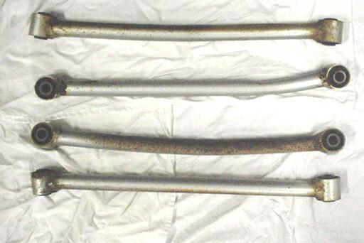

As you can see below the rear links are bent just a bit, I will straight them out then weld small angle iron on the leading edge to make them stronger and keep them straight. ![]()

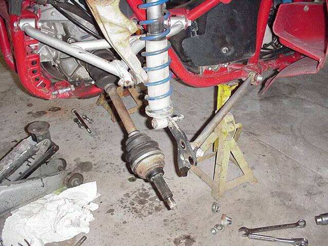

I tried to remove the axles but no luck they are rusted in :-(

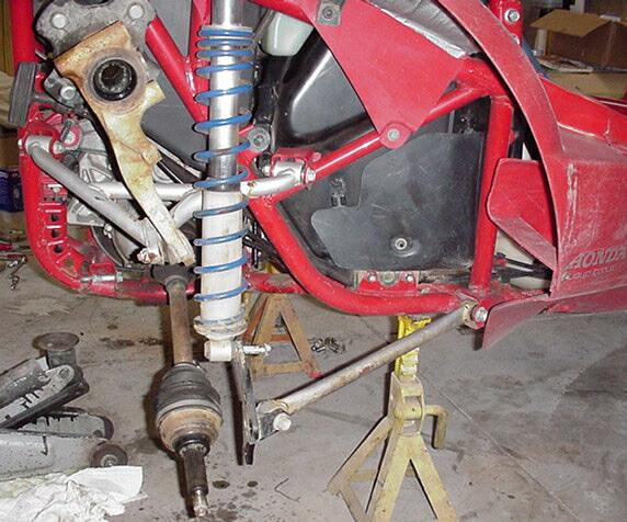

The upper A-arms will be removed and the spherical bearings will be greased.

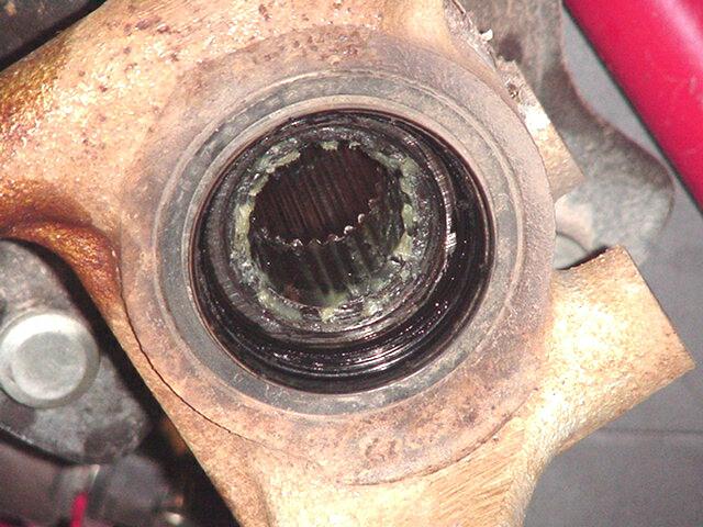

The seal did show some signs of wear and the bearings felt good, new seals go on the list of things to replace this winter.
