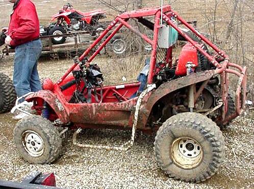

We went riding at the Badlands (2-26-00) and pretty much got rained out but before we did leave Kiowa, Stoneman and myself decided to take a run down a very muddy trail it was fun but after we went through it a few times I noticed my rear brakes were not quite up to par, so after i washed my Pilot I figured it was time to inspect and clean the rear brakes since I knew from past experances that once you have been in the mud it is time to take apart your brakes to clean them out. Back in the days when I raced and they would water the track down and get a little carried away I would have to take my brakes apart after every race weekend.

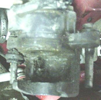

The above picture was taken before we got into the really nasy mud.

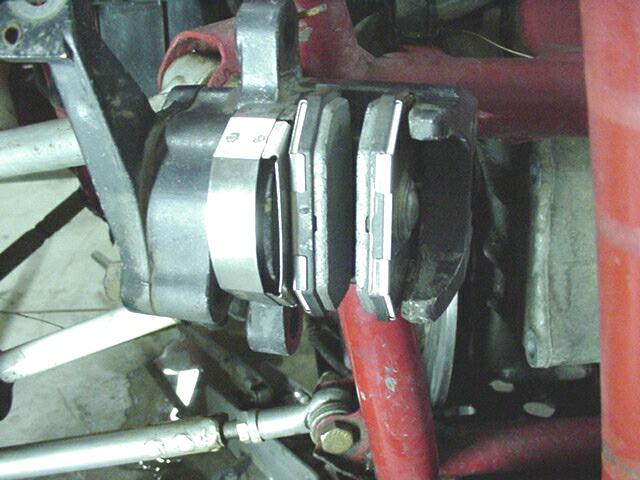

You can see just how much mud stays inside, no matter how well you wash it the only way to make sure it is clean is to take it apart and wash it.

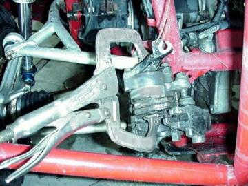

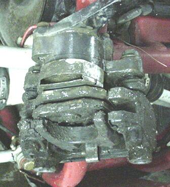

After the caliper is removed using a Vise Grips will push the piston back onto the caliper real easy, you will want to remove the the cap on your brake res and check your fluid level before pushing the piston all the way in unless you want fluid all over the place.

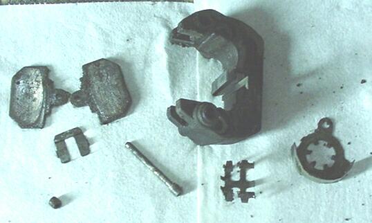

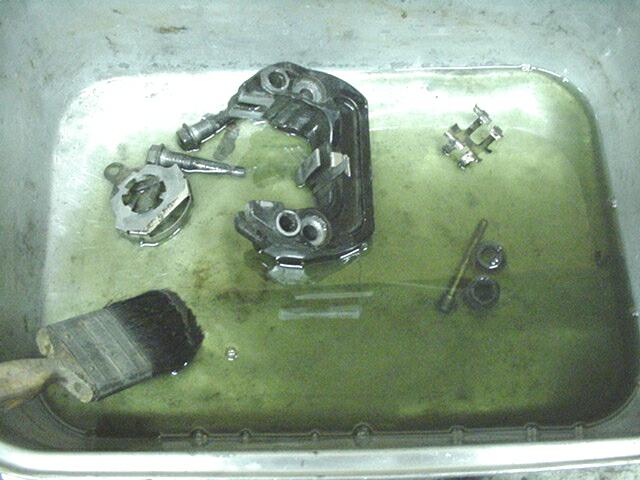

After you get your brakes apart you will see that everything is covered in mud. These parts went right in the sink to be washed with soap and water and then blown dry with compressed air before going right into the parts pan to be washed again in mineral sprits.

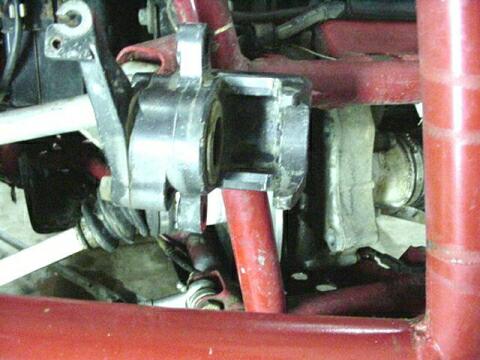

This is kind of a bad picture but you can see inside the caliper it is full of mud, it also was cleaned but by wiping and scraping off as much of the mud as possible then washed with brake cleaner and dried.
The parts starting to come clean :-)
The caliper after washing

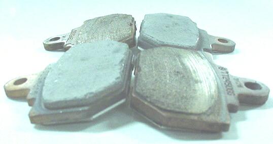

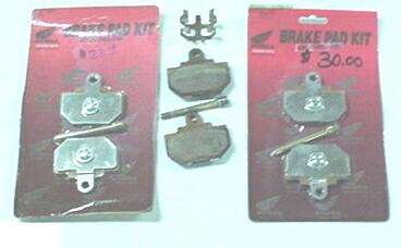

When you buy the pads from Honda you will get a new guide bolt with the pads and sometimes you will the stainless steel spring that holds the pads. If you buy the after market pads you will need to buy the pin from Honda if you try to use the old pin the pads will not maintain proper alignment and will wear out very soon. You will also notice on the Honda pads they have polished stainless steel backing plates, those are to reflect the heat back to the pads and keep the heat away from the caliper, something you wont find on the after market pads and another good reason to buy the Honda pads. Like with everything else you get what you pay for, you buy cheap you get cheap

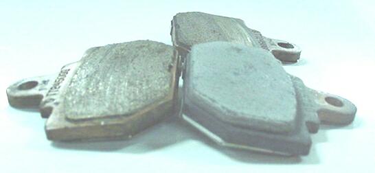

The old pads next to the new pads. No need to measure the thickness of the old pads I can tell at a glance they have met their life expectancy. Brake pads are like tires, pistons, rings ect. they are throw away items. The next thing on my list is to inspect the clutch and go through the front brakes, I am sure they are just as bad as the rear ones are.
