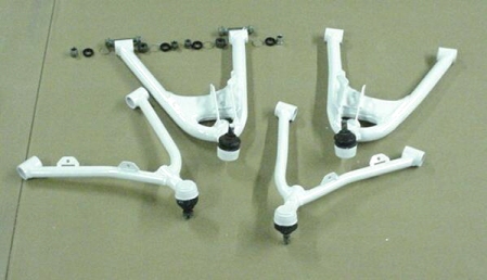

During the end of last season I noticed my front end was getting loose. 2 years ago when I was at Gary's in Missouri to attend his race during a practice lap I went over a hill just a little to fast and a little bit to much off camber and landed on the front left tire bending the steering column, knocked the air out of the front left tire and bent the lower A-arm just enough to really make Pilot turn to the left real good. Wile my Pilot is down for a rebuild and porting I decided its time to tear into the front suspension and and repack the front spherical bearings with some fresh grease. After taking the A-arms off I noticed I may have waited a year to long to repack the spherical bearings as the grease was black dried out and nasty looking after removing the seals and spherical bearings I found that there was a large amount of sand in the grease. (not a good thing) Wile I was ordering my rebuildparts from Hill Side Honda I got a price on new seals $2.38 each 16 required ouch, So after careful consideration I decided to pass on the new seals for now and I would sort through all seals from my A-arms and the second set of A-arms I got from Robert pick out the best ones and use the old ones. I am planning on making a new set of front A-arms from scratch and making them about 2-3" longer than stock so I can soften those lawn dart front end landings. I can see now that I should have kept up with my once a year schedule of cleaning and replacing the grease in the front and rear A-arms 2 years is just to long. when I would repack them once a year I always found them to be clean and the grease still looked fresh. Taking the A-arms off and removing the seals is pretty straight forward but removing the spherical bearings is a different story you first need to remove the stop ring (looks and works just like a cir clip on a piston pin) most of the time you cant get the stop rings out so I just take a brass punch and drive the spherical bearing out with the stop ring. Kiowa said he found a box of snap rings at a local hardware store the do the same as the stop ring and are easy to remove with a snap ring pliers. (I am looking into snap rings as a replacement)
After a fresh coat of paint

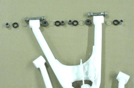

All the little pieces and parts needed for each A-arm Take a look at inspecting and replacing the lower steering stem bushing wil you have the tie rods removed.
