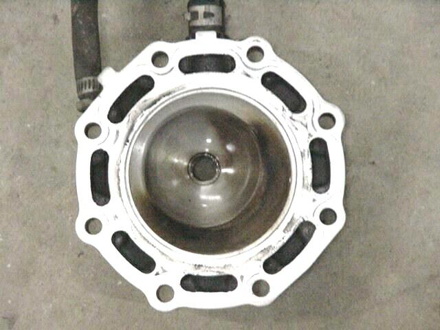

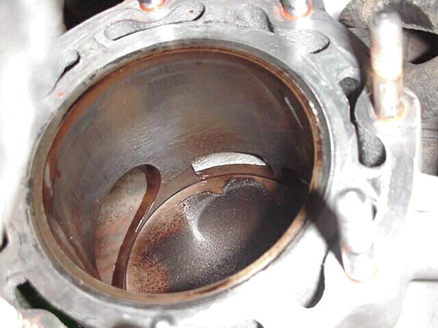

Here is the head after burning 4 gallons of the Amsoil 2000 at 32:1

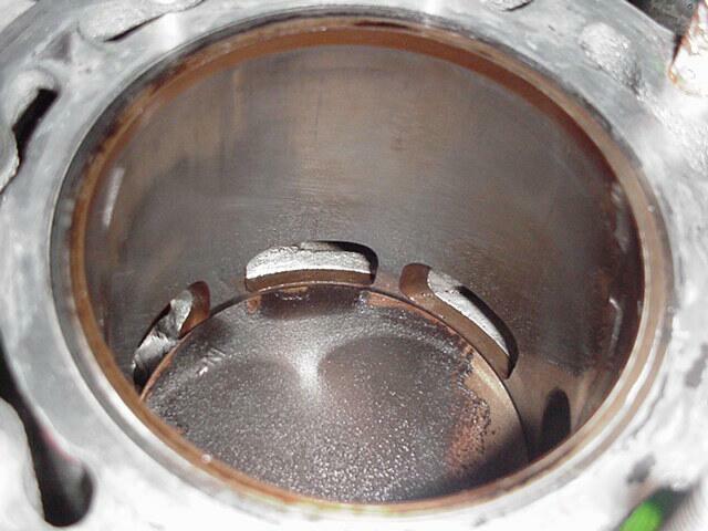

Here you can see the piston wash on the crown of the piston, looks like the left side of the
piston is recieving more flow than the right, is that because the intake boot is off set to the
right (when looking a the back of the engine) so more flow is naturally getting to the right
side of the piston?

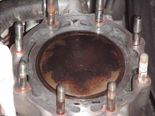

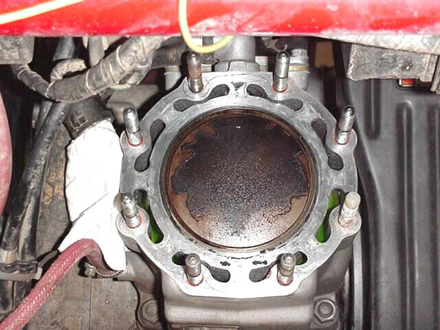

Intake is to the left, exhaust to the right, the transfer ports your looking at are on the clutch
side of the engine.
Exhaust port to the left and you can see one right side of the engine transfer port.

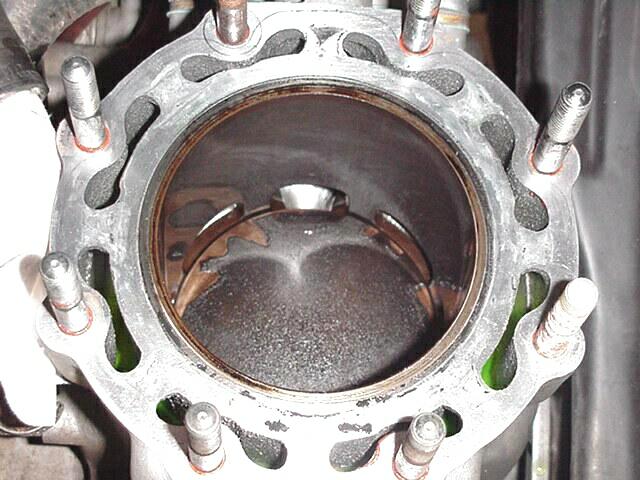

left is the rear transfer port, center is intake bridge, right is the rear clutch side transfer port.
