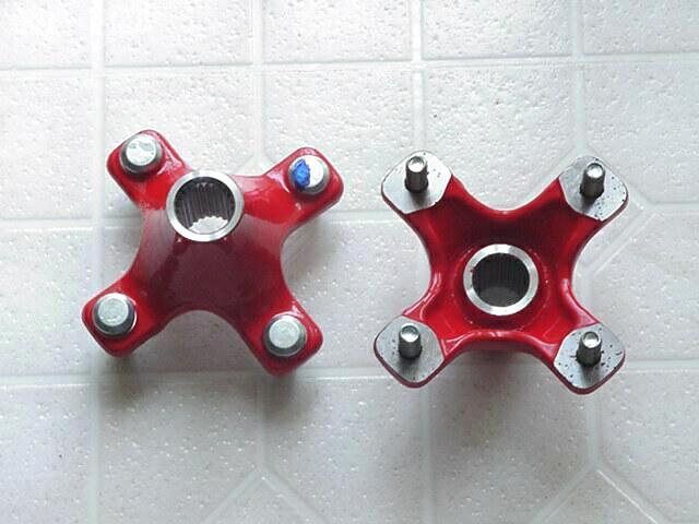

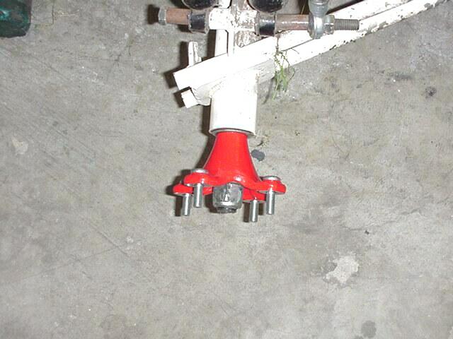

Here are some Honda hubs that fit right on a FL250, these hubs allow
me to use spare tires and rims on the Challenger that have been sitting
around.
These are off a 99 400EX Honda part number 42410-HN6-000 Cost from Hillside Honda was
$21.80 each they come painted and with the studs you will need to supply the lug nuts.

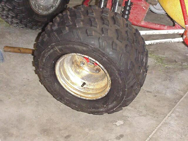

The new hubs allow me to use the 9" rims I have off a 85 ATC250R and the new set of Banshee
rear tires that were taken off a Banshee when it was new and never used, I was told by the guy
who gave them to me (thanks again MGR) that on a Banshee they do not work well they should
be just fine on the Challenger since wheel spin is not as violent as a Banshee.
I also have a bunch of 8" tires and rims I can now use with these hubs :-)
