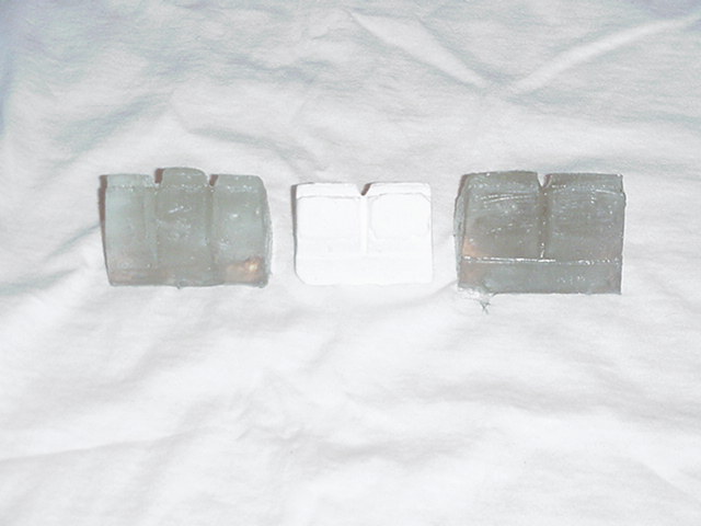

Below are tow just out of the mold, left is for the older style 6 petal reed cages found in
the 350 Odyssey and 89 Pilot the one in the center is the 3D-gel  after it has dried out
for about 4 days it was the same size as the one to the right.

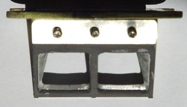

This is a 4 petal reed cage out of a 90 Pilot, you can see the stock stuffer here.

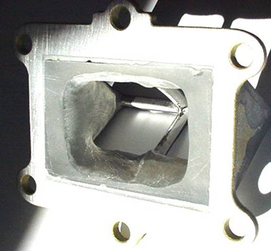

Here is the almost finished product, I coated the outside of the stuffer and
the inside of the reed cage with JB Weld to secure the cage in place, I
have seen too many factory stuffers that have vibrated around in the stock
cage to the point where you can see where they have worn away.
The finish work will consist of smoothing and rounding, I did not want to spend too much
time doing finish work until I let the assembly soak for 3 days in gas/oil mixture to make
sure the resin I used was truly gas/oil resistant.

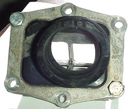

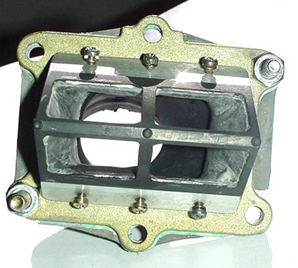

In the picture below you might notice the left side opening is a little larger than the right
side, this is because the intake manifold is offset and I wanted to allow more flow to the
left side to make up the difference and hopefully help equalize the air flow.

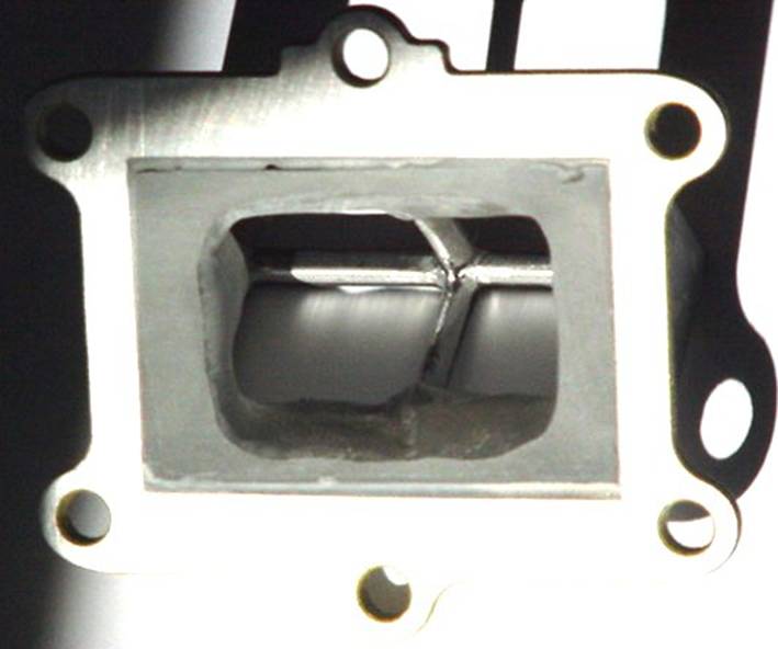

Notice the right left of the stuffer extending down to the tips of the reed petals is a bit
narrower than the left, that is actually the left side of the stuffer you looked at in the picture
above, again Since the air/fuel has to travel a longer distance I wanted to increase the
volume a little more on that side to enhance and equalize flow.

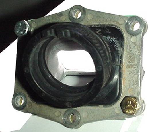

Here is a shot with the manifold installed you can see what I was talking about
With the carburetor being off set to the right and wanting to increase flow to
the left side.
