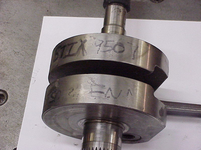

well got the rod kit and cranks in sat mail
Good packing on both
File comment: hoser pack them well
File comment: went with this one it seems to be in better shape on the seal area
MVC-363X.JPG [46.37 KiB]
Downloaded 214 times
MVC-364X.JPG [62.11 KiB]
File comment: add number
MVC-367X.JPG [101.91 KiB]
File comment: marked old pin rotation

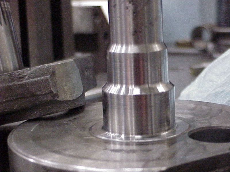

next
MVC-369X.JPG [105.05 KiB]
Downloaded 211 times
File comment: little water damage
rust
File comment: little polishing up seal surfaces
File comment: this is cool they thread together
:) wonder if they will work like this
MVC-373X.JPG [77.7 KiB]

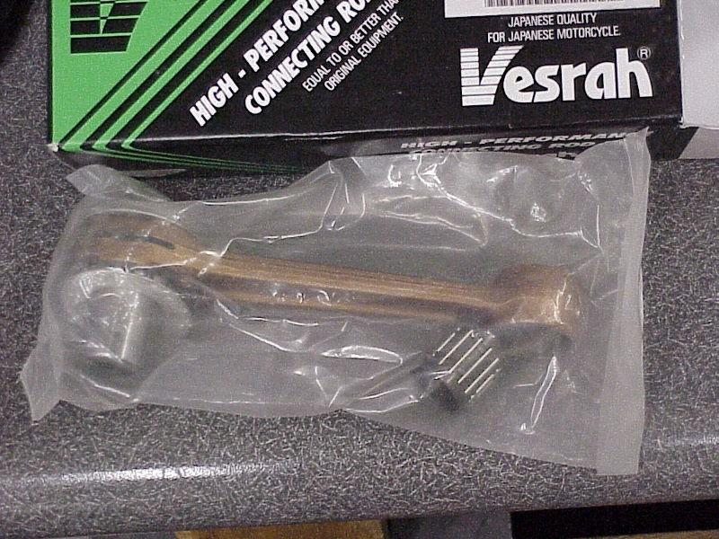

File comment: rod kit looks good
but came with shorter big end pin 56.3mm long
then the standard 59.6 mm long
MVC-377X.JPG [112.78 KiB]
Downloaded 208 times
File comment: Note this kit comes with a short big end pin

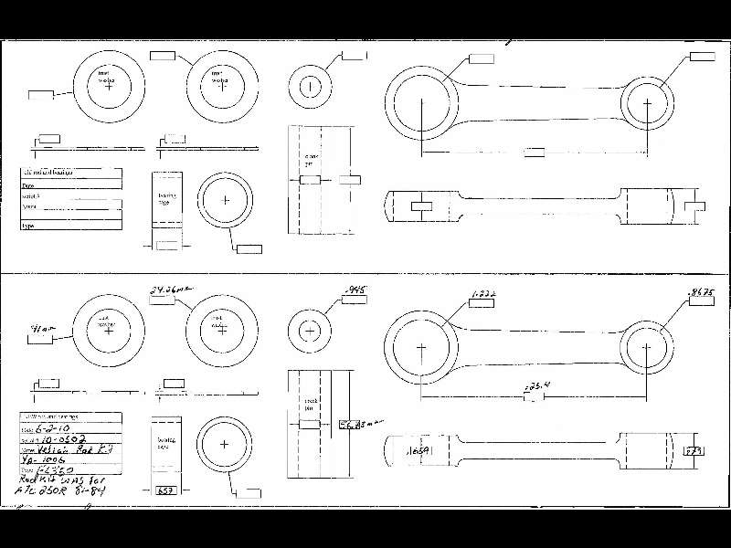

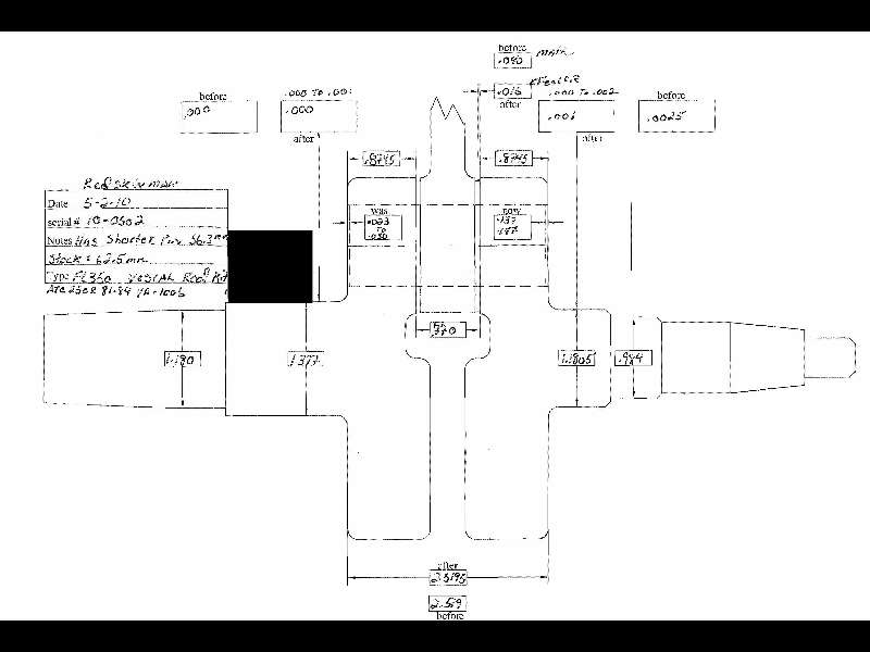

got all done
I posted spec sheets that you can barley read :)
I ship readable with crank and have hard copy for my self for later
will be shipping off to Hoser 5-3 or 5-4
thanks Speedchaser

Looking at your specs from your other post
viewtopic.php?t=7184
the 81-4 atc 250r has the shorter pin length of 56mm, seem like in that post you were wanting to use a cr250 rod kit .. any reason why the ATC kit was used instead ?
PostPosted: Mon May 03, 2010 9:30 am
Posts: 1040
Location: hole above ground
http://www.pilotodyssey.com/PO/viewtopic.php?t=7184
note nobody make a rod kit for the fl350
as i seen with the right parts yet
this is what Honda used
Rod center to center = 125.3 mm
big end pin length 62.56 mm not available any more
stock Honda thrust washers 1.2mm Thick
so you are go to get thicker thrust washer or a shorter pin
THE PRO-X ROD kit for the cr25r 84-01 my come with the longer pin 59.6 mm and the 1.2 mm thick thrust washers
talked to Rocky Mountain http://rockymountainatv.com and they clarified the sizes
So as of right now if you see a rod kit for a fl350 watch what you are getting as noted above
speed

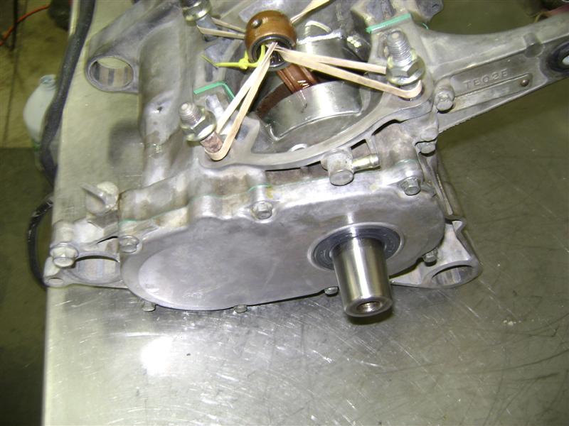

Crankshaft arrived via USPS no shipping damage as usual perfect professional packing by Speedchaser I am saving the box and all the packing materials to send you a few more cranks in the future...
Just took a quick look at it everything looks ok I will look it over good before installing tomorrow.
That is the crank Stix sent that he questioned the rust on the small end of the rod and I was skeptical about the big end I am glad we condemned that rod assembly it would not have lasted very long if run in that condition (more pics later of old rod) and redskinman would have ended up pissed off for sure.
Here is the crank installed in Redskinman's 350 bottom end ready for action, sorry about the crappy pic.

Hello if the crank has been rebuilt it will have the short pin. No body makes the stock Honda lenght pin for the for the fl350
Thanks speed

im just going off what my mechanic/machinist is telling me. an he says should not rebuild with shorter pin which is almst 1/4 inch shorter. could cause premature twisting ect.
im still a newbie to all this
