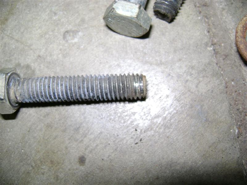

Cylinder after lite hone with a AN-112 Sunnen ridged stone hone not a flex hone or ball hone
The cylinder measures 3.209
The piston measures 3.196
Do the math .013 clearance...

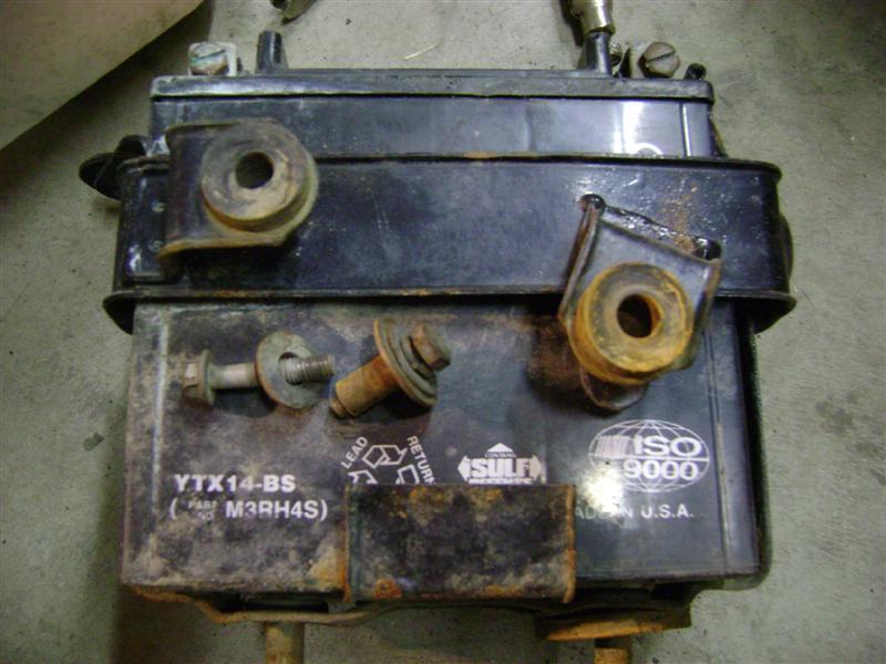

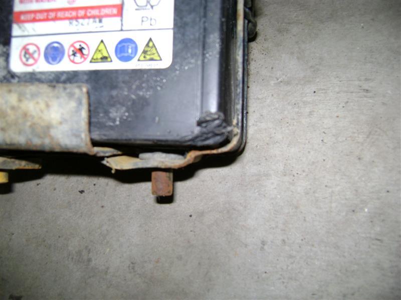

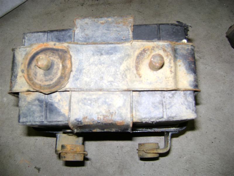

You probably also noticed in the above pic he is missing the plastic battery box that PROTECTS the battery and keeps it TIGHT in the battery box hare will be buying one of these too battery box 31525-VM0-000 Tray, Battery 7.55
Why not protect the 60.00 battery?
Humans are a funny breed, sometimes, more often than NOT we create more problems than we solve, their is no disputing that Honda's reliability is LEGENDARY, why for a FEW dollars REMOVE that Honda LEGENDARY RELIABILITY ?
WHY plan a trip, load up, drive to the ride area without that reliability?

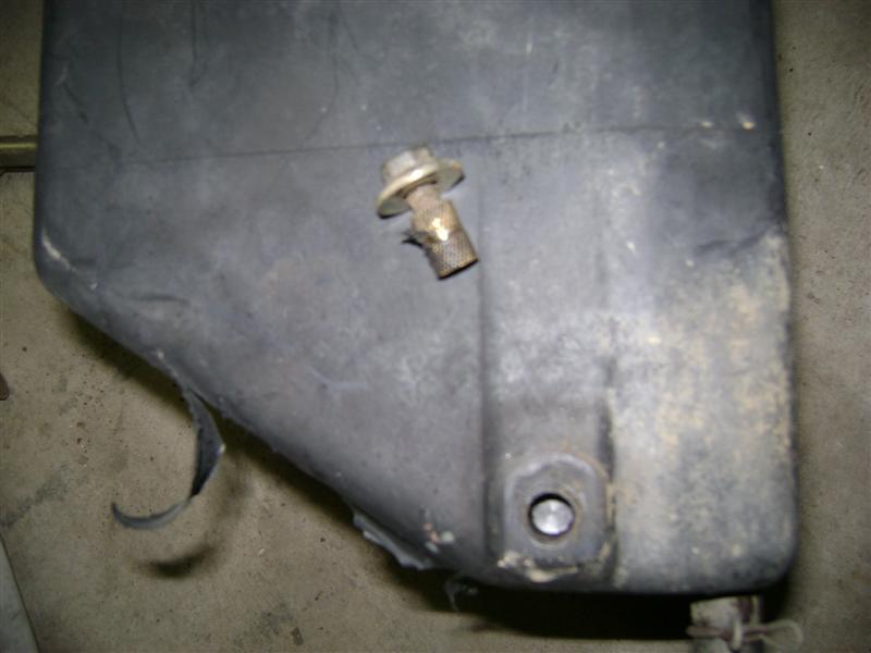

Next is to remove the gas tank, you guessed it the tank was installed with all the wrong bolts, the replacement bolts are too short and only catch a few threads.
TWO 96500-08014-07 Bolt, Flange 0.88 each
TWO 96500-08030-07 Bolt, Flange 0.88 each
TWO 96300-08045-07 Bolt, Flange 2.70 each
Their is only 5 bolts required but the pic is not clear what bolts are what so I ordered the one extra bolt (.88) just to ensure I get the correct bolts, no doubt this extra bolt can be used elsewhere on this Pilot, their is plenty of other OEM bolts missing....

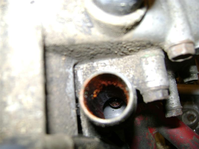

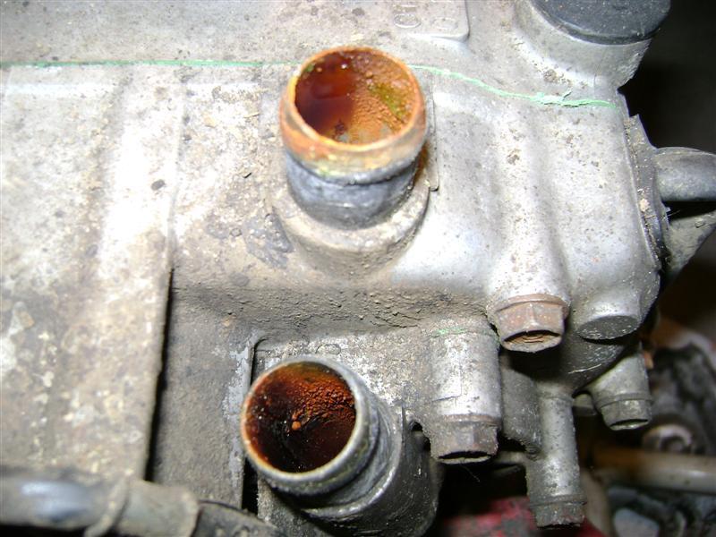

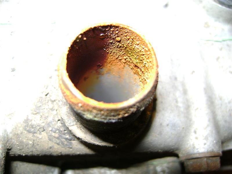

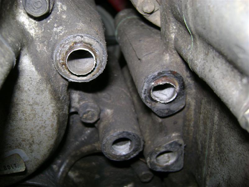

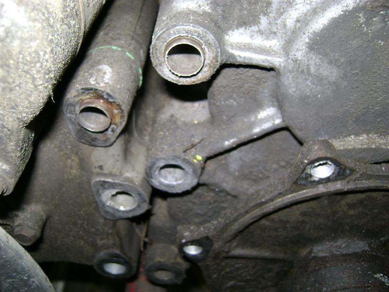

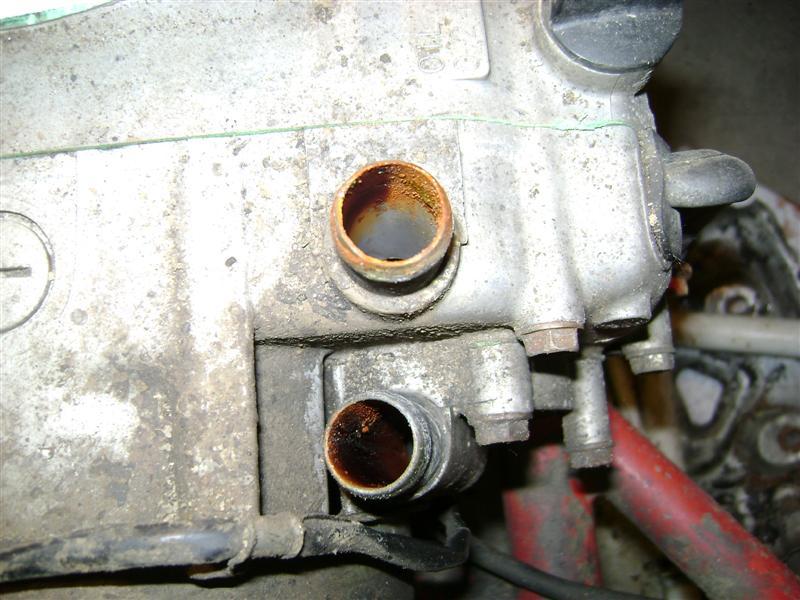

Not sure why their is rust inside this cooling system their is nothing inside the system that CAN RUST.
Maintaining the Pilot cooling system is SO SIMPLE all you have to do is buy a gallon of quality GREEN type antifreeze and a gallon of distilled water then mix it 50/50, then remove the Pilot seat and drain your cooling system and refill with the new once a year, don't forget to remove the over flow bottle, drain, rinse and refill too, if you do this you will NEVER have a cooling system problem like rust or dirt inside, you also should carry extra mixed coolant in your spare tools box so if your on a ride trip and for some strange reason need some you have it...

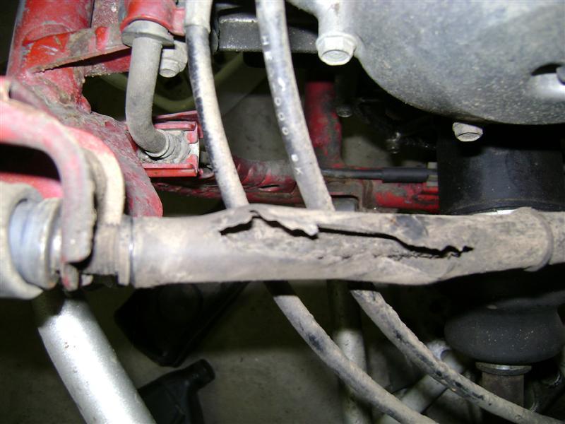

Remove the recoil from the frame is easy the plastic nut that holds it on is MISSING their is a huge cut in the rubber hose, how you think that happen, I am no detective but ASSume that at one time the recoil end fell out of the frame mount and dropped down and was rubbing on the axle and wore a hole in the hose that protects the recoil rope ?
Add the nut to your list Hare 28464-950-003 Nut 1.48
The tube is 10 bux I think we can salvage the old one by sliding a larger hose over the old one to serve as a dust cover?
The part number is if you decide to get one 95005-12335-30 Tube 9.51

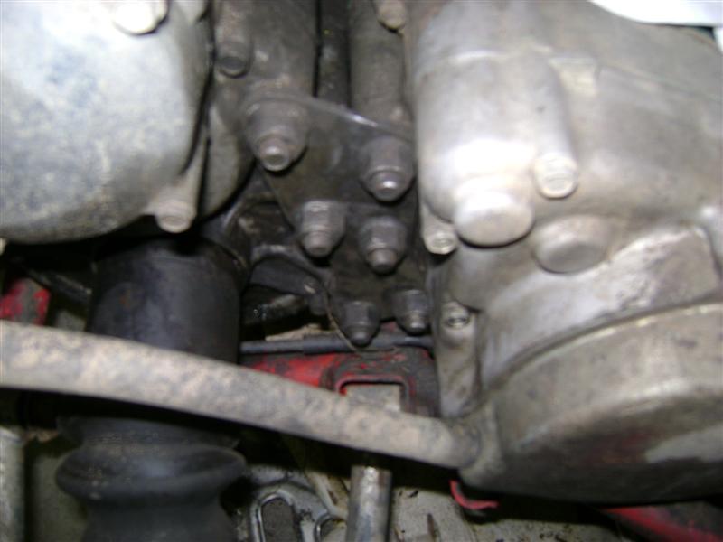

Engine bolts are all installed and tight, once remove can see a few of the dowels are missing and damaged.
FOUR 94301-14200 Pin A, Dowel 0.98 each

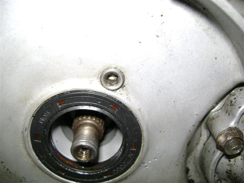

Engine out and on the bench, recoil removed, all kinds of oil here, seal was leaking..

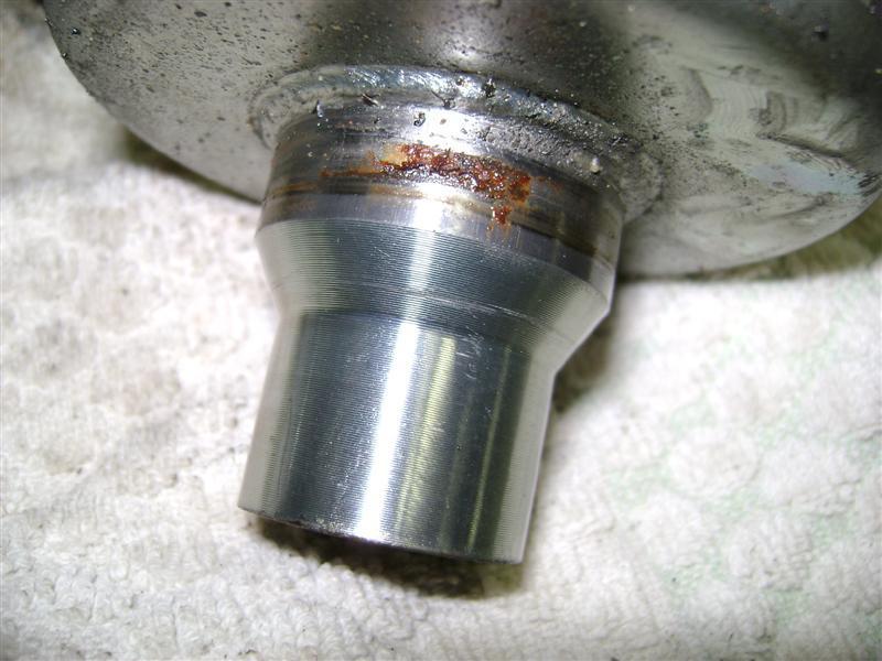

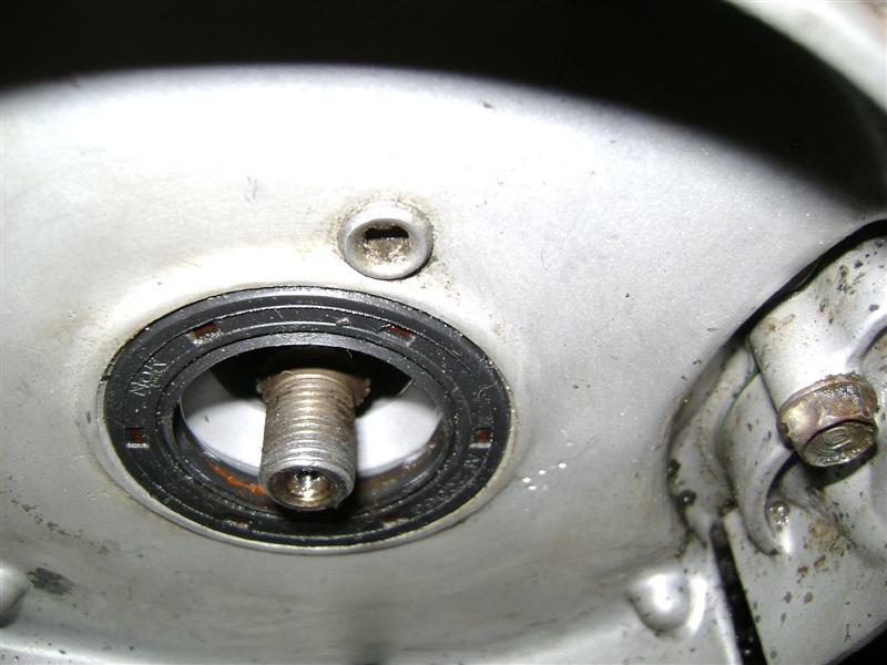

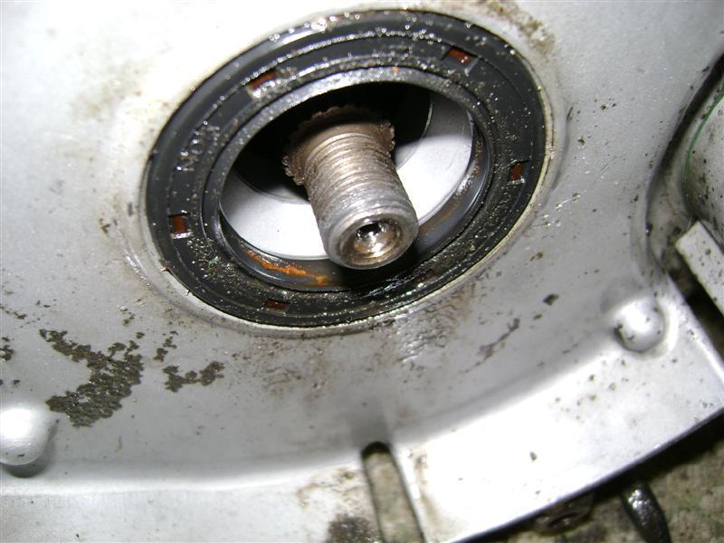

Recoil basket removed see the rust in the lips of the seal?
PostPosted: Sun Dec 28, 2008 6:43 pm
See the rust on the recoil basket seal surface area?

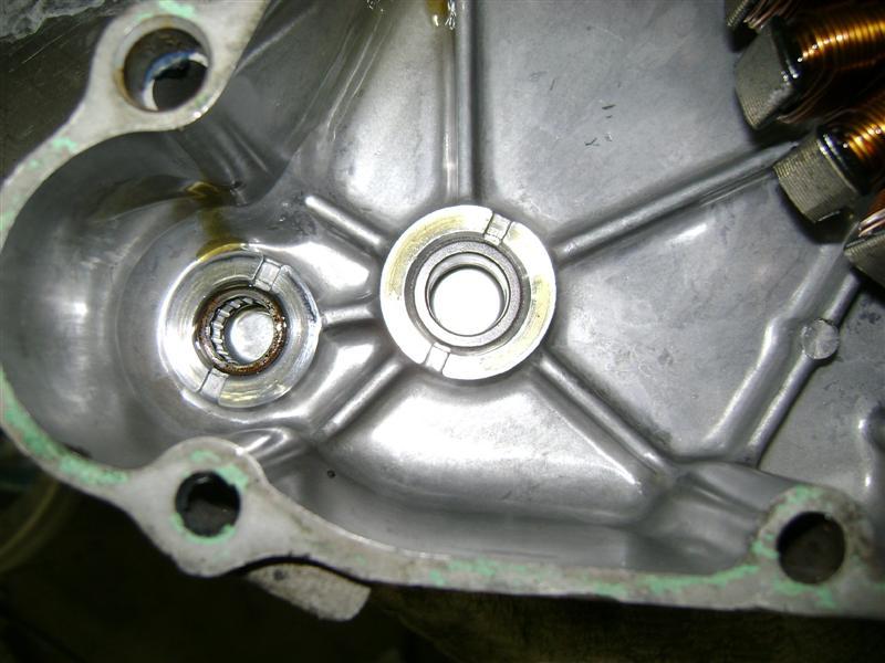

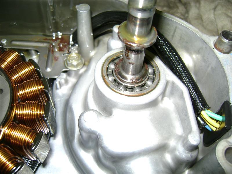

PostPosted: Sun Dec 28, 2008 6:46 pm

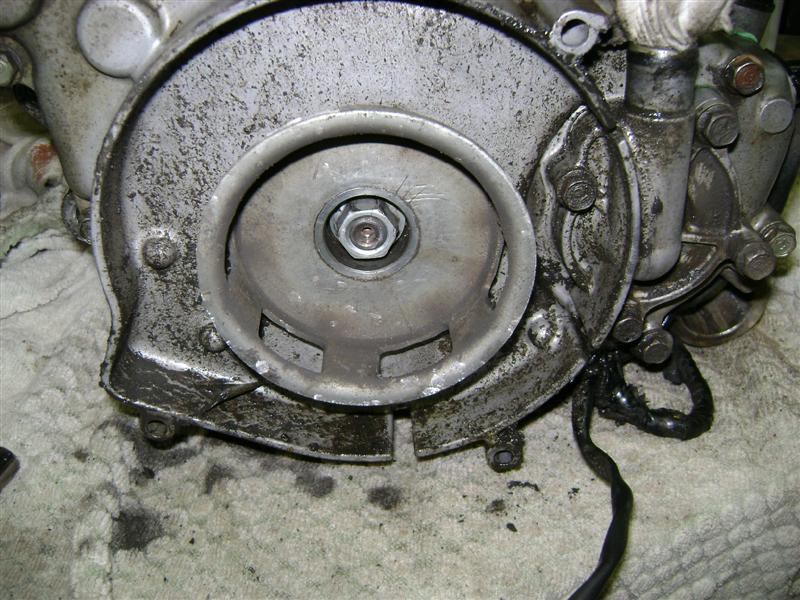

Side cover removed, little rust on the balancer gears, water pump shaft, behind flywheel, don't see any real damage the rust will be removed and the parts reused.

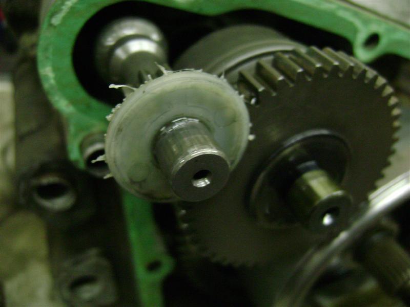

PostPosted: Sun Dec 28, 2008 6:47 pm
Looks like a home made spacer washer made out of plastic on the primary starter gear..
90414-GE0-000 Washer 1.59

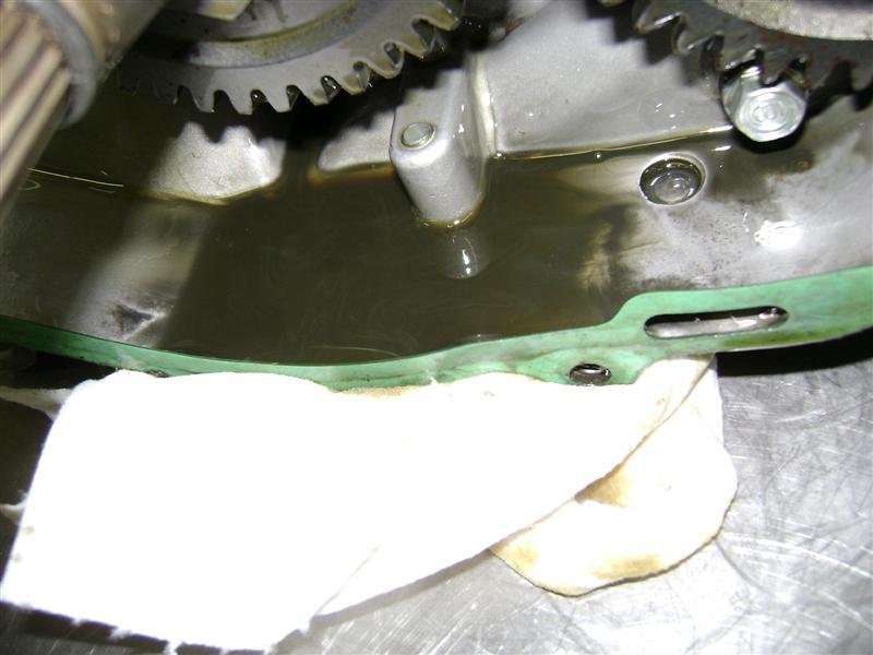

Oil in balancer case nasty looking..

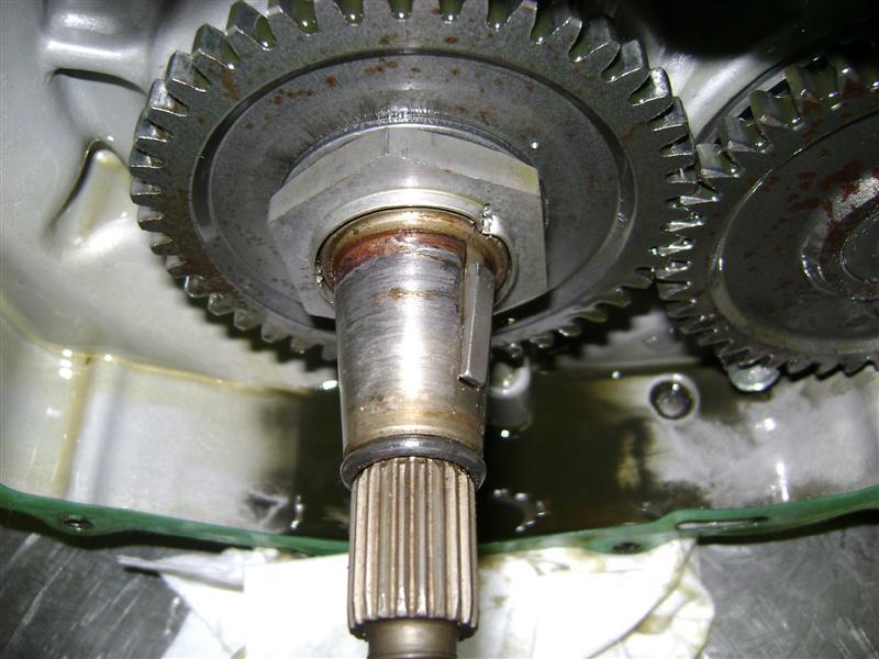

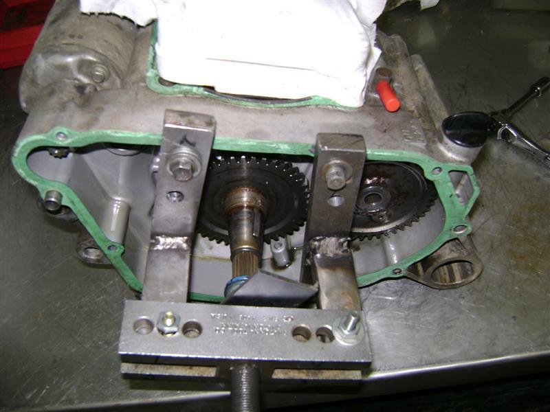

Cases ready to split soon as I get clutch puller and pull clutch I can remove the other bolts that hold crank cases together and split the cases... Send puller ASAP

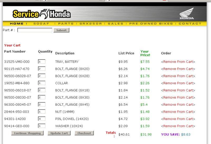

Anybody keeping track of parts list to UN Skillbilly this Pilot and restore the Honda LEGENDARY reliably?
Last time I went to the bar I spent more than that on my first round....

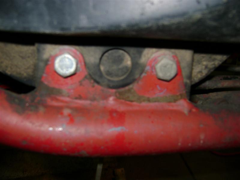

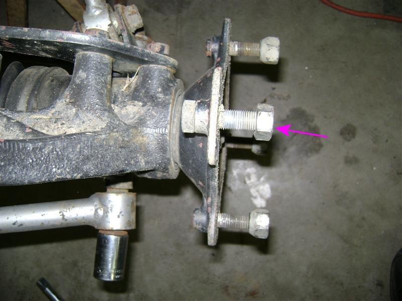

Whilst waiting on clutch puller I tore into the rear end, on Hare's list was new trans seals, fix lower links, damaged frame...
First is to remove the whole suspension system, first thing I notice is all the lug nuts on the rear tires are NOT Honda, assume someone lost the Honda nuts then just found something to fit as replacement, one stud was replaced with a bolt and nut.
The bearings on the rear right side are lose and need replaced...
