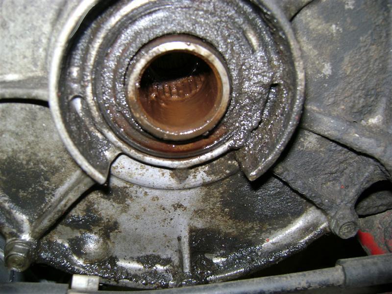

Recoil basket removed see the rust in the lips of the seal?

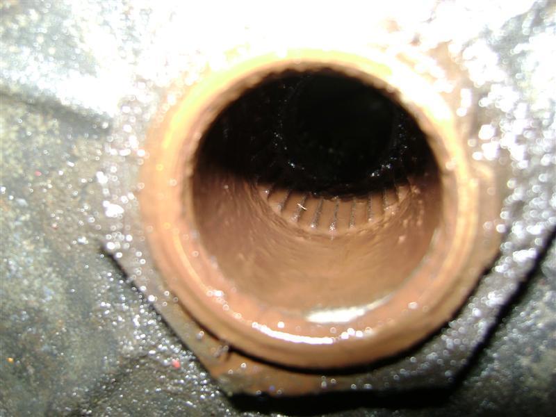

See the rust on the recoil basket seal surface area?

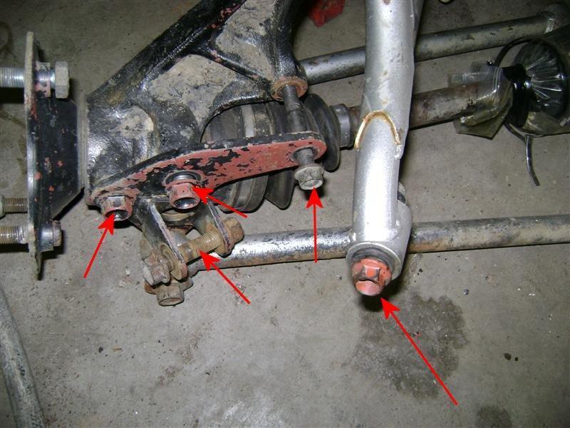

Whilst waiting on clutch puller I tore into the rear end, on Hare's list was new trans seals, fix lower links, damaged frame...
First is to remove the whole suspension system, first thing I notice is all the lug nuts on the rear tires are NOT Honda, assume someone lost the Honda nuts then just found something to fit as replacement, one stud was replaced with a bolt and nut.
The bearings on the rear right side are lose and need replaced...

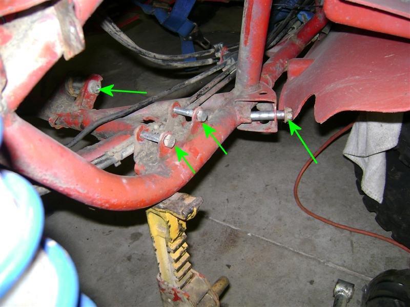

Lower link long bolt (blue) is bent on both sides, cant get them out they are rusted in.

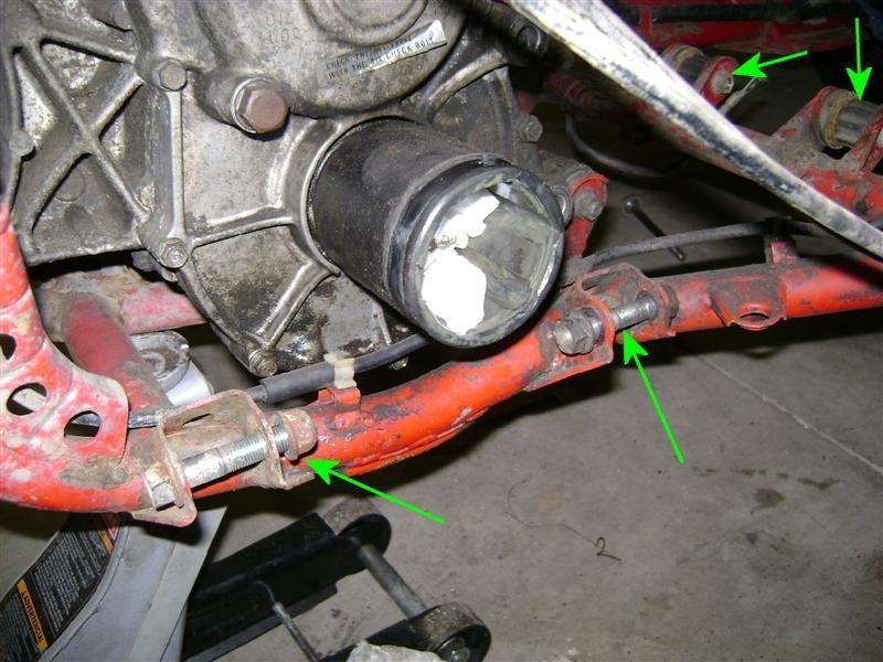

Here is a tip for all you dumbasses that keep losing all the stock bolts then replace them with shit that don't fit right, SOON AS YOU TAKE SOMETHING APART put the bolts back where they came from, guess what, when you go to reassemble the bolts will be their!
It only takes seconds!

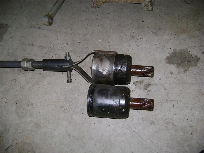

PostPosted: Sat Jan 03, 2009 5:30 pm
The hoser CV puller was able to pull the stubs out but they fought me every inch of the way...
More info on the puller http://pilotodyssey.com/PO/viewtopic.php?t=454

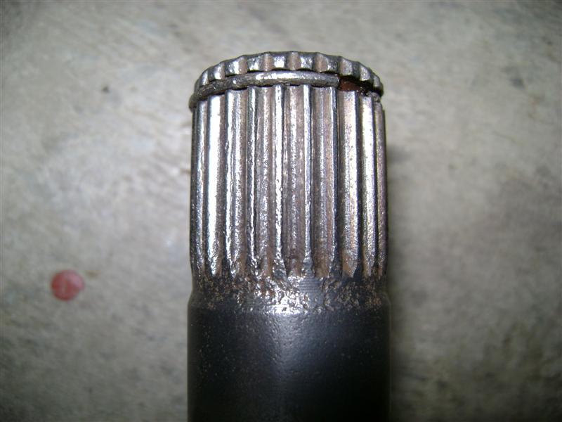

PostPosted: Sat Jan 03, 2009 5:31 pm
Final shaft

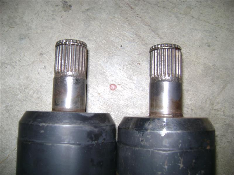

PostPosted: Sat Jan 03, 2009 5:37 pm

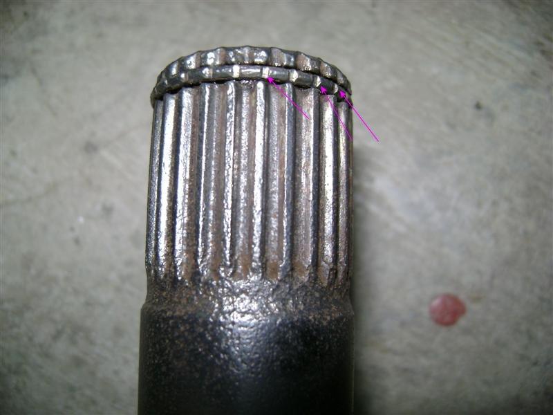

Axle stubs cleaned up...
What was it you wanted me to do here use the NEW stubs and final shaft you sent with the parts, your spare trans needs them...
I havent cleaned up the final shaft yet to take a closer look but I will.
What I would do if it was mine, clean everything up, use a stainless tooth brush to clean splines in final shaft, wash really good, install new trans seals and refill trans, start Engine put into gear and run it 5 min to ensure seals don't leak, reinstall axle stubs with JB Weld or equivalent on the splines, continue to use current stub shafts and final shaft until you need to change the seals again or split the cases.
