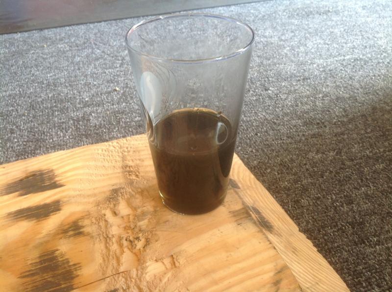

I've been using the stuff in my pilots since 2004. It usually looks the same coming out as when I put it in. Last fall when I changed the oil before storage I noticed significant discoloration. A dark grey. I just thought maybe I went too long between changes. I rode about 6 hours this past week in the dunes and decided to change it just to see and here is what it looked like. Never seen this. I've not noticed any difference in the clutch performance so not sure whats going on.
The stuff in the tube is the new going in and it usually looks that good when I drain it. I did some research on wet clutch compatability and didn't see anything where this stuff was an issue. Thanks
Do you think water got into the trans?
PostPosted: Fri May 09, 2014 2:14 pm
If it was foamy, my first thought would be water in the oil, but its not foamy and you are riding in the dunes. Whats left to discolor it like that? Doesn't it have to be wear in the tranny?. I would CSI the tranny if it was mine. The discolored oil is talking to you!

Be prepared...you might get the "why weren't you just running Honda tranny fluid per the spec"
With that said, my first thought was water as well, maybe from a wash down? but if you say "no" then the next step would be a teardown to be safe
Did you run a magnet through the oil?
I'm not sure what it would take inside to discolor a whole quart like that...maybe they changed the detergent formulation somewhere along the line...that might be a reach

Take a mixed portion of the material and put it through a piece of paper towel to try and see what the discoloration is.
Possibly clutch disk wear?

Find a white plastic oil bottle pour all the oil in it let it set a few weeks carefully pour off all the oil when their is about 1/4" oil left you can cut the top off the bottle and see whats left behind, if your drain pan was not perfectly clean before you drained your wasting your time skip this step.
I been using the Mobil 1 15-50 for as long as I can remember in my Pilot I doubt its a oil problem, also been running in my 1999 400EX since new.
I would look at the clutches that's what will get hot enough where it will discolor oil if the torque clutch assembly looks good then you have two options, one switch oil see if it happens with the oil or take the rest of the trans apart and see what parts are discolored has to be a bearing some place that is getting hot, or a bearing spinning on the shaft or in the cases, takes some heat to discolor oil.
Any metallic hue to the oil? I always see a slight metallic hue in mine but ever so slight, has been that way since I bought the Pilot back in 1995.

I didn't feel anything out of the ordinary. I've used this stuff enough to know it shouldn't look like this. I think I'm going to bring GN4 and the mobil this trip and change it at the end of each day and see what it looks like. I guess I'll end up having to get into the clutch pack. one more thing above my abilities. Maybe good timing with the new packs Adnoh has come up with if it needs it.

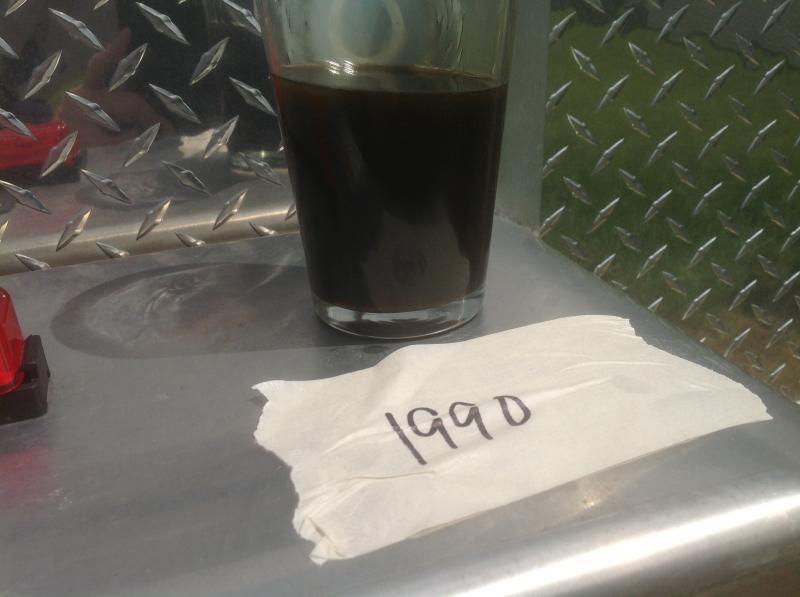

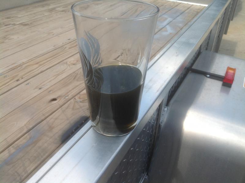

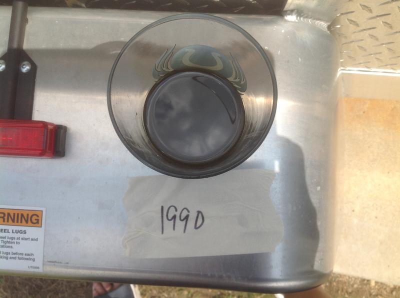

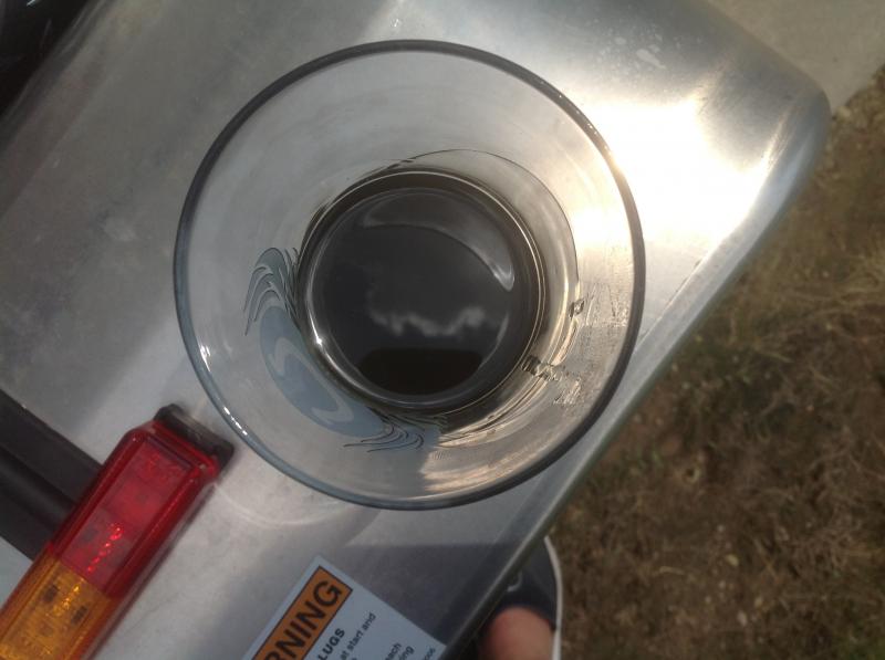

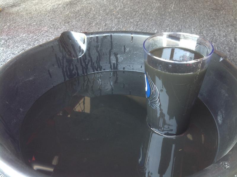

We just finished up a 4 day trip at Little Sahara OK. I put about 6 hours on the 89, and 6 on the 90 on fresh 15w50. They both look damn near identical, little less grey/green when I smeared some on my fingers as opposed to looking at the stuff in the glass. I'm beginning to think the Mobil 1 has changed formula's or something. First 3 pics are the 89.
Is anyone else running this and done a recent change and what does it look like?
