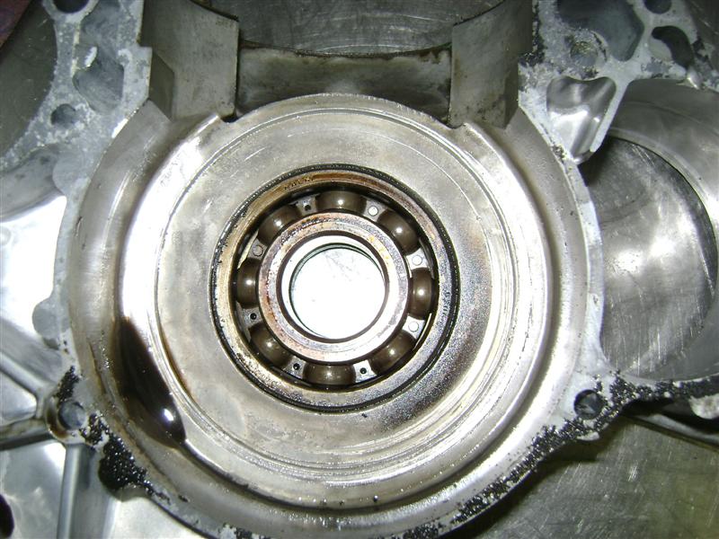

Some pics of the cases split, can anybody see another problem in this pic that has nothing to do with the crank seal being bad?

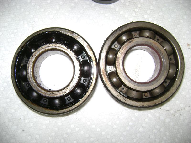

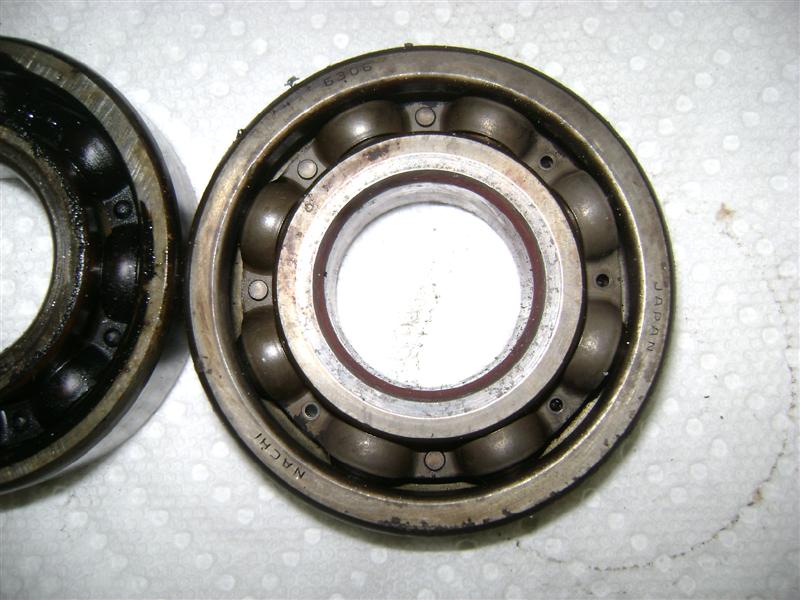

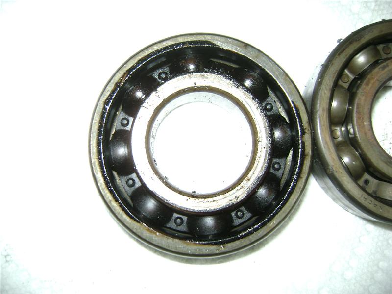

Bearings out bearing on the right is clutch side left is mag side.

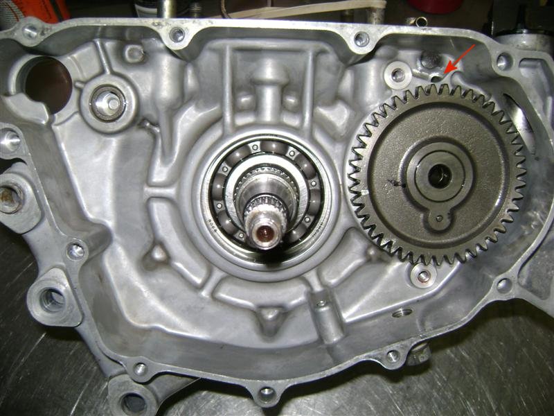

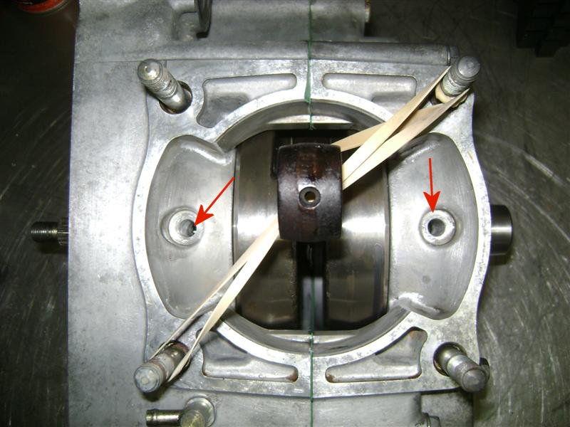

The crank cases were clean checked, I did my usual modifications to the oil passages to provide better flow to the crank bearings and to the balancer bearings in the balancer case.
Oiling problem?
PostPosted: Fri Jan 13, 2012 8:53 pm
bearing over heat?

Looked like something rubbing the case maybe. Bottum left.

It looks like the retainer that holds the balls in is starting to come loose. Didnt the group see a number of failures a few year back where the entire retainer failed

Now that you mention it I see what your talking bout. Didnt notice it before.
Good eye, the bearing cage is missing 4 of the rivets.

PostPosted: Tue Jan 17, 2012 6:12 pm
Yeah this bearing was dangerously close to failure like we have seen many times before on the Pilot crank bearings, I have been a victim of this a few times myself.
First the heads falls off the rivets then the bearing separator is no longer keeping the balls properly spaced out then nasty things starts to happen.

Is it the right or left Honda bearing that seems to loose the rivits?
PostPosted: Thu Jan 19, 2012 10:08 am
The right side bearing is the S6306 - the S indicates special - part # 91033-HE0-005. it is special because it has a ID of 32mm. This is the one that we are buying the Nissan bearing for.
A standard 6306 bearing has a ID of 30mm.
The bearing in the picture with the missing rivets has 6306 on it so I believe it is the standard bearing - the one that goes on the left of the crank part # 91032-HE0-000.
