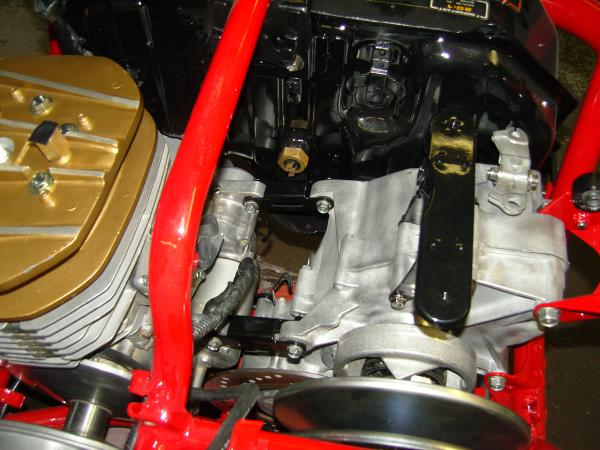

Hello everyone, here are some pics of where I am at as of today.
Going slow but smooth, getting very close to having to do the wiring harness.

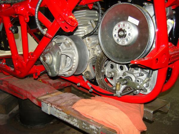

File comment: Recoil starter, took it apart and cleaned + lubricated it.

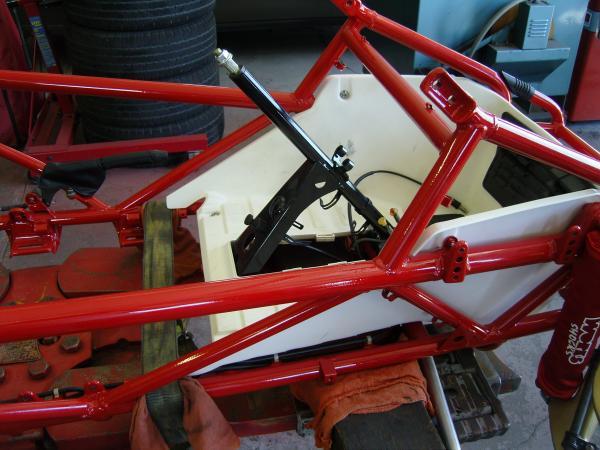

File comment: Steering column has all new bushings + new steering shaft.
File comment: For some reason I did not take a picture of this area before disassembly, had I lot of fun routing the cables. If this looks wrong please let me know.

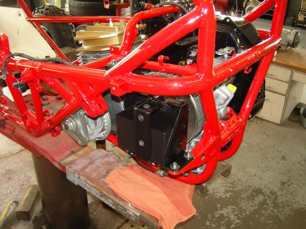

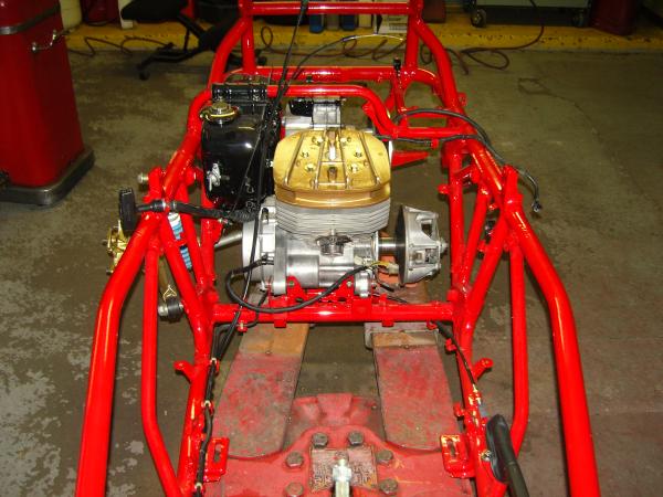

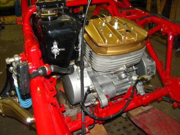

File comment: Finally the motor (( Internal Combustion Engine ? )) is in, tight fit. I will have to touch up a couple of spots with paint.

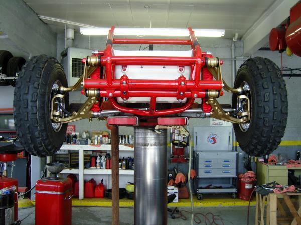

Good day to all, hopefully I will have a rolling chassis by tonight putting the left rear suspension together today.
I think I have just about put off the wiring harness as long as I can, should be starting on it tomorrow I am adapting an 89 pilot wire harness.
Starting to look like a machine.

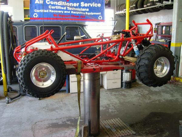

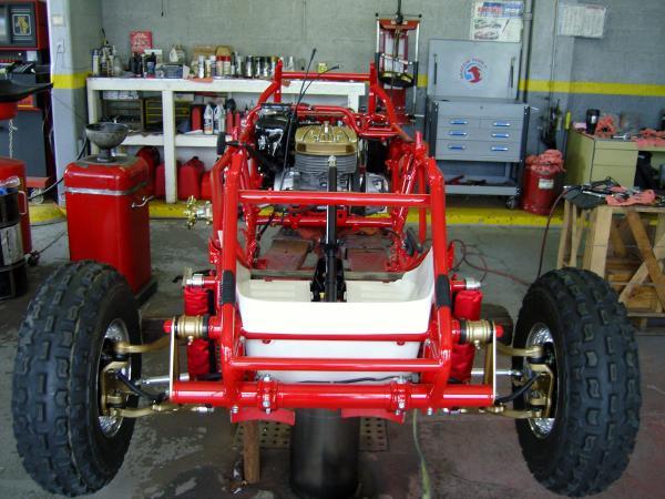

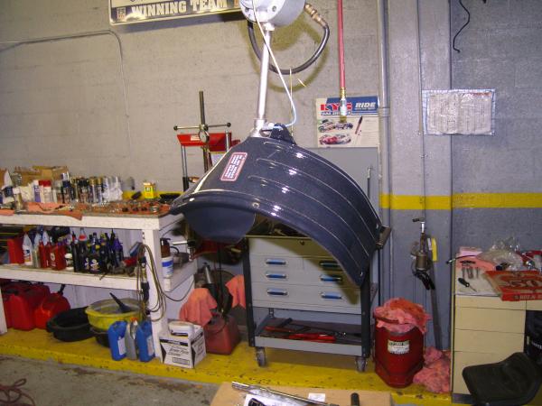

 Post subject: FL350 Restore
PostPosted: Tue Aug 04, 2009 9:04 pm
Posts: 1090
Hello and good evening to everyone.
Here are some pics of where I got to on Saturday, my wife kept me home on Sunday so a rolling chasis is as far as I have gotten.

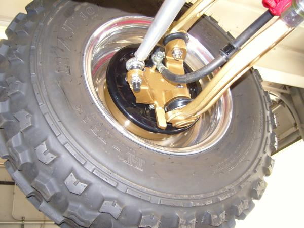

File comment: Learned a lesson on the radius arm heims joints, had them all greased and ready to go but when I tightened the nut down the joint kept turning to the side. Ended up taking the boots back off, cleaning all the grease back out and reinstalling them dry.
File comment: Torqued the nuts down with no boots or grease so I could hold the joint centered, then installed the boots and grease.

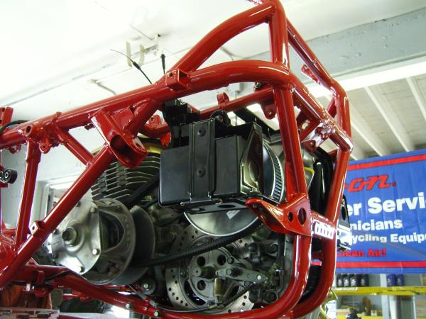

File comment: Belt cover freshly painted.

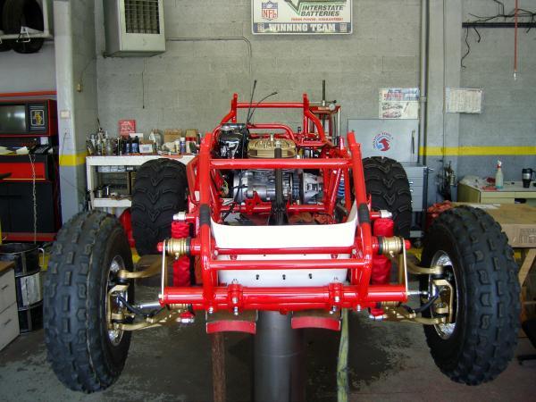

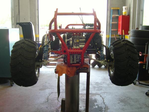

PostPosted: Tue Aug 04, 2009 9:13 pm
Posts: 1090
More pics.

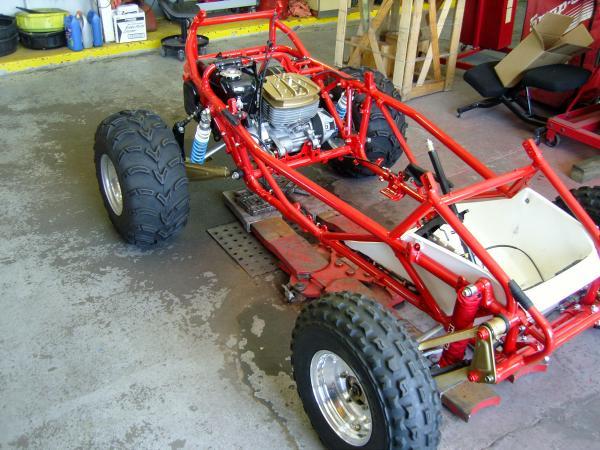

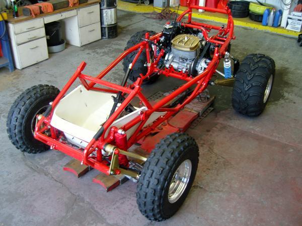

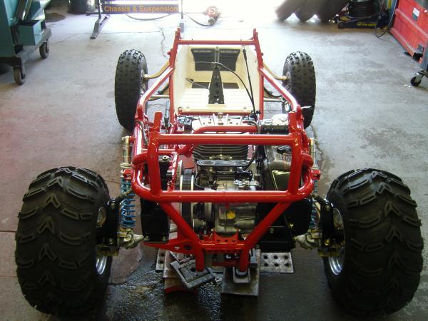

File comment: It rolls it rolls.
PostPosted: Tue Aug 04, 2009 9:17 pm
Posts: 1090
Last set for now. I will not be able to get back to work on it until weekend after next.
