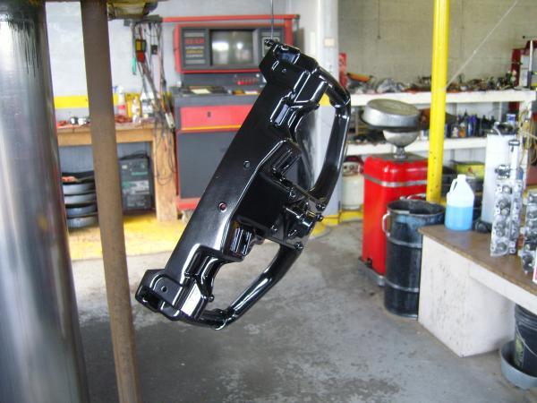

Hello to all, I have been working alot lately so work on the odyssey has been slow.
Here are pics of where I am at as of this last Sunday.
File comment: Pilot steering wheel just painted.

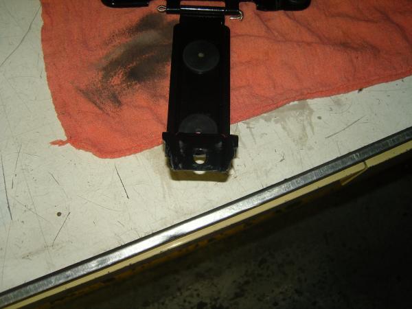

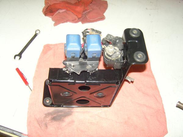

File comment: Ok I know that this will all seem simple but I went crazy figuring out where the best place was for the pilot fuse boxes.
This is a motor (( Internal Combustion Engine ? ))/ trans. bracket cut in half and bent in a U to mount to where the pilot starter relay used to mount.

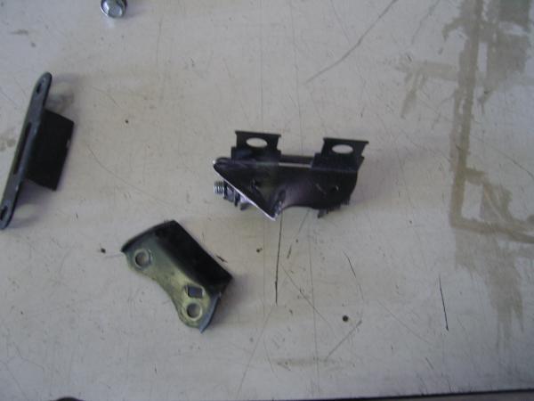

File comment: Cut the mounting point off of the pilot fuse box bracket but left enough for the fuse box hold down to be put on later.

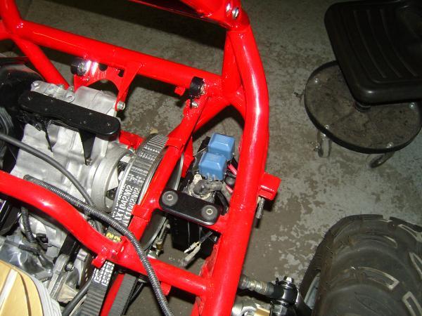

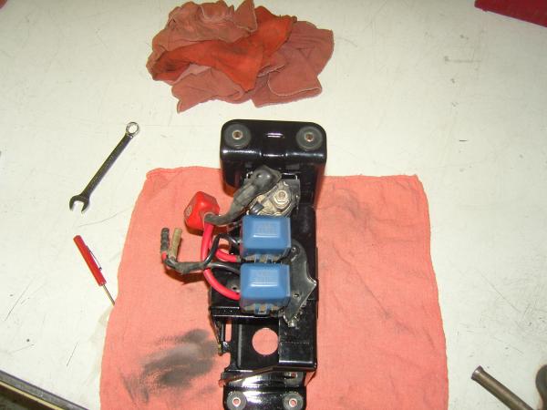

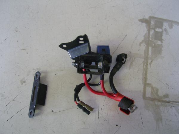

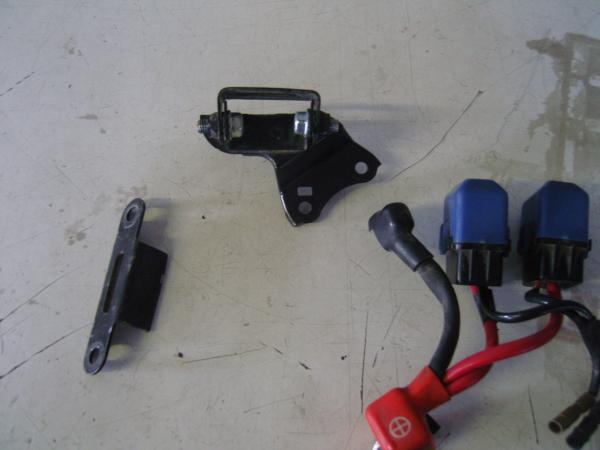

File comment: Had to cut down the old odyssey starter relay mount, needed the pilot relay mount to set back all the way against the battery box.

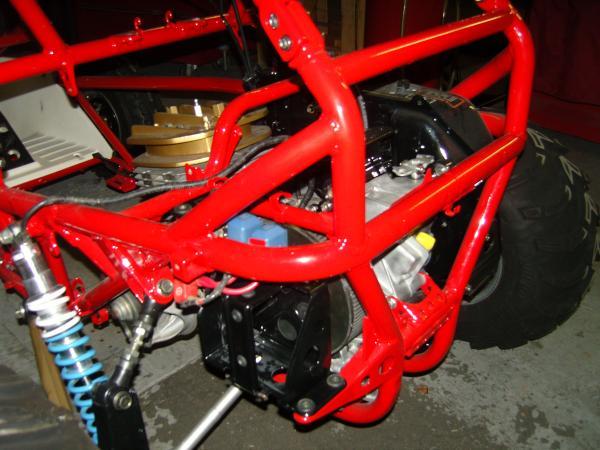

File comment: Fuse box bracket mounted.

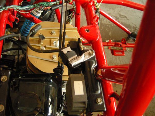

File comment: Fuse boxes mounted.

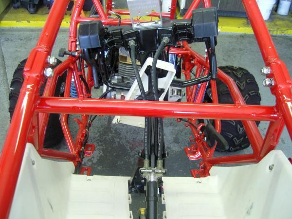

File comment: Only took me half a day to figure out this spot.

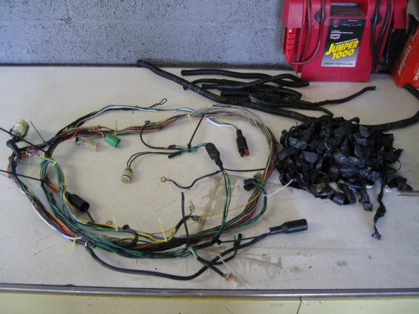

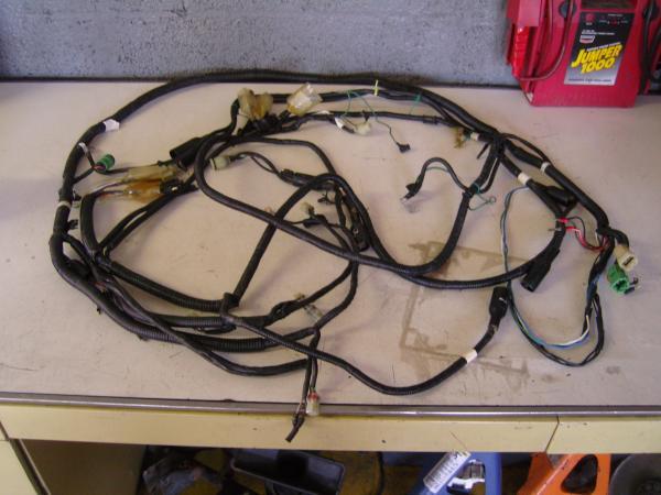

File comment: Many wires will have to be moved and added. Stripped down both harnesses, no cutting all unwrapped.
Pilot harness.
File comment: Odyssey harness pieces I cut out to use.
File comment: What's left of the Odyssey Harness.
File comment: Pilot Harness laid out.

File comment: Check/Timer Unit, another fun thing to figure out where to put it.

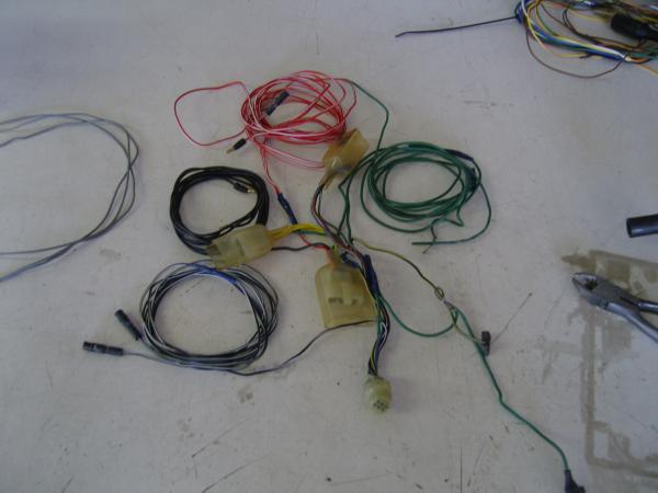

File comment: Odyssey wire harness parts to use.
SNC10183.JPG [60.9 KiB]
Downloaded 388 times

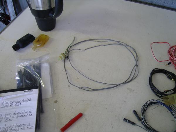

On the pilot harness I will use the old coil ground for my fuel sensor ground, the odyssey harness parts cut out have the coil ground on them.
I cut out the pilot regulator plug and will extend the wires to tap in to the odyssey regulator harness parts.
Green to green ( ground ), black to black ( ignition power ), Red to red and white ( battery power ).
When I cut the odyssey harness parts out that I needed I was careful to leave the CDI (Capacitor Discharge Ignition), regulator, coil, alternator, pulse generator and grounds part of the harness as complete as possible.
I am going to cut out and use the old pilot black and yellow coil wire for the fuel senor, I will splice it in to the gray and black wire at the timer unit.

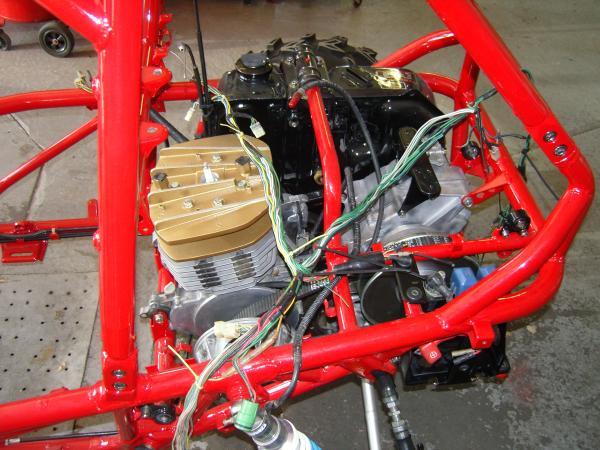

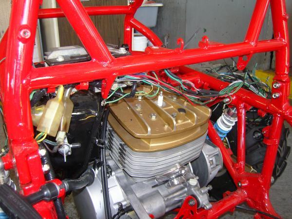

 Post subject: FL350 wiring
PostPosted: Sat Sep 19, 2009 10:21 pm
Posts: 1090
Hello to all, this is where I have gotten to as of last weekend.
File comment: Odyssey harness parts I cut out to reuse.
SNC10166.JPG [38.09 KiB]
Downloaded 309 times
PostPosted: Sat Sep 19, 2009 10:32 pm
Posts: 1090
I did not have exact wire colors in some spots but the gauge is the same.
File comment: Extending check unit wires + added fuel sensor wire, spliced in to gray and black wire.
File comment: Wire's spliced in.
PostPosted: Sat Sep 19, 2009 10:53 pm
Posts: 1090

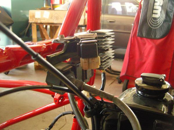

Regulator, alternator, pulse generator, CDI (Capacitor Discharge Ignition), coil, check unit, fuel sensor, grounds and tail light all extended and spliced in.
The original odyssey wire harness has a ground that bolts to the roll cage at the top right air dam mount bolt, I left that one and added a second one to the left top air dam mount as well.
I left the odyssey black and white wire to the CDI (Capacitor Discharge Ignition) fully intact and have ran it along the whole pilot harness to hook up to the odyssey ignition switch. The odyssey CDI (Capacitor Discharge Ignition) is grounded thru this wire to kill the motor (( Internal Combustion Engine ? )).
The pilot harness, same black and white wire also goes to the CDI (Capacitor Discharge Ignition) on the pilot but it is powered not grounded. I was going to use this wire to power my water pump but it is not heavy enough gauge, I have just pulled it out of the harness but not cut it at this point. If I can not figure out something to use it for it will be removed.

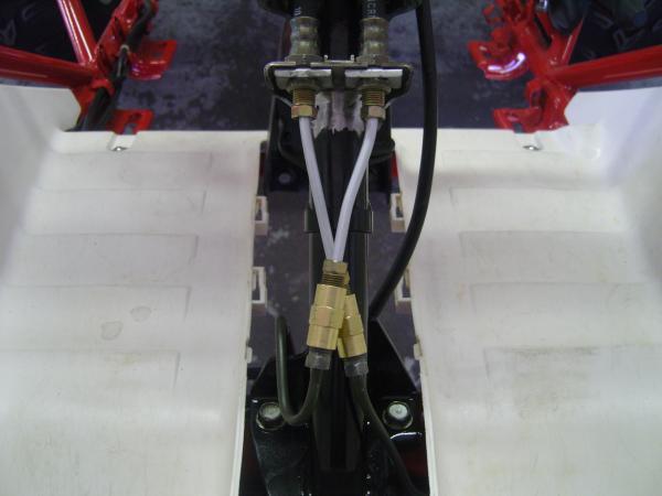

 Post subject: Brake lines
PostPosted: Wed Sep 30, 2009 1:37 am
Posts: 1090
On the odyssey the rear brake line is on the right side of the steering column and the front is on the left, the pilot is the opposite.
I could either cross the hoses off of the steering wheel or cross the brake lines, crossing the brake hoses is easier but I chose to cross the lines. I think it is better.
File comment: Hoses crossed.
SNC10176.JPG [39.85 KiB]
Downloaded 239 times
File comment: Lines crossed, this is the way I am going.

 Post subject: brake lines
PostPosted: Wed Sep 30, 2009 6:25 pm
Posts: 1090
They are 3/16 line with 10mm by 1.0 fittings, I had to buy long lines and cut them down + reflare.
I will get the part # for the fittings, I had fun tracking those down.
All metric 10mm by 1.0 thread.
