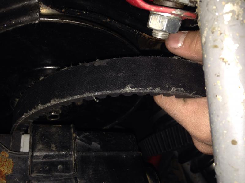

PostPosted: Thu Feb 27, 2014 6:21 pm
Do you have a groove worn on your drive clutch faces?
As you know he drive is apart when no spinning. and it looks like the belt is getting worn at the outer edge - so that leads ne to believe the drive clutch faces have a groove worn in them grabbing the outer edge as the clutch spins together and then runs through the groove.
Didn't you have a chirping issue with you clutches?
put a ruler on edge against the drive face and see if you have a worn groove.
PostPosted: Thu Feb 27, 2014 6:33 pm
Posts: 491
Location: Columbiana, Ohio
YESS!!! When ever I gun it it makes a weird noise or chirp

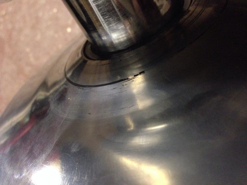

Here might be the problem
Hmmm...I've noticed that mine makes a weird squeal or maybe it could be called a "chirp" not when you gun it, but when it is returning to idle speed.
This is my first Pilot and the first vehicle I've ever owned with a CVT, so I have no idea what to look for when I hear something I think sounds weird. It's a whole new monster to me.
PostPosted: Fri Feb 28, 2014 1:09 am
Posts: 835
Location: corona
YUP you need a new clutch, Is that a powerblock?
